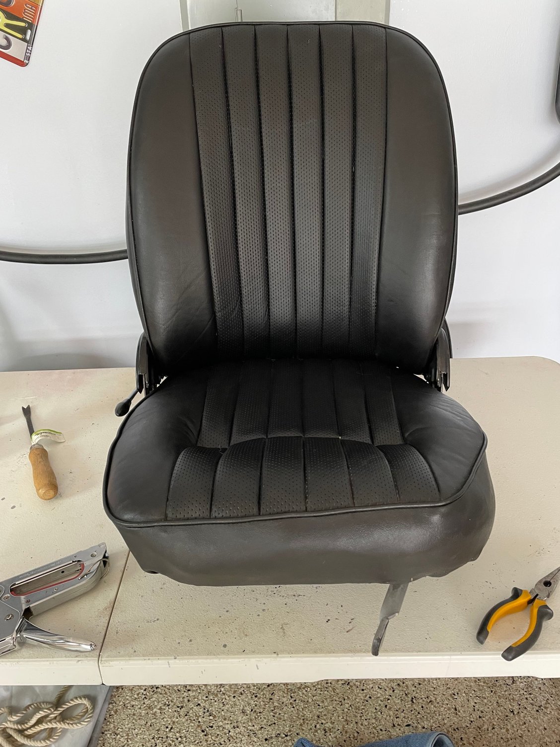

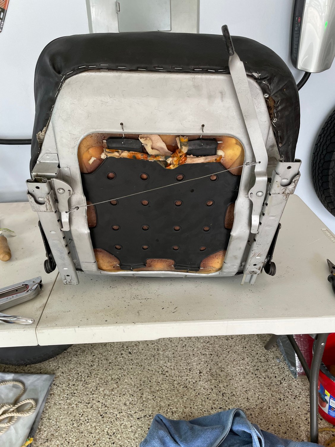

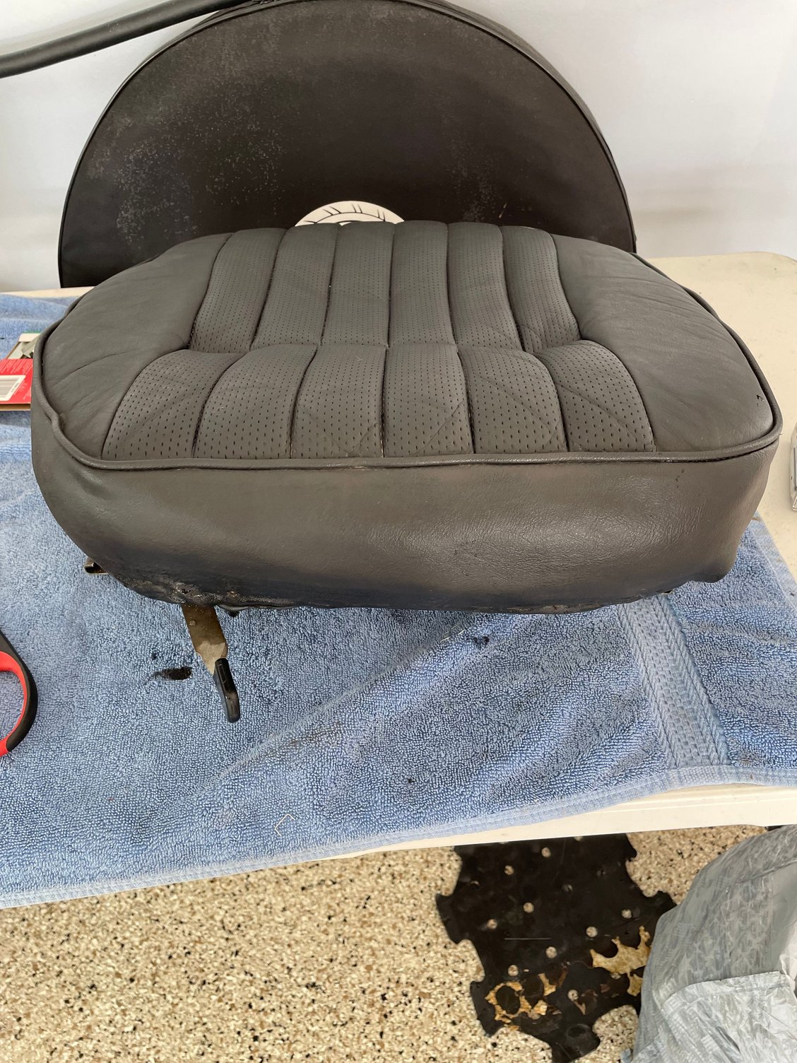

I found replacing the diaphragms to be the most challenging part. I inherited the replacement foam with the car, but I purchased diaphragms off eBay that matched the old ones in size, though they may not have been original. To secure them requires significant force to stretch them fore and aft to engage the attachment hooks. It took two people to hold the seat in place while I levered the hooks into the retaining holes. My predecessor employed fabric ties attached to the underside of the seat cover, pulled through the foam. This seemed superior to a recommendation to use glue between the cover and foam to ensure a contoured, tailored fit.

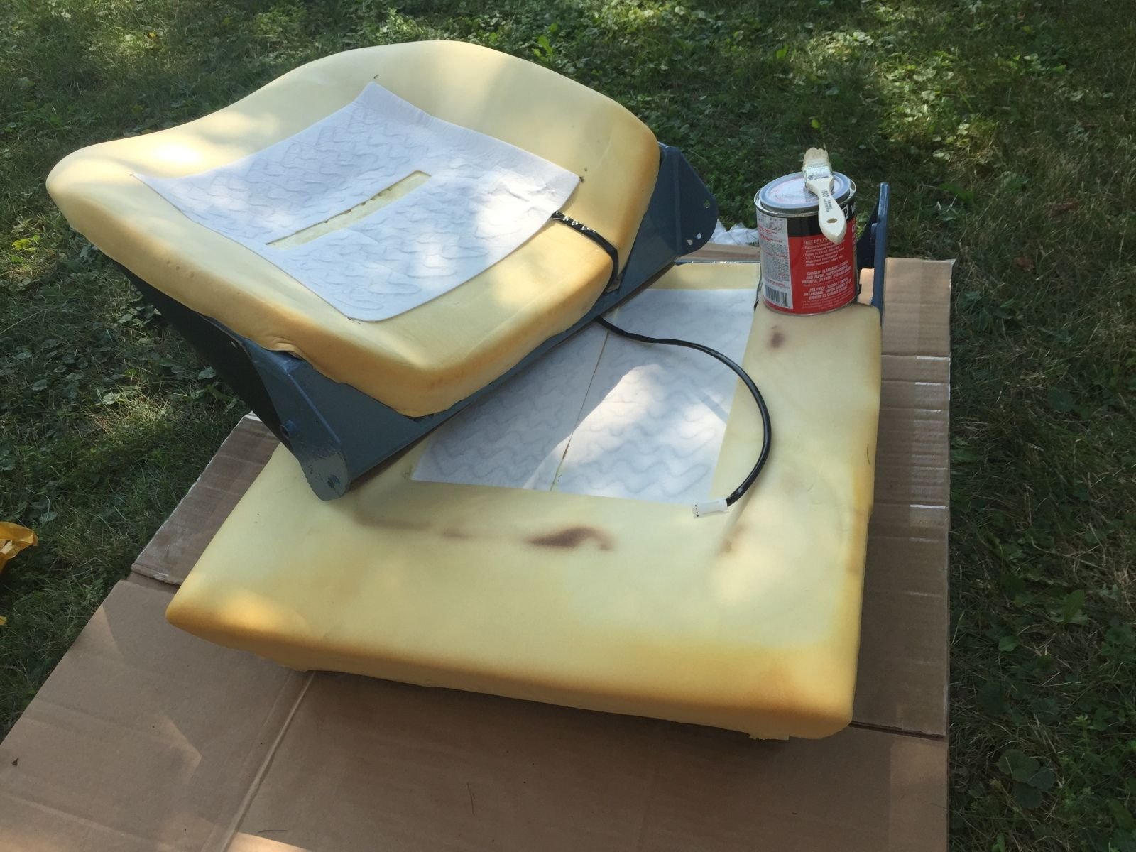

Oh yeah... those diaphragms are really tough to stretch. I restored the seats on my Sunbeam Alpine several years ago, and they have the same setup. I used a LOT of very, very, bad words doing that job! My wife held the seat frame while I used vice grips and a pry bar to get the links into their holes. It was NOT fun... you have my utmost empathy, IBC3!
When I did my Alpine seats I also added heated panels. It was quite easy and remarkably inexpensive. Only about $100 for the kit (Dorman brand), and I just used contact adhesive to stick them to the foams prior to applying the padding and covers. I routed the wiring and switches and wiring discreetly, such that they are entirely hidden, maintaining the 'original' look of the car, while offering modern comfort. Being a convertible, it makes the Alpine much more 'top down' drive-able in early spring and late fall.

Were the 'ties' sewn to the inside of the seat seam?

In both sets I did, the covers had a lining that I pierced and threaded the fabric ties through, so no glue or stitching was required.
