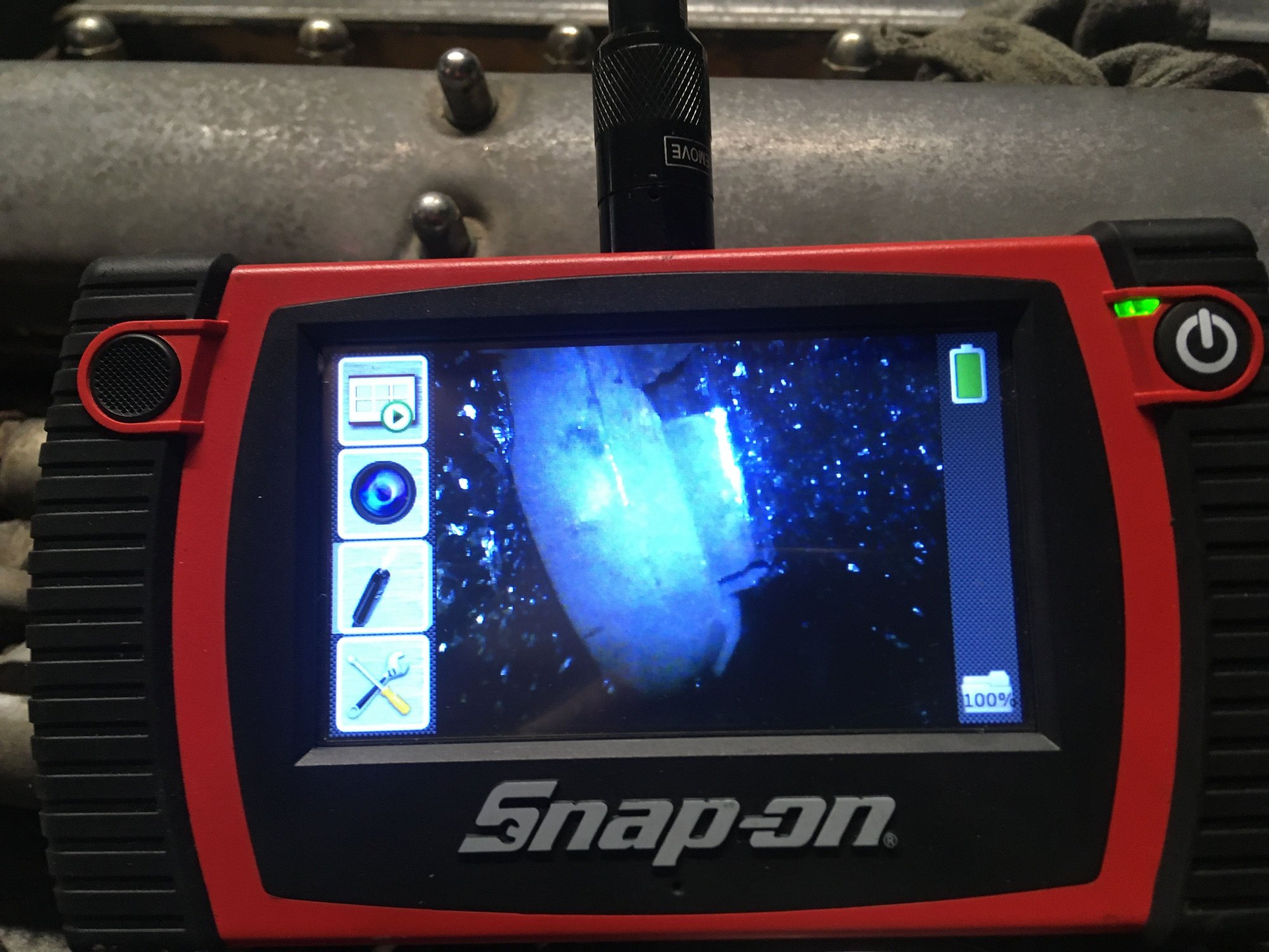

I'll try to keep it short. I work at a shop and from time to time work on some cars for a private collector/dealer. He acquired a Series 1 (and a Series 2) that he wanted me to look at. The PO had parked the car in the 80's due to a "bad starter". I removed the starter to find that the nut had stripped off the shaft and the various springs and collars had fallen into the clutch area. I was able to "fish" out most of the parts except the nut. The owner was anxious to get a rebuilt starter in. I was hesitant because I had not retrieved the nut. Upon a few cranks, the nut became lodged between the transmission (or bell housing) and the clutch pressure plate stopping the engine. This was all viewable via a digital video scope camera (I wish I had access prior to installing the starter!). I know what is involved with trying to retrieve the nut, time consuming and costly. My question: Has anyone been able to loosen the transmission enough to release the nut without completely removing the engine and transmission?
I know what is involved with the problems of the driveshaft being unable to be removed from an E-type. My proposal is to remove the exhaust and remove the drive shaft nuts. I would then lift the engine off the motor mounts and loosen the bell housing bolts. I would pick up the engine and move it forward (only have about an inch) and will probably have to drop down the rear to get the drive shaft to out. My intension is to only separate the bell housing from the engine enough to hopefully get the nut to "drop out".

Thanx Daytona and Bob_S.
Daytona- I'm willing to give it a try. I once had a XK140 with a bad overdrive. We didn't have as much space at our old shop so I had to work on it outside under a canopy. I removed the radiator and with the car on jack stands I lifted the motor with one of those engine load levelers in place. I was able to move the engine far enough forward to get the overdrive unit out and sent for rebuild. I left the engine supported on the engine hoist until the overdrive unit was repaired.
Bob_S-- I did put a socket on the crank and tried turning both ways. I did not try it in 4th gear though. The unfortunate thing is it stopped the motor turning abruptly when first cranking so I'm sure it's wedged pretty good. I will give it that a try in 4th gear next week when I go back with the inspection camera. It's a bit of a challenge going through the starter opening and over the flywheel. Here is a picture of the nut viewed thru the inspection camera.
