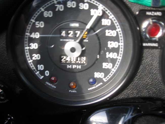

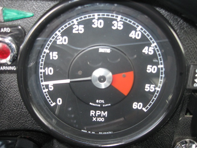

IMHO, Just loosen the entire linkage on the car. pull back all the pre set screw settings.
Another words everything is just barely tort.
Then snug up the linkage and then turn in the idle screws, watch the shafts that they all turn even across the three carbs. DISCONNECT THE CHOKE linkage while doing this. Then once your settings and linkage are close, Now add the choke linkage and cable locking nut. Does this make sense?
I think your choke wire is too far in , making it choke more and keep the revs up. Hope this somehow makes sense.
ITS A PAIN IN THE ASTERICK, But once done, your car will be smooth as glass....
Or like mine
