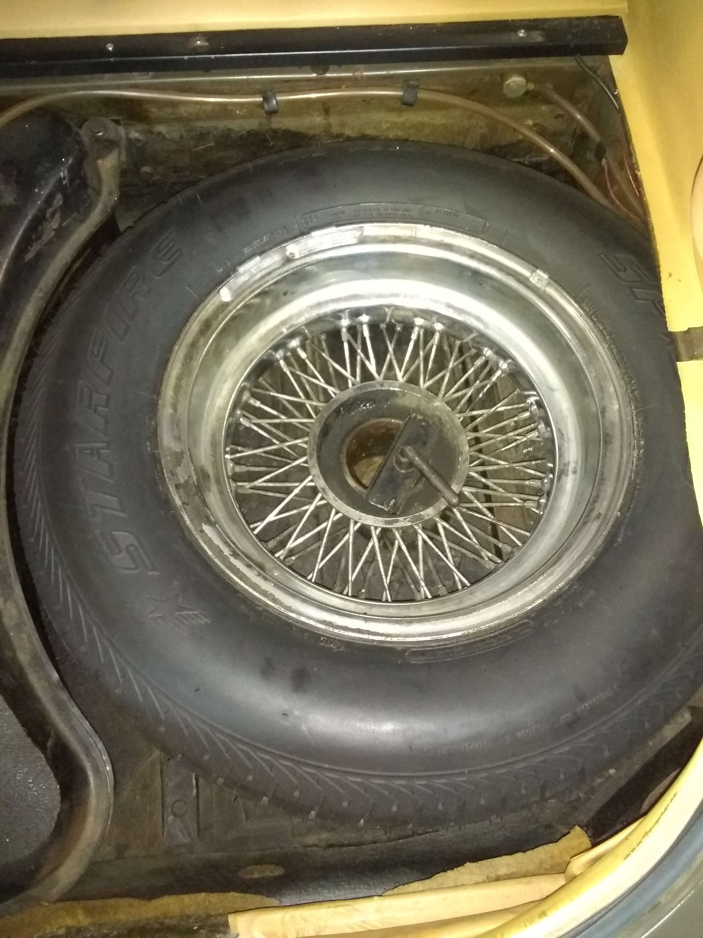

Hi Valerie,
I see that you chose tires sized 205/75/15s. Have you had any issues with any of the tires rubbing? Also, I agree with you that all five tires should be the same size, so, any issues with the 205/75 fitting in the spare tire well or the cover fitting in all the way? I have 185s now on my 68 FHC, and the spare tire just fits in the well. I cannot imagine anything larger fitting in there.
Old Mar 23, 2025 | 09:41 PM
Valerie Stabenow's Avatar
Joined: Oct 2020
Posts: 1,444
Likes: 609
From: Wisconsin
Hi and I have had 205s on this car for over 35 years. I did find a chart that gave the physical dimensions of tires of various sizes. Will try to find that and post it. Like you , I knew I needed a spare, but concerned that it would not fit in the spare tire tub. By chance and good luck, my shop had one sitting around, and they could do a trial fit. I can take a photo of that and post it.
OK, not the chart I was thinking of, but it works
https://www.calculator.net/tire-size-calculator.html?ctw1=185&car1=70&cws1=15&ctw2=205& car2=75&cws2=15&ctype=2&x=Calculate#compare
The 205 will then be 1/2 inch larger than the 185 on all sides to equal the 2 inch size differential in the chart. See if you have a 1/2 inch gap all the way around your spare when it sits in the tub.

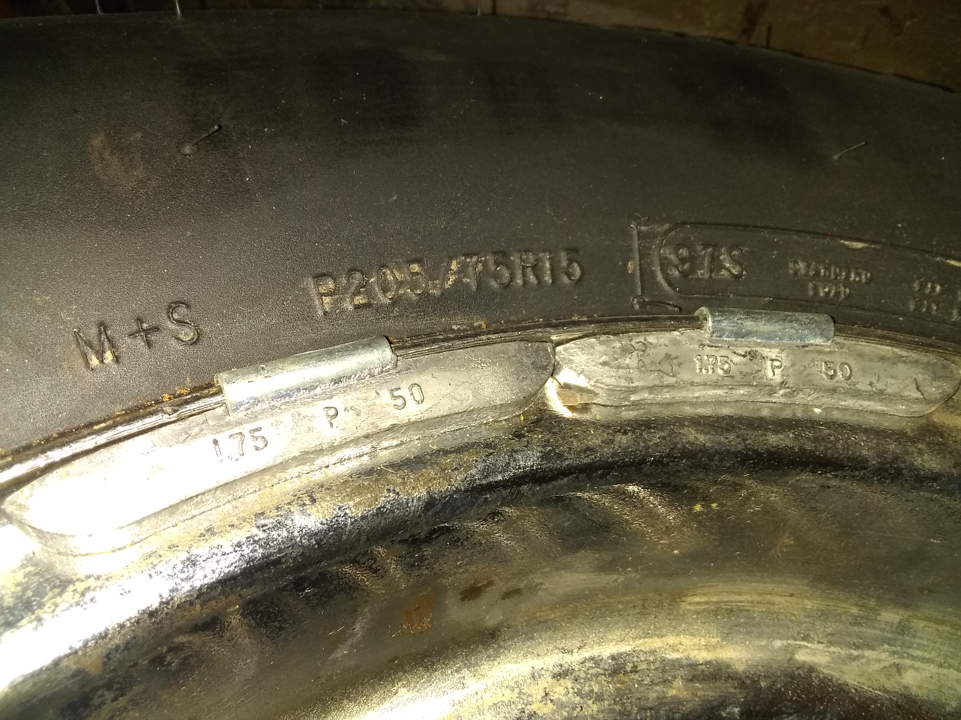

Default Photos of 205/75/15
Here are two photos of the 205 in the spare tire tub. The first shows that it is a 205/75/15 and the second shows it in place. This is in a 1969 S2 coupe, built Aug. 69. Note the position of the tire hold down clamp. The bag that holds the jack and related and the tire hammer all fit in allowing the boot board to close.
Hope this helps.
Attached Thumbnails Suggestions for size wire wheels and tires-tirephoto205a.jpg   Suggestions for size wire wheels and tires-tirephoto205b.jpg
Old Mar 24, 2025 | 07:25 PM
Daytona's Avatar
Joined: Oct 2018
Posts: 458
Likes: 68
From: Daytona Beach, FL
Thank you, Valerie. A picture paints a thousand words. I think the spare tire tub in your series 2 coupe is the same size as the one in my series 1.5 coupe. Your photo shows that there is just enough room to hold the 205s. And that is enough. Your photo is very helpful. Thanks again.

I believe you can input various tire specs and it will give you the measurements. IIRC the 50 in your case would mean that the sidewall is 50 % of the 205, which would change the overall diameter of the tire. ... about 23 inches???

Likes: 4,175
Valerie - Slightly off topic question but why didn’t you ask your tire shop to balance your wheels from the inside so the weights would be hidden?
Old Mar 31, 2025 | 09:14 AM
Joined: Oct 2020
Posts: 1,444
Likes: 609
From: Wisconsin
Default A good question
Might be hard to see in my photo, but that IS the inside/backside of my spare and the weights ARE mounted there.. check the inner hub where the spokes connect.
Old Mar 31, 2025 | 02:41 PM
Ken Cantor's Avatar
Joined: Mar 2022
Posts: 4,565
Likes: 4,175
Apologies for missing that. You have a beautiful car by the way.
