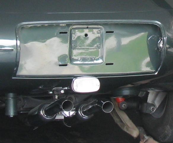

OK - I finally got my car back home so I can show photos of how to open the boot (trunk) lid without use of the release cable. Note that this is all for a Series 1 4.2 OTS, so things may be different for other series or models, but maybe not too much different.
Photo 1 shows the general license plate area without the license plate in position. There should be a fairly large, smoothly finished hole at the upper center of the plate area. This is the factory-provided access to the boot lock and is the path to take if the license plate can be removed.
trunk stuck closed/69 e-type-img_z50.jpg

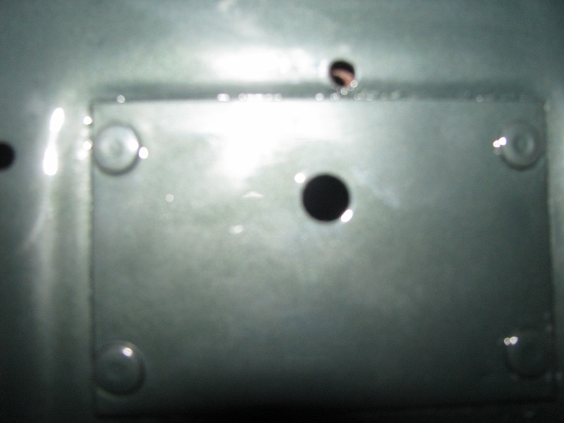

Photo 3 shows the two access points to the boot latch guts. The small upper hole is the one that a lot of the dealer shops added back in the day. First we assume that the license plate is not present so we can easily use the larger factory-provided access hole.
trunk stuck closed/69 e-type-img_z52-800x600-.jpg

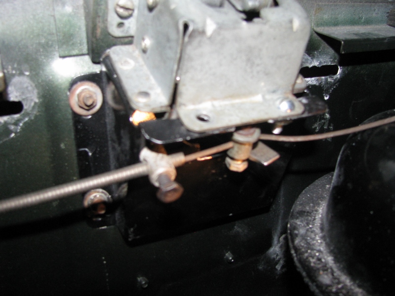

Photo 5 shows what is happening inside the car. Note the tip of the screwdriver resting against the latch lever. The rightwards manuever in Photo 4 would move the latch lever to the left in this photo, which you can see is what the cable would do normally. (Yes, I know that a screw is missing.) Note also that on my car there is a large slot cut out in the forward portion of the latch housing to give the screwdriver access to the lever. Without that slot there, this manuever would not be possible.
trunk stuck closed/69 e-type-img_z55-800x600-.jpg
