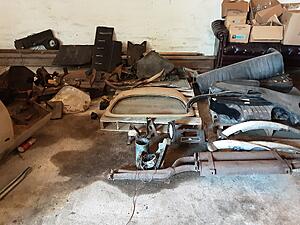

Yes, just used this yesterday when I went to look at a Barn Find 2+2 E. Current property owner needed assistance in how to dispose of the car.. sell? how much? etc. I believe she has it listed on Facebook marketplace. Wisconsin. If you do find that listing and want further info, please PM me as I spent about 2 hours with the car and parts.
