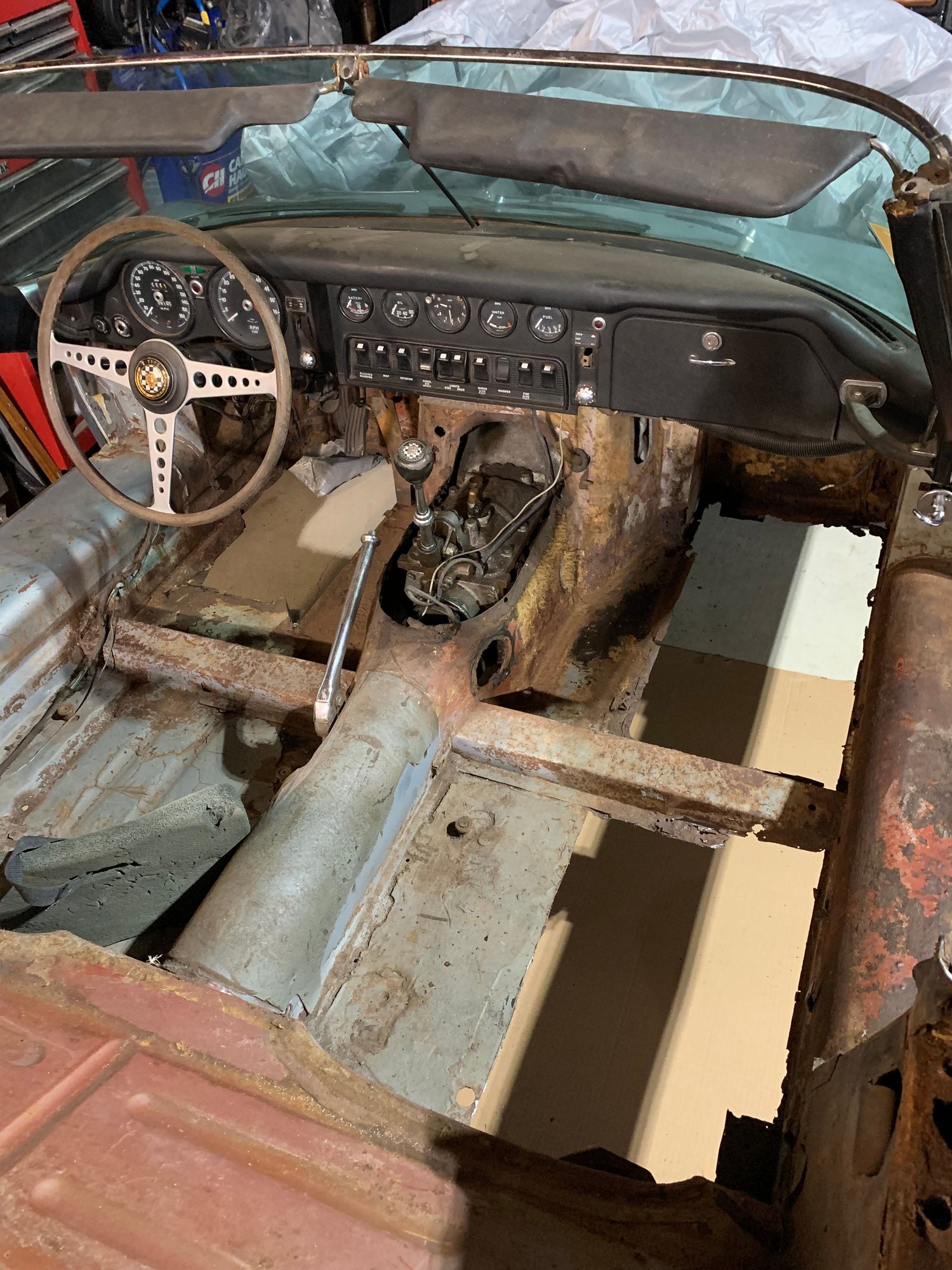

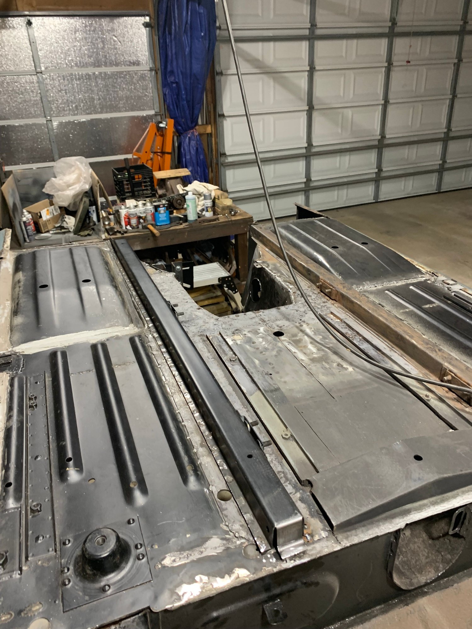

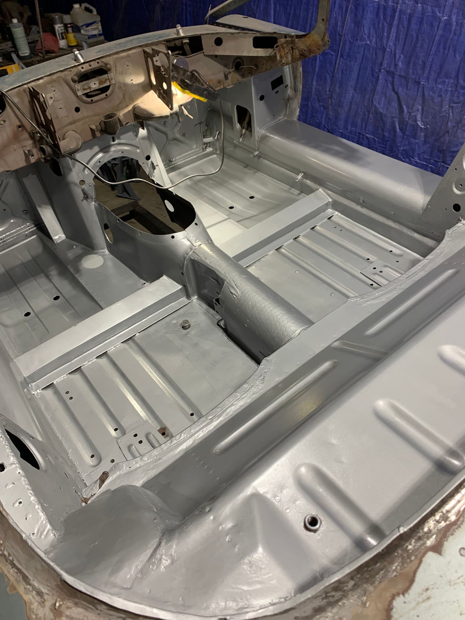

Ironically I also acquired my 70 OTS in Jacksonville, and the interior floor and sheet metal was about in the same rusted condition when I started my restoration. I got most of my sheet metal from either SNG or Martin Robey but there were several areas, especially where not visible, that I made significant structural improvements to strength the car.
As started
As started
Bottoms up
Bottoms up
Inside out .. complete

OMG John! That was some serious rust. It appears you replaced the entire tub; whole different league from my efforts. Keep us posted on the rest of it.
