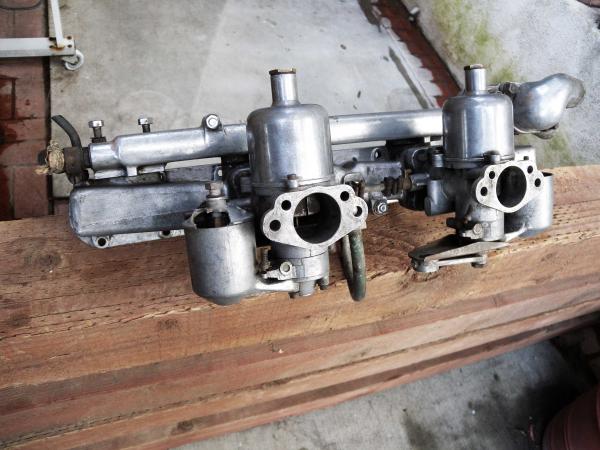

Mike, would you happen to know if these are HD8's?
Attached Thumbnails What SU carbs?-cybersib-123159-albums-mark-v-restoration-project-4828-picture-su-carbs-2-18393.jpg

From the shape of the bottom of the float chamber, these look like the type HD. BUT, since they are only twins (the Jaguar HD.8, I think, always appeared as triplets - except in the 420 and 2.8 XJ6, but those would not have had the early metal damper heads). Plus from the significant height of the damper "chimney" (the HD.8 is much shorter - that's the main clue), I'm guessing these are a pair of HD.6. Do you know what model these are off of? From the manifold shape, it looks like it might have been the 3.4/3.8 Mk2/XK150, but then where is the thermostatic starting carb?
So Dr. Watson would say these are the HD.6. Sherlock Holmes, I ain't.

Another thought - if you have this ensemble in hand, flip it upside down and look for a part number cast into the bottom of the manifold, near the forward carb (e.g., C.nnnnnnn). This might point to the car type from which it came.

Thanks Mike. These "supposedly come off of an early XK, but I don't know for sure. The manifold number is - C12438. My hope is to sell them off, and in turn purchase a triple set-up for a 4.2 XJ6 engine. I'd love to get webers, but dang... it's an expensive venture! The "start-up carb" is missing, as is one float and both float bowl covers.

I researched the number and low and behold, it comes off of an early XK150. Good thinking Mike! Any idea if these will fit a 1986 4.2 engine? I have fuel injection, and want to scrap it because it is going in the custom Mark V I am building (so I really need the vintage look).

Dunno if the FI head's intake mounting geometry would match up with the carbs. Might require some custom fabrication? I assume you already know that the XK engine is significantly longer than the push-rod engine originally in the Mk V. I would assume that putting carbs on a FI XK engine is easier than putting an XK engine into a Mk V chassis.
