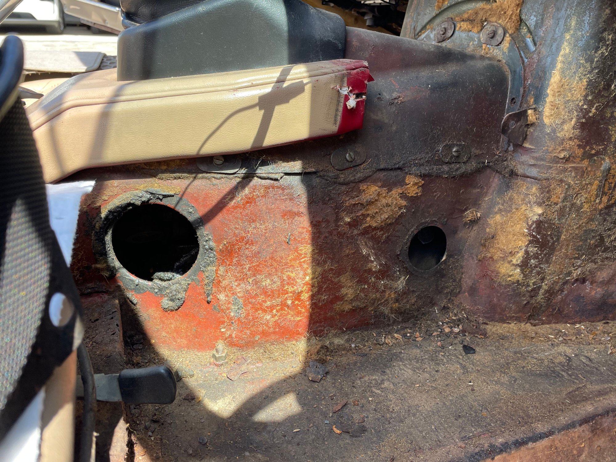

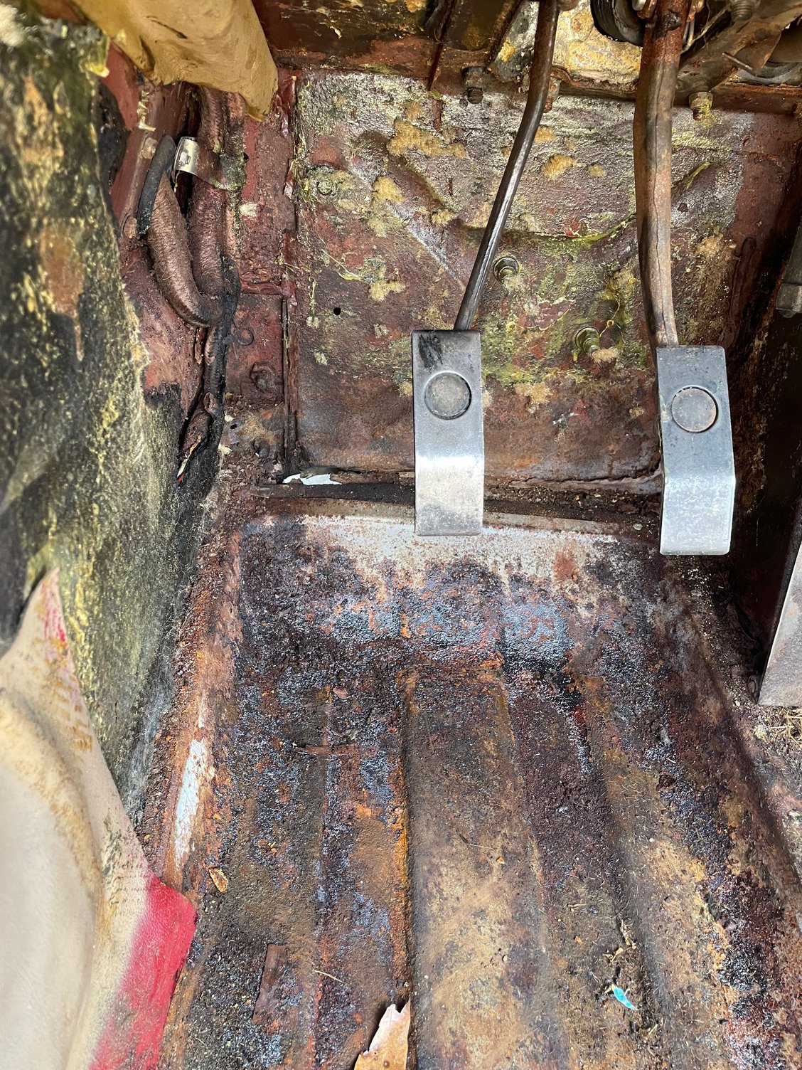

Then I started removing carpet to expose the rusted floor pans. . But as I look closely, it appears the rust on the driver side rises above the pan level behind the clutch pedal. Watched lots of videos about pan replacement, and was hoping a "nibbler" and screws would suffice. But WHAT to do about the rust that is outside their perimeters? Maybe bondo and or fiberglass patch?

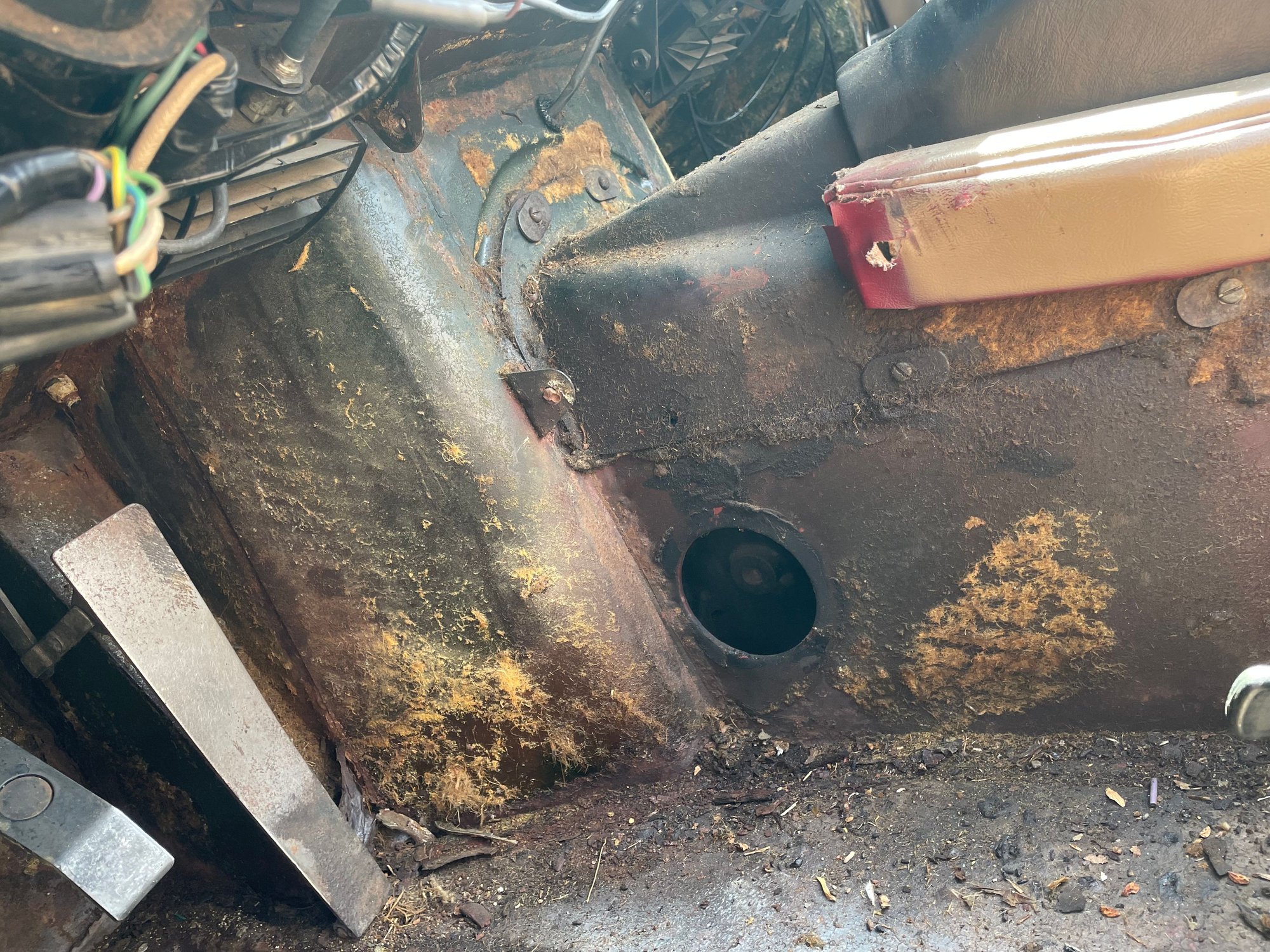

I discovered open holes in the transmission tunnel. Haynes informs that they are "lubrication apertures" and reference "metal or rubber" covers. Moss has 2" plugs but no joy on 4". I am thinking of using the circular wall door knob protectors unless someone knows of a source?

rust just above floor pan to left of clutch pedal
transmission tunnel opening, driver side
transmission tunnel openingS, passenger side

I am pretty sure that the plugs are available from SNG or Moss.
As for the floor and rust repair, the only way to do it, is to do it right. No screws to secure the new floor panels you have or any other panel you may need to replace. Mig welding would be the correct way. All panels are available from the usual suppliers. Replace one panel at the time, unless you have a jig bench.

Not clear from photos, but FYI, jaguar used a red oxide primer. So I am hoping that the footwell verticals are not really rusted (?)
Using a heavy duty metal brush to remove surface scale may provide a definitive answer.

Larger trans tunnel plug:
https://www.sngbarratt.com/English(U...4-8ffa82cfdd7e
