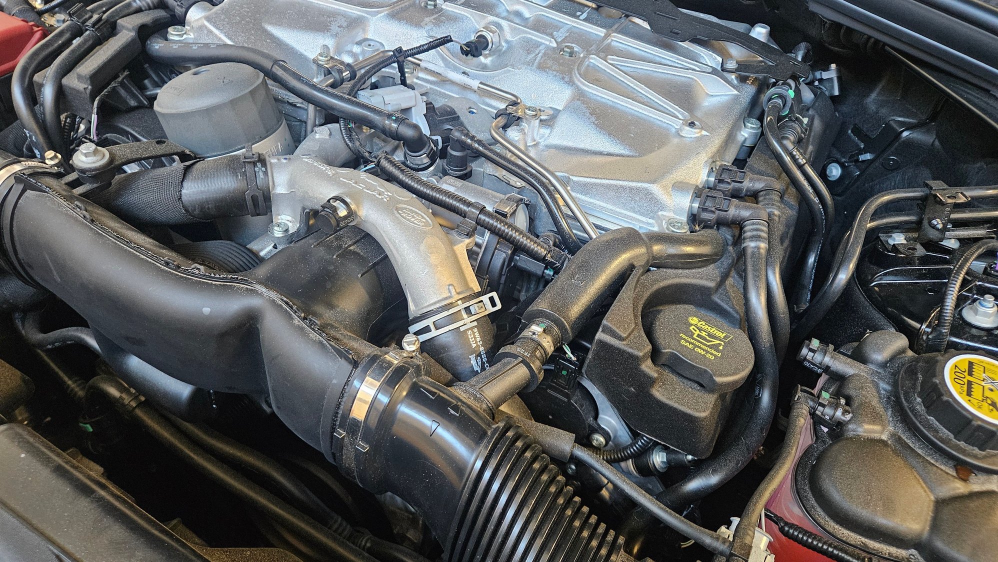

if you can get the money for the 2026 SVR It has oem metal
cooling pipes that will make the SVR last forever

2025.5 models also included the metal coolant pipes, but the newer model years may exceed the OP's budget. Considerable savings could be had on a 21, and have enough leftover even after replacing the pipes down the road.

I would have no hesitations on a '21 SVR if it has been well maintained. I've now had five of the AJ133 5.0 V8 engines (3 jags and 2 Land Rovers). They have been pretty bulletproof. I got my 2010 XF V8 SC to about 100k miles. Same with the two Land Rovers. No engine work beyond an occasional cooling pipe as others have mentioned and a water pump on each. I now have a 2017 SVR (F Type) and 2025 SVR (F Pace) and both have been tremendous
Regular maintenance and care, and quick intervention if any issues are found. I don't have too much worry about the plastic cooling pipes - yes it's a pain but all modern cars do the same. And the limited parts I have had to replace hasn't been an issue
I do think worth regular check of oil (I've never had a leak on any of mine) and of the coolant reservoir is an easy early indication of potential issues

They are generally pretty good, if the engine feels smooth and strong when you test drive, I wouldn't be afraid of it. The Fpace overall is a decently reliable chassis, and the 5.0 is not bad, the fear on here over outlet pipes is overblown. Even the metal pipes will need o-rings after a few years, same as the plastic ones. Just part of the maintenance plan at this point on most newer cars with plastic cooling system components.

I would have a series concern on the plastic pipes, we change about 10 cars a week after blow out,
with a few blown head gasket, easy upgrade and you don't
have to worry about it again, thats why JLR started putting the
Metal pipes in 2025, just do it and be done

Do you mean the HG failures are a consequence of coolant pipes failing?

Absolutely!
If you don’t pay attention to the coolant level and keep an eye out for leaks then a small leak can turn into a large leak which turns into an overheat which almost always turns into a very bad day for the motor. You can not rely on the temp gauge for timely notification.

Yes, the cars do not like to be overheated, if you get the warning message for overtemperature, you cannot keep driving at all, it tells you to stop and turn off engine, you have to do it asap. If it's just coolant leaks and you fix them it's never an issue, but people ignore it until it's overheating, then ignore that, then cry when the car needs an engine. Worse on the V6 than the V8, but very similar.
