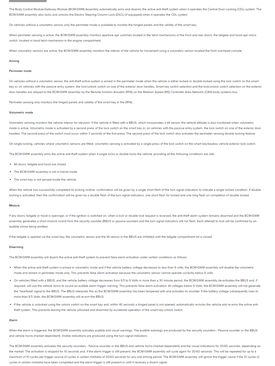

Attached a clip from the workshop manual, if you try as it mentions to only single press the lock button, which should not arm the volumetric sensor, does that stop it from beeping? I was looking for it stating the double beep was due to the alarm trigger but I didn't see it in this section, I will have to keep looking.

only ever use 1 push to lock the car so it's interesting that it feels there's something wrong with the internal movement sensor. It's booked in with a Jaguar dealer in February. That's the earliest they could do!
