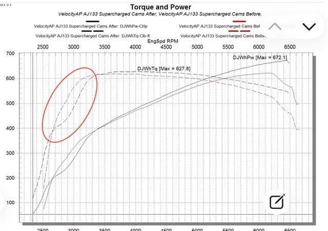

When I reviewed the Torque and Power plots associated with the new billet camshaft I see the following: Increased torque with the new camshaft above 3600rpm. However, I also see that this comes with a significant trade off loss of 80 DJWhTq torque in most of the the 2700 - 3800 rpm range. Usually that's a trade off that's inevitable when increasing valve duration and/or overlap. Where a driver would experience this is very much an everyday driving range and where I prefer to see a nice fat torque curve and feel it in my seat pants. Obviously in this application to max out a highly modified SVR to gain extra hp even with this torque loss in the lower rpm range it's still not going to be lacking grunt in everyday easy driving! Did I construe this graph correctly and would you care to comment. PS. keep up the great work!

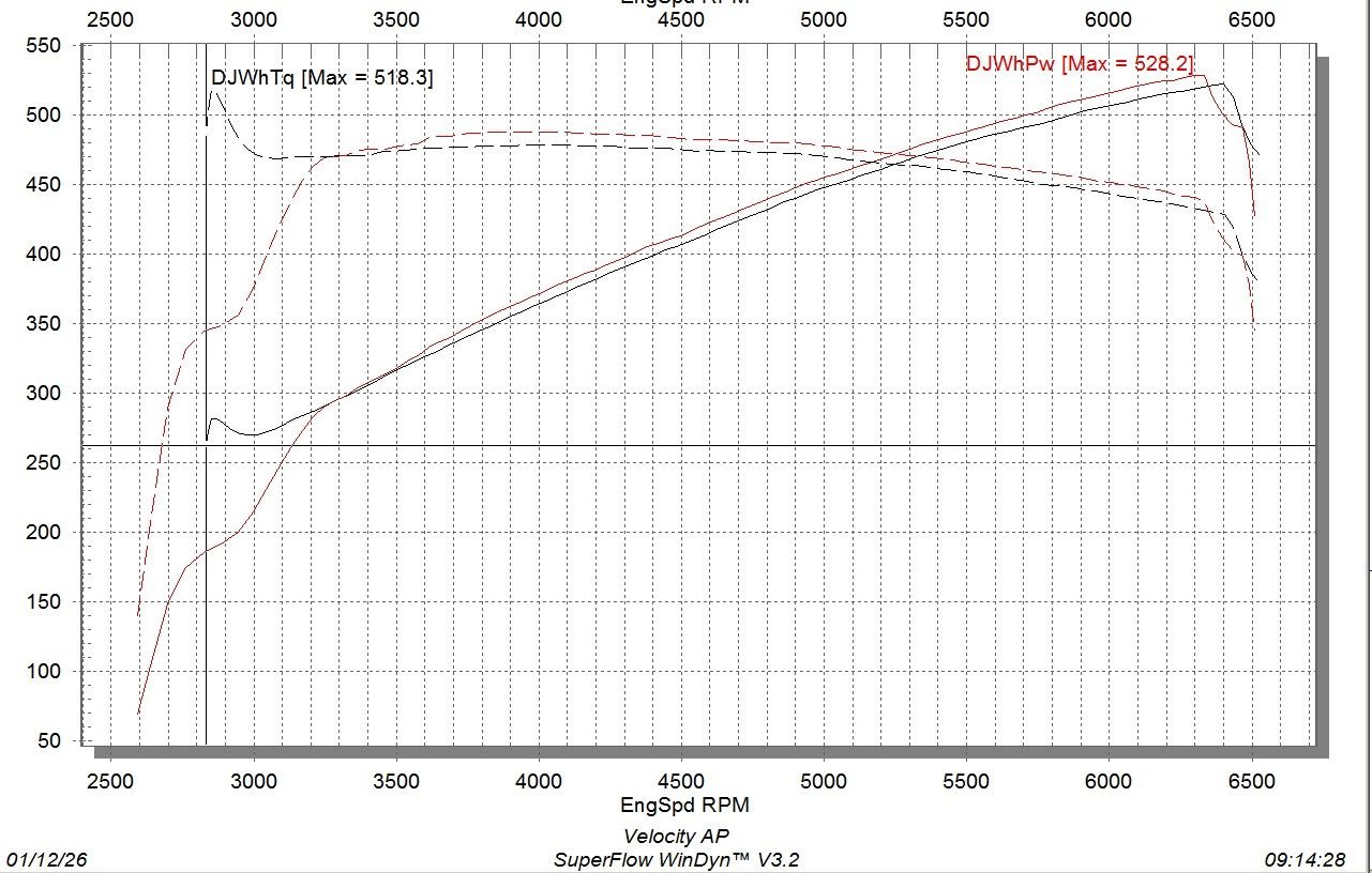

Just a subtlety to running a dyno. There is actually a fair amount of skill & experience required to 'drive' the car on the dyno. Particularly on a forced induction application. The dyno is applying resistance against the rollers, and will hold the car back from starting the test. To start the test you need a reasonable amount of load providing some resistance against the rollers. If you're way off the throttle, start the test and try to mash it, you'll see a dip due to not having enough load. Conversely, if you apply too much throttle and generate too much load against the rollers (again, with forced induction this is even more critical, because the SC will start closing the bypass to generate boost or a turbo will start closing the wastegate, and allowing timing advance if load is sufficient) and then start the test you have an unrealistic amount of load built up. The load level is too high, wouldn't be present under those conditions on the road and it will spike torque.
Further complicating things with JLR is that there is a kickdown switch under the pedal. So if you are the dyno operator and trying to get some load (but not too much) on the pedal, hit the button to start the test and release the rollers from holding the car back at the RPM you have selected, and floor the throttle just at the right moment without activating the kickdown switch...... I think you get it. For that reason, if you're looking at the start of a test on a loading dyno, generally the first few hundred RPM you can disregard in terms of providing a comparison.
Here's a good example to illustrate the point. Disregard the power numbers in comparison to the Cam output, these are just a set of graphs I found from when we were testing some other stage of tune on the 1900 supercharger on a different vehicle. You can see clearly that there is a large torque spike at the beginning of the graph on one of the runs. That isn't real. Or at least, it isn't real in the sense that this isn't what the torque output would do on the road in real world conditions unless you were brake boosting the car while rolling. What's happened there is the opposite of what you're observing in our 800BHP graphs, ie - the operator has applied too much initial throttle while holding the rollers on the eddy brake, and when they release the rollers to start the test it's spiking the torque measurement due to excess load. Soon as the rollers start to accelerate that torque spike goes away.
So really when you're looking at a dyno graph you want to disregard the first few tenths of a second until you get the car accelerating under even load and under WOT. What you're looking at below is two close time proximity runs of the same calibration & hardware on the same car.

I should add that this is also showing from 2700-3300, not 3800. And that to a large degree on modern engines like this, the disadvantages of more aggressive cam profiles are mitigated by the ability to control cam advance, which is why even on a stock cam you can have something that's fairly agressive at higher RPM, without having it idle like a cammed big block!
