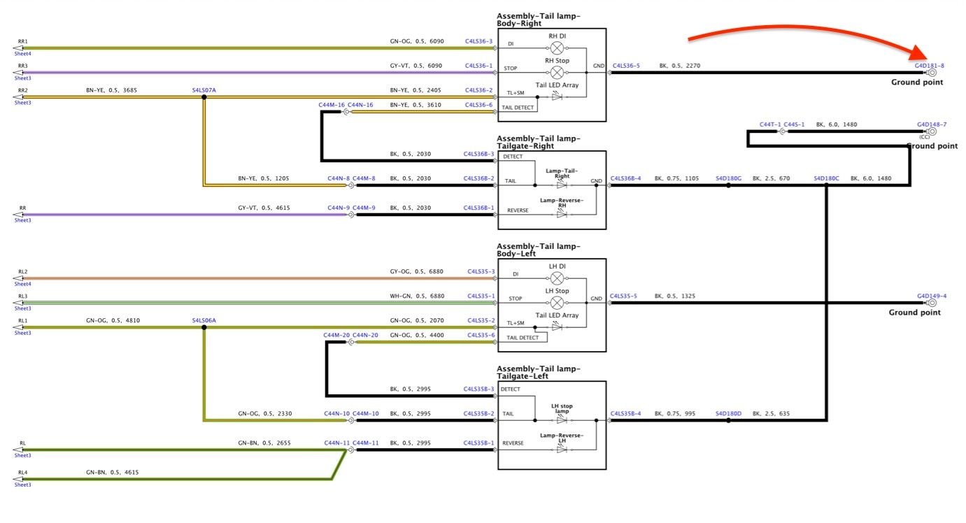

Originally Posted by sammydad
Hi,
It usually happens when I signal right. I've checked the turn lights on the outside of the car when this occurs -- it appears that the rear lights are not turning on when this happens. For example, when I'm signalling right and it fast blinks, both the rear right turn light on the truck and the rear right turn light on the fender do not work. When the problem goes away, both lights work.
Any thoughts?
Most likely a ground connector
