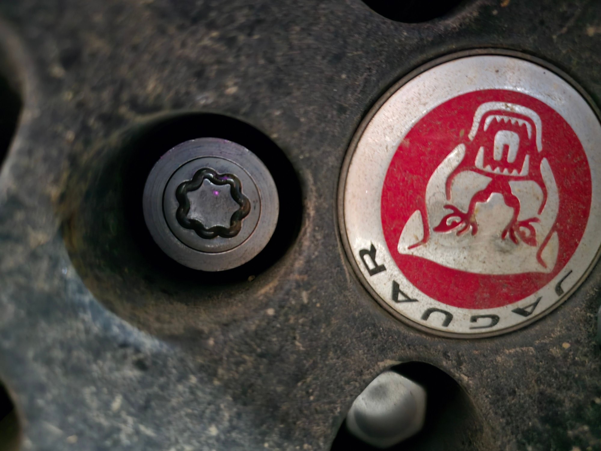

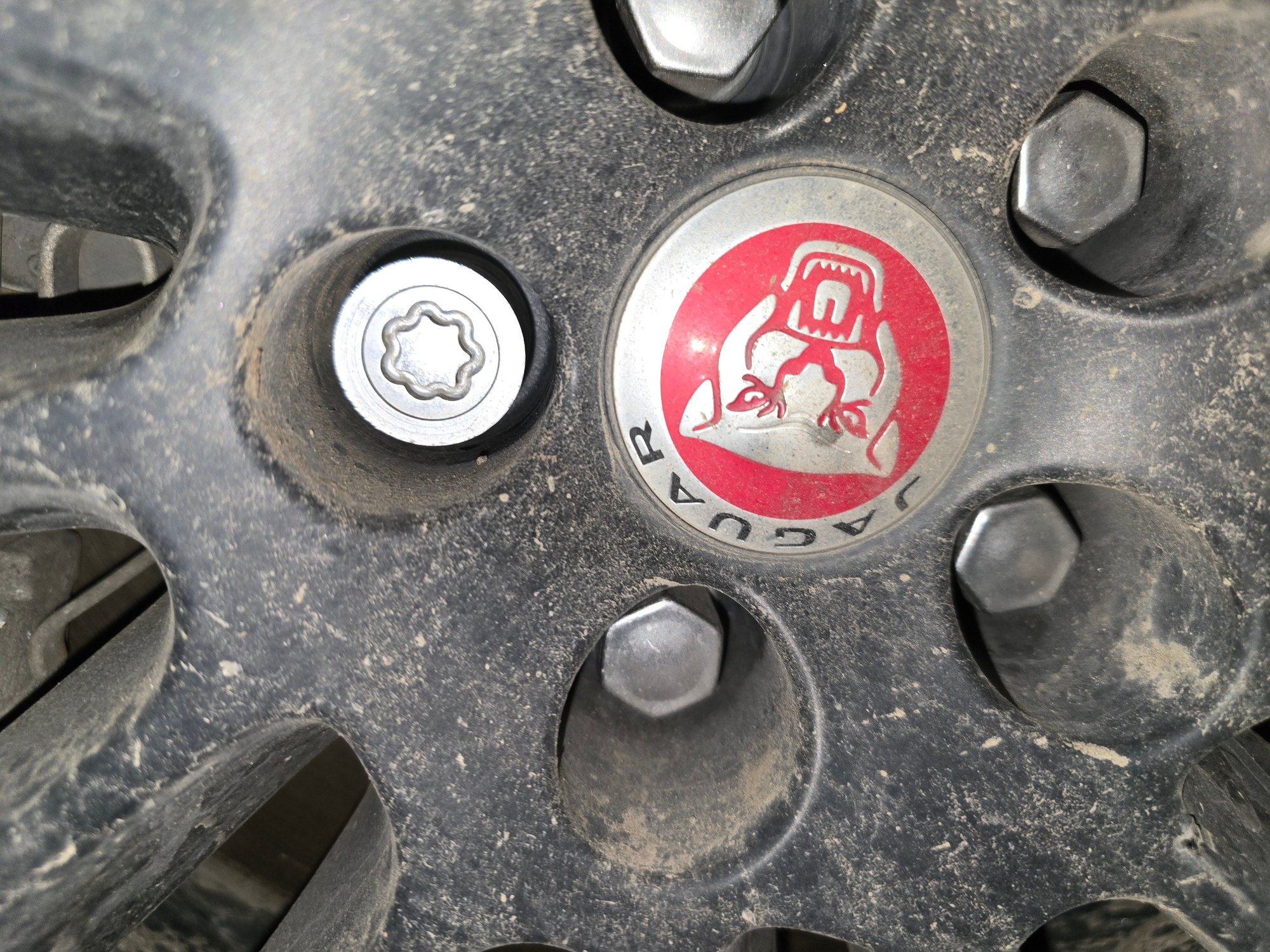

Have a 2017 F Pace Prestige. Lost the security lugg key. Had it when I did the back brakes and now I go to do the front brakes and I cannot find it. Does anyone know where I can match the pattern up to order new ones. Worse case scenario how to remove the current ones with damage tothe rim. I have included pictures if anyone knows the code.
I do not have the stick that comes in the lugg package and it is not inside the owener manual. It is a seven point.

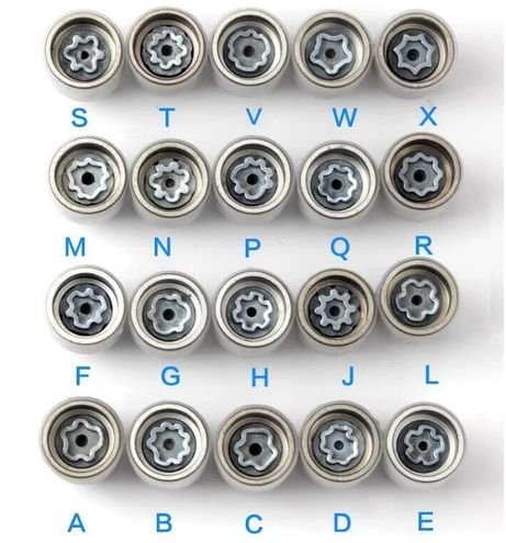

Several manufacturers now use the same style of locknut and this VAG decode may help you identify the code letter:

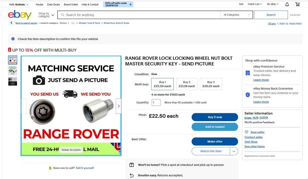

I found many listings on ebay UK for replacement keys for JLR vehicles supplied from a photo of the wheelnut. This one will deliver internationally but there's likely to be similar listings on ebay for the equivalent in the USA.
https://www.ebay.co.uk/itm/114785330...3ABFBM5K2K66tj
