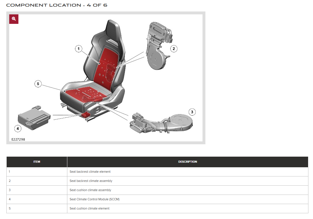

No on setting 3 they should stay on full blast all the time, cycling sounds like there's an issue in the control side of that system. Is it the same on the backrest and cushion? They should be separate fans. That might narrow it down to a seat side issue or an HVAC module issue.
I didnt notice if just backrest or seat i thought it was 1 fan. Both driver and passenger seat does the ramp up and down though.

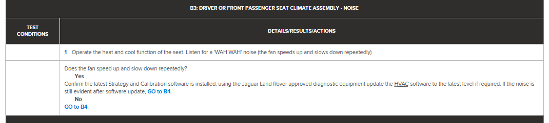

Looks like there may be software for this. If you provide your VIN I can check topix to see if your HVAC is at the latest level, to rule this out.
And just for reference, here's how the system looks inside the seats:
