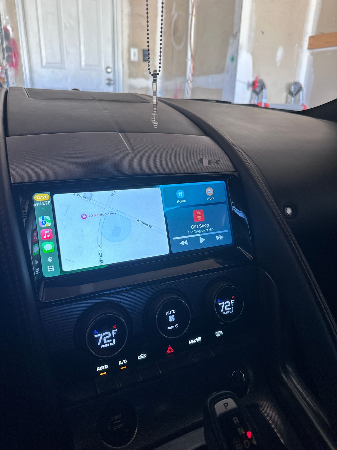

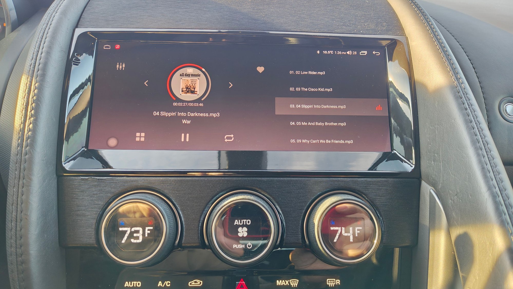

I purchased the Viknav unit and just completed installation in my '16 convertible. It took a lot of back and forth with their rep in China but got everything configured and running. I'm a happy camper now.

Yes all of the steering wheel and other buttons work as OEM. They provide a link to an emulated OEM screen showing the Jag buttons on the left/right and center screen display, so anything from the OEM screen is still controllable.

Mostly software/function config issues, like changing C to F for temp, getting the display to show the rear camera in reverse and getting the setting correct for displaying the original OEM screen. Now, there was an issue on the chassis-- they have it designed as a separate metal "box" that holds the OEM circuit boards transferred from the old head unit that attaches to the back of the new head unit by 4 screws. it was not aligning well in the "hole" of the dash and I ended up removing the mounting screws and putting it in first (connected by the ribbon cable) then inserting the new head unit. It was a very snug fit for sure but finally assembled as needed.
