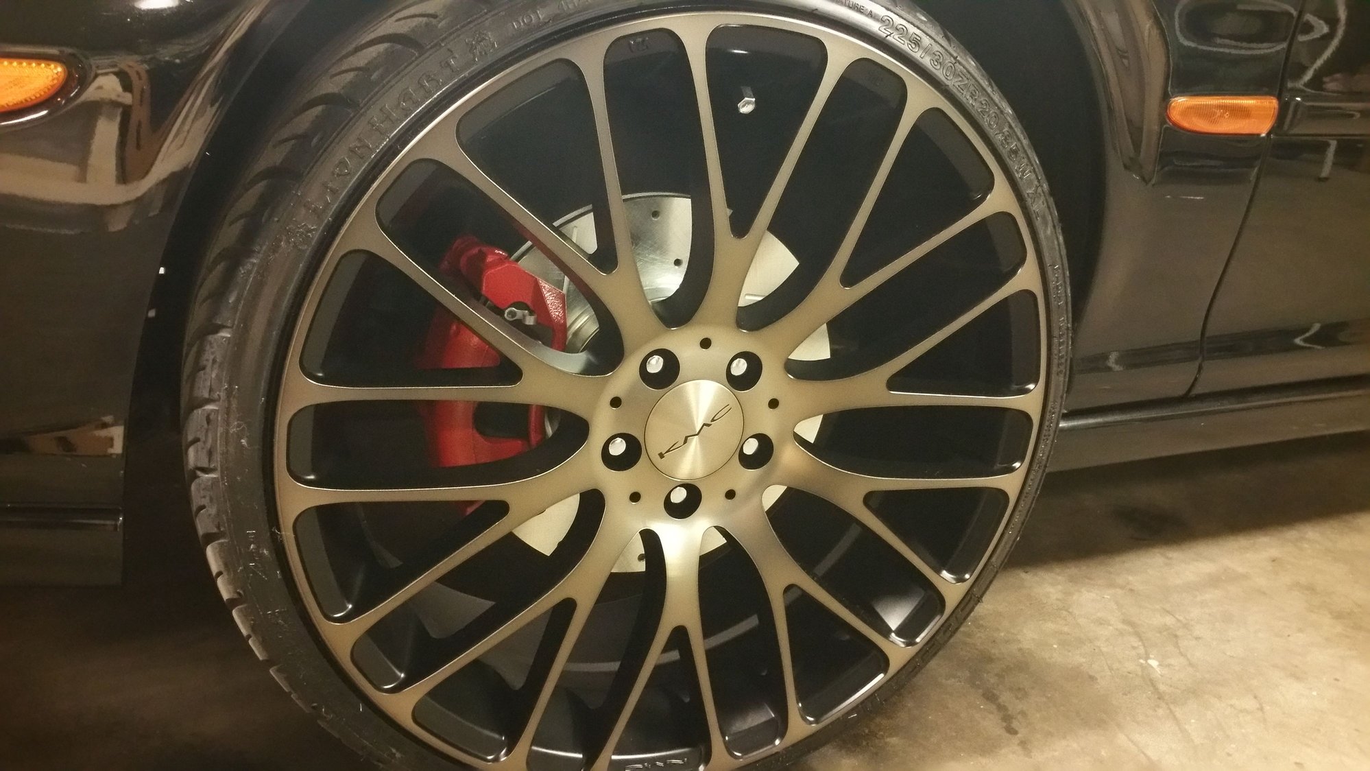

I got 20s on my x-type, and believe me... it's a huge difference. You don't have a lot of room to play, and you have to be VERY careful with potholes.
We have quite a bit more sidewall on the F-Type OEM 20"s (255/35 front) and 295/30 rear). The second number (sidewall profile) is a percentage of the first number (tire width in mm). 30% of 295mm is taller than 30% of 225mm making your sidewall about 1" shorter or about 2.6".
I was able to read your tire size (225/30) on your picture.
