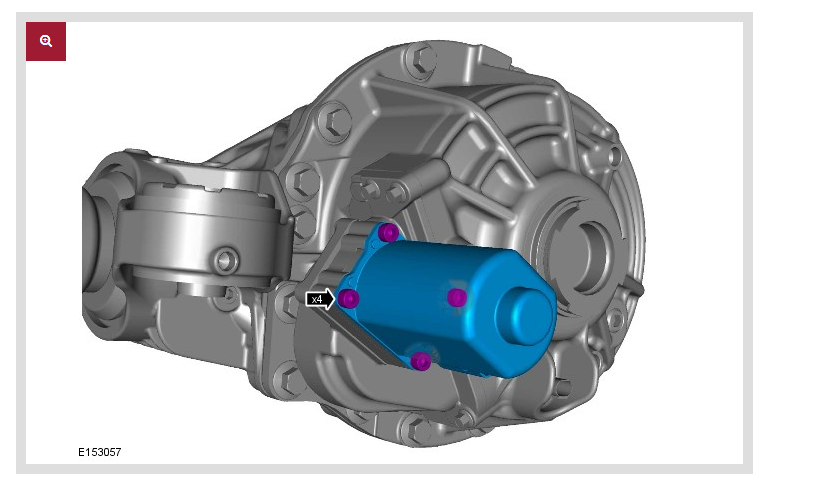

I've seen quite a few of the diff lock motors fail, causing noises while turning.
Attached Thumbnails 2014 V8 S Ftype Suspension Issue-f-typedifflockmotor.png
