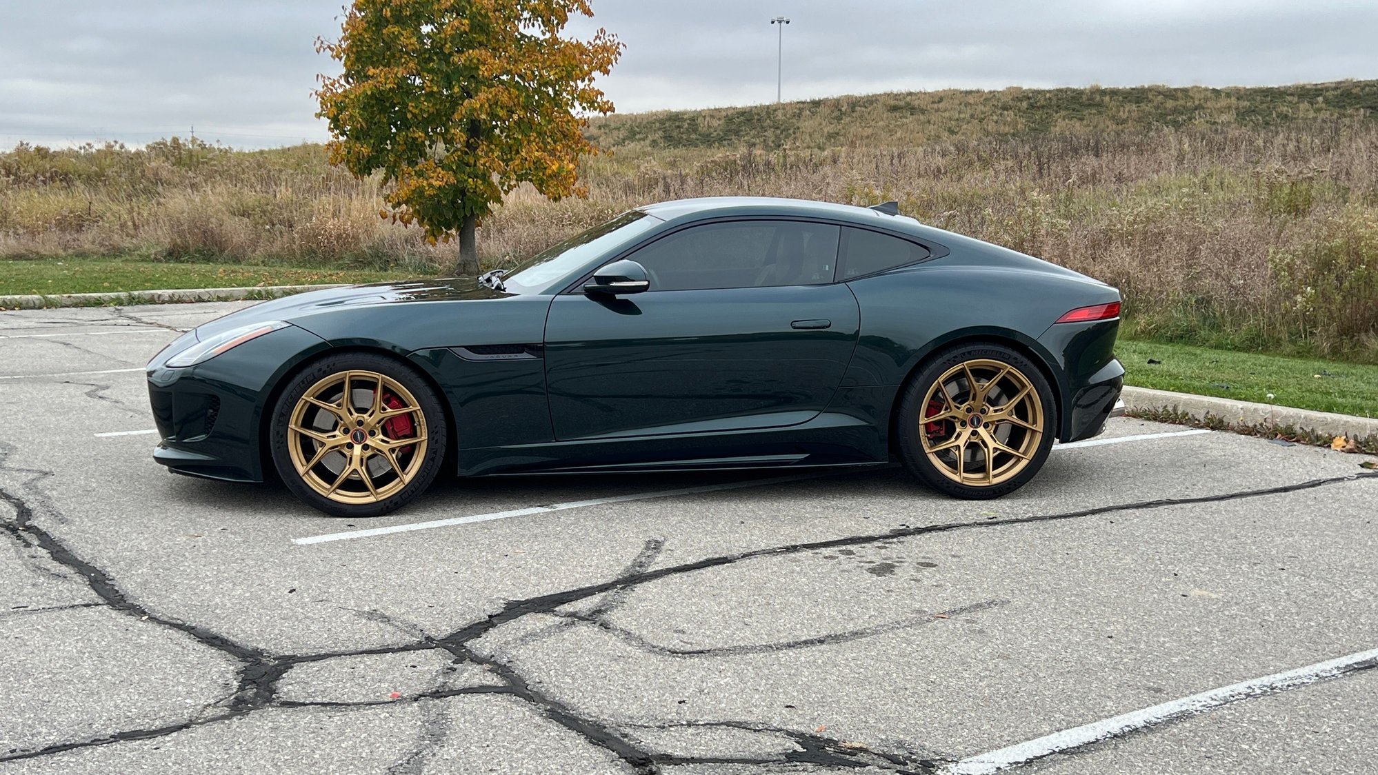

Hi @BarneyChampaign I just swapped out wheels on my '16 convertible and have the original 20" factory wheels available. Below is a photo with the original wheels, they are in pristine condition. Please DM me if you are interested. They would ship out of the Seattle area.
Bob
