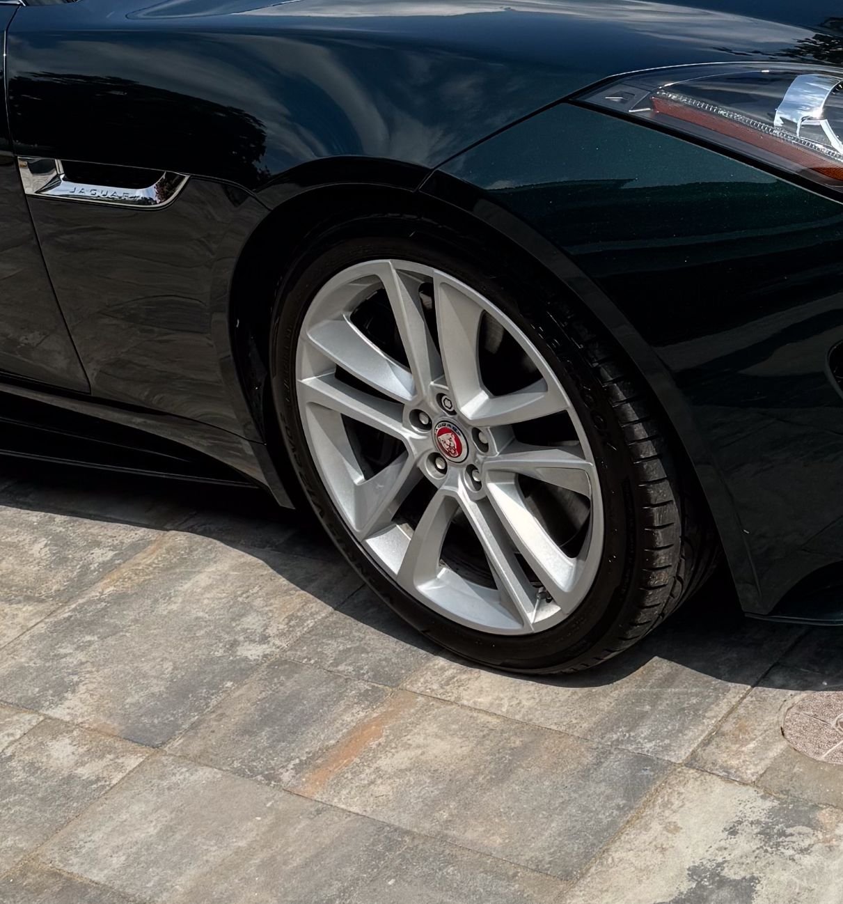

Hello, I just purchased a 2016 f type s and looking to change the wheels. I’ve gotten very confused with the offsets needed. I tried to research the best I could like what it was on factory etc but because there are options available I wanted to see if someone could help. Car is all factory atm not lowered, or bigger brakes.
picture of my wheel attached if it’s needed

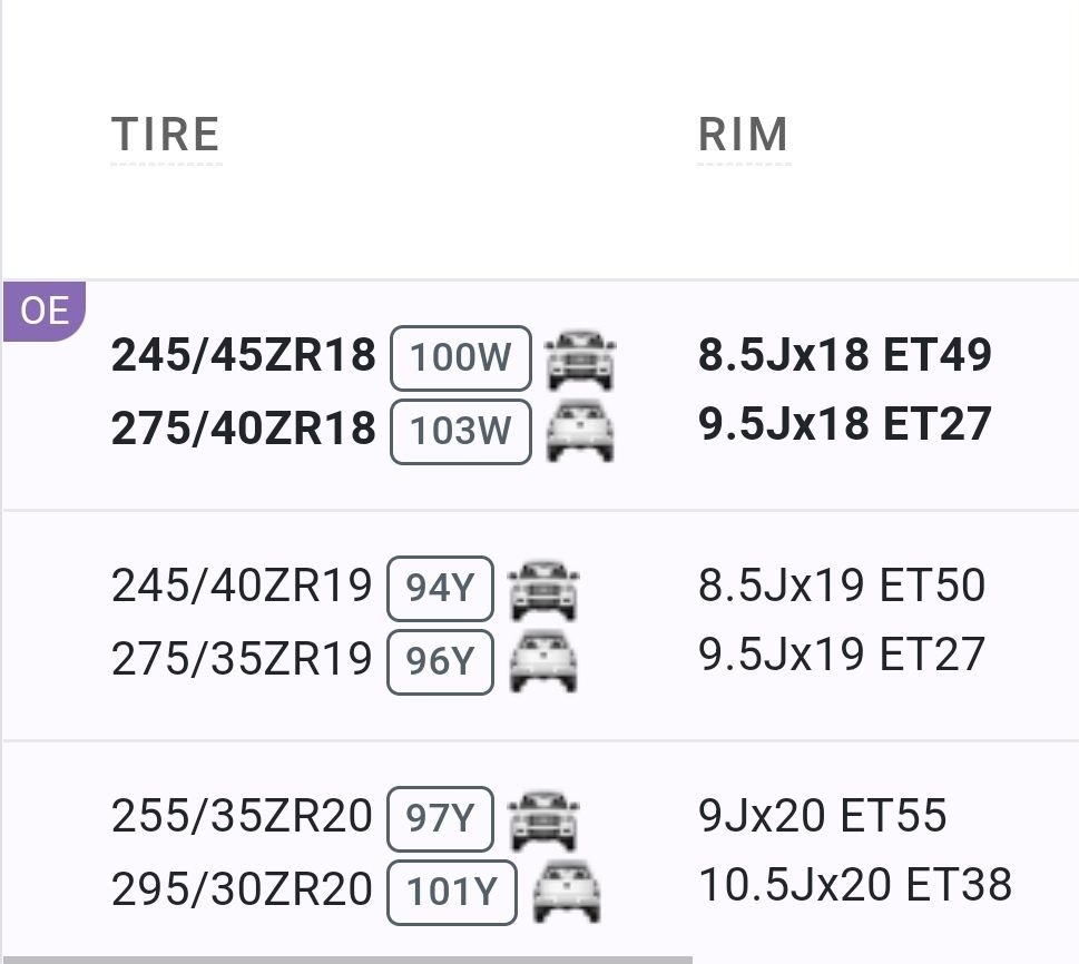

Here is a site that you will find useful.
Here are the OEM offsets for the various wheel sizes available on the V6:
thanks. So 50 front and 27 rear. Will the numbers I mentioned work or do I need to find these numbers exactly

Another wheel fitment site that lists original specs is:
https://www.wheel-size.com/
HTH

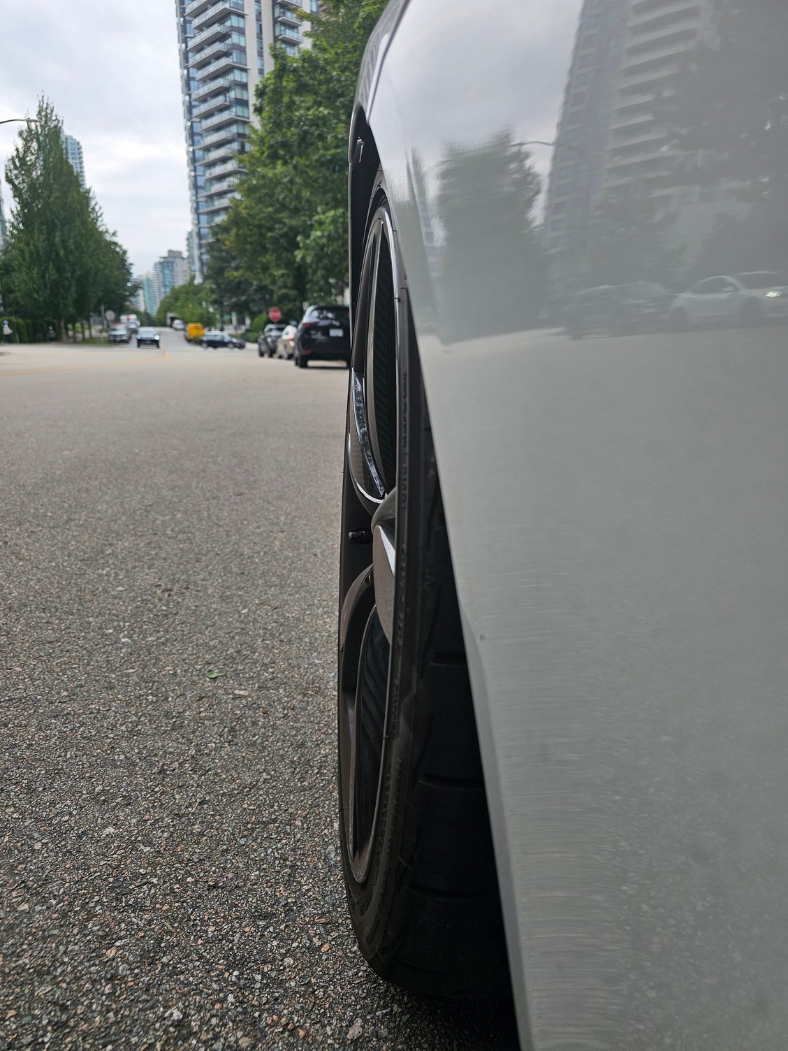

Anyway here's a picture I took yesterday:
Left side, looking towards the front of the car. 255/35r20, 15mm spacers, camber -2.0
I think there's another 5mm there?
