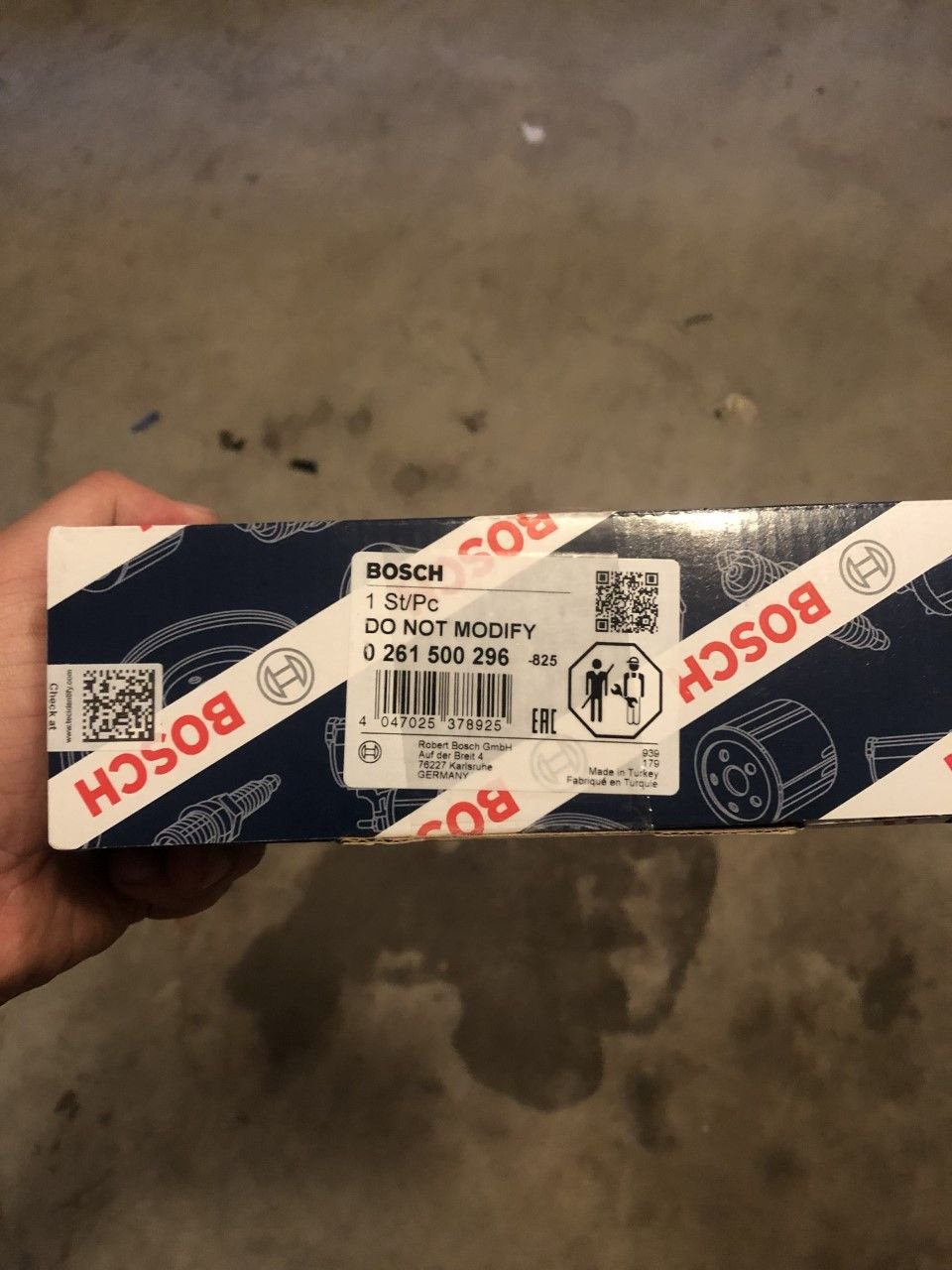

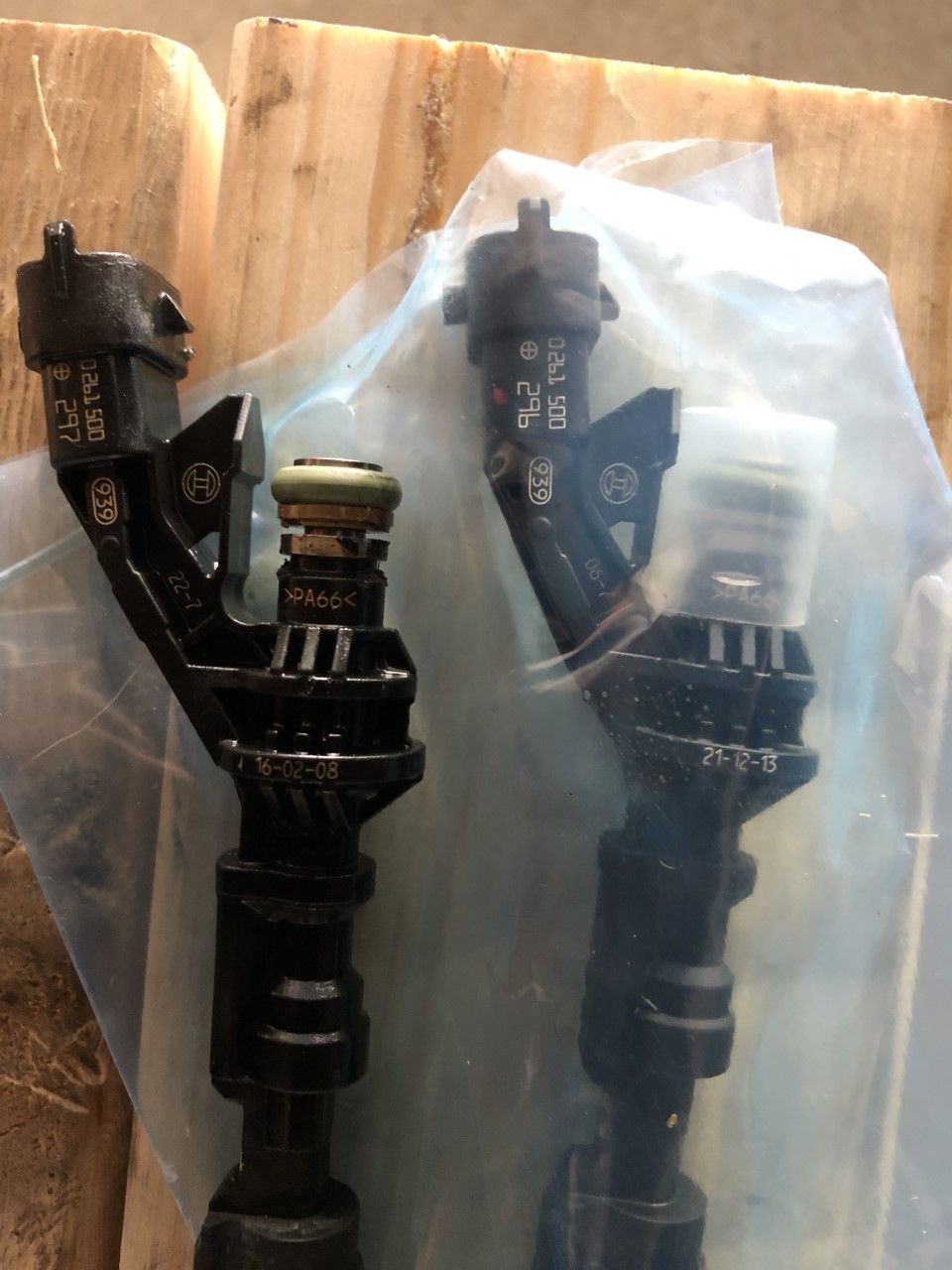

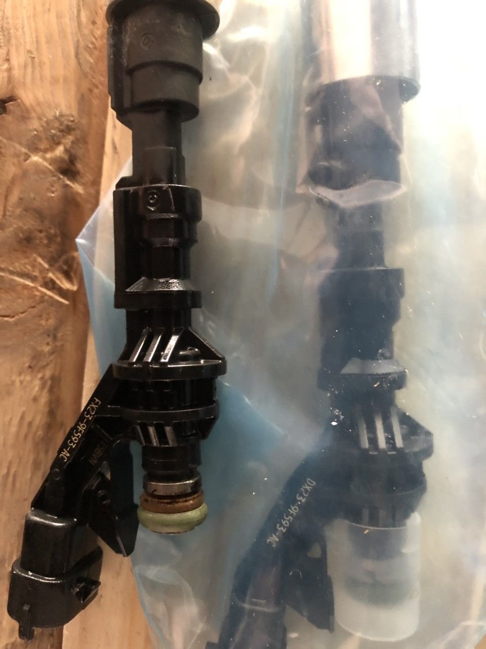

For anyone who needs these, the correct JLR part number is C2D55182. It also corresponds to the Bosch part number 261500296. You can also correlate the serials on the injectors themselves. In this case, the originals were FX23-9F593-AC. I called several places and found one of only a few in the US that carries these injectors new. It appears that Bosh may have made these solely for JLR and as such from what I can tell, only JLR overstock and oversupply places near import centers (Miami / LA) have them in stock. The place I purchased from cross-referenced my VIN to verify the new injectors were correct. In this case, they were off by a serial only: DX23-9F593-AC. Perhaps it's an earlier revision or something, but after installation and clearing codes the car runs normally again. The car is tuned (VAP Stage 4 -e85). Oddly enough I was only able to track this down by using the LandRover crossover part number: LR105431. Pictures are included to help guide you.
