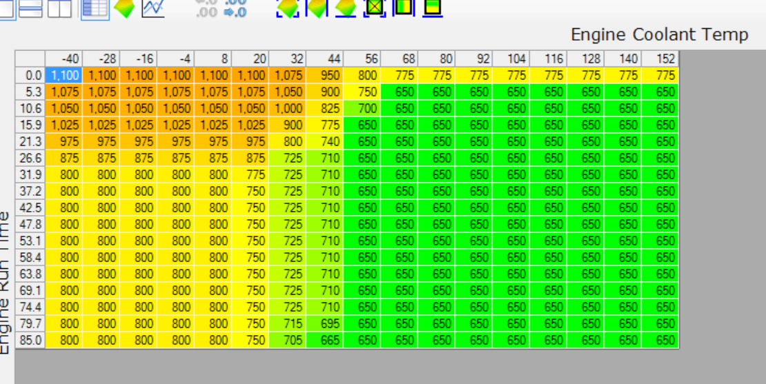

I can show you a pic of a typical (not Jaguar specific) cold start idle table. The computer chooses RPM from the table based on the startup coolant temp. Then the program is designed to run for specific seconds, but as the ECT changes (warms up), so does the run time and the RPM found is a specific cell. A slang way to put it - the ECU starts at a point on this chart, then "runs the table" until operating RPM is reached. In this particular tune, 650 is operating RPM.
The page of the tune right above this one that gives access to this table is this one:
The sub category - Startup Idle RPM shows two "bubbles" that produce a data table like the first pic. The first pic, in this case, is the P/N table.
These can be accessed by a tuner. I have to say, I've never changed these startup idle tables in a tune and would have a hard argument with an owner if I was pushed to changed them when I was tuning. My advice is just let the tune do what it does...all legitimate.

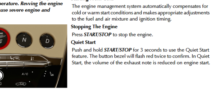

I have this in my car. It does work and listed in the owner's manual:
What year is your F-type?
Old Aug 14, 2025 | 06:50 PM
eeeeek's Avatar
Joined: Jun 2018
Posts: 1,618
Likes: 754
From: Granite Bay, CA
It isn't. That's an Aston Martin.
