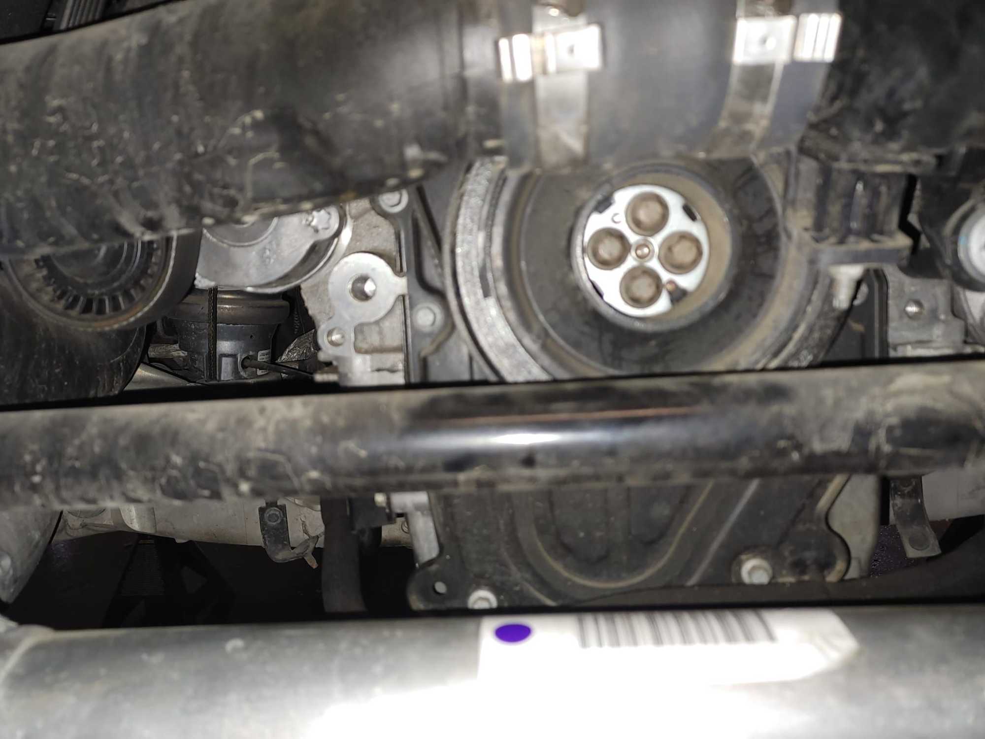

Hey everyone! I recently purchased a 2019 Jaguar F-Type P300 at an auction—my first four-cylinder Jaguar ever. I thought it was a good deal to fix up and possibly sell, but it turns out I might’ve made a mistake listening to a “friend” who claimed there was no mechanical damage. Once the car was delivered, I found out it doesn’t move at all.
I’ve since done a deeper inspection, and the car is in worse shape than I expected. The battery was stolen, and the driver’s seat airbag is missing too. On top of that, there’s no oil in the engine! I just found out the oil pan is damaged
. Apparently, the car was serviced at a Jaguar dealership only about 2,000 miles before it landed in the salvage yard, so I’m hoping there’s still some life in that engine. My next steps are to check whether the engine is seized and look closely for cracks or other damage.Right now, I’m focusing on the crank pulley area. I removed the radiators and everything else in the way, but this is my first time working on a Jaguar (or any 4-cylinder, for that matter), and I noticed the crank pulley doesn’t have a center nut the way I’m used to seeing. If anyone has experience with this setup, I’d really appreciate some guidance on what to do next.
Finally, if anyone has insights on the potential resale value once I get everything sorted, I’d love to hear your thoughts. I’m pretty determined to fix it up, so I’ll keep sharing my progress if you’re interested. In the meantime, any advice, tips, or tricks you can offer would be super helpful. Thanks in advance!

Do you have any idea how to move crank pulley without strap wrench? Because thats my last option

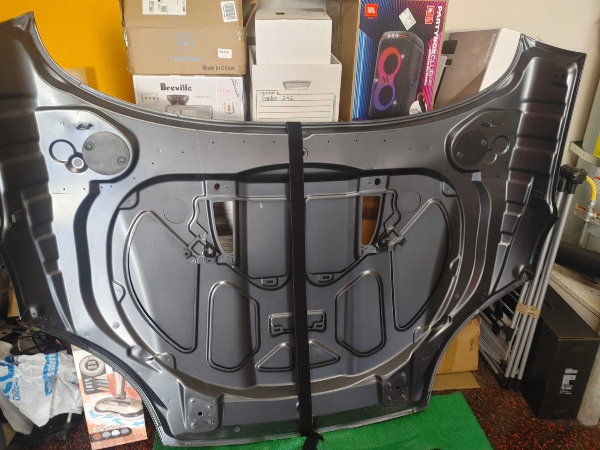

P.S. I would like to sell a bumper cover and a bonnet. How much do you think it worth it?
