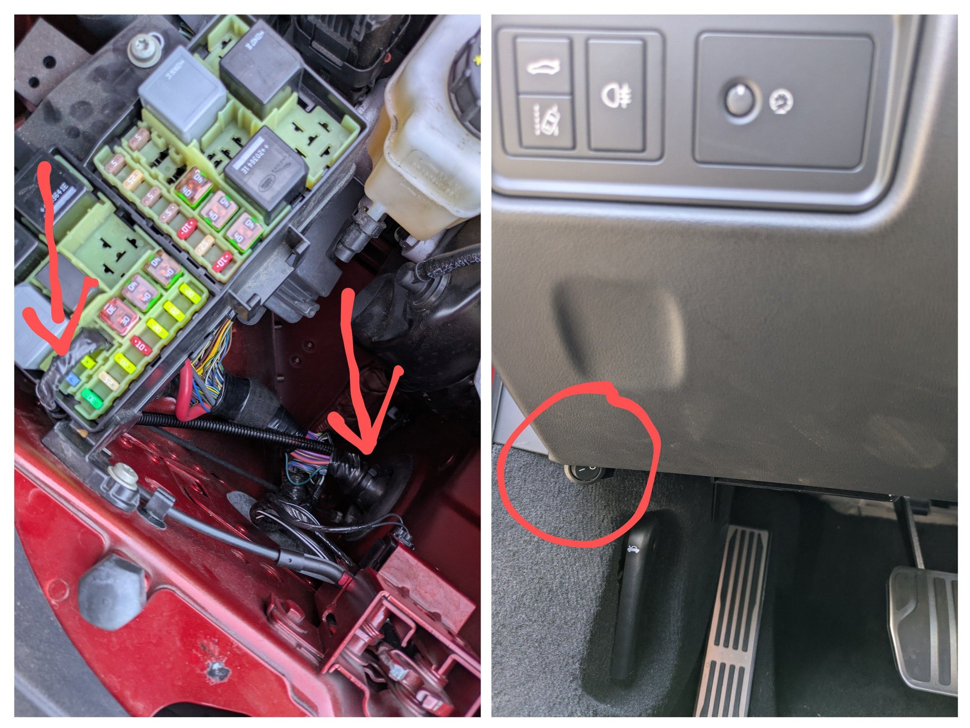

My Take on the #15 Fuse Mod (2021+ F-Type R)
Pulling Fuse 15 definitely brings back some of the fun that makes the F-Type exciting. It only takes a couple of minutes to pop the hood and pull the fuse, but I wanted a cleaner and easier way to do it.
After checking out a few options, I went with a simple wire bypass switch instead of a remote setup. It’s more stable, easier to install, and doesn’t need any extra power supply.
Install Notes:
  • Pretty straightforward overall.
  • The only tricky part is getting the wire through the firewall. The best spot I found is just below the fuse box.
  • By carefully removed the protective tape and fishing the wire through a small opening on the firewall. Once that’s done, the rest is simple.
  • I temporarily mounted the switch just below the dimmer switch so it’s easy to reach.
What It Does:
  • When the switch is OFF (fuse disconnected), the exhaust stays fully open. You start hearing more sound around 1500 RPM, and between 2500–4000 RPM, it gets louder with more pops and crackles.
  • The best part is the downshift from 3rd to 2nd—it gives off a loud “pop” (gunshot). It makes me smile every time (yeah, I know it’s a bit childish, but it’s fun).
  • When the switch is ON (fuse connected), everything works like stock. You can still use the sport exhaust button, but it’s much quieter than with the fuse off. Great for long drives when you want things more chill.
One Small Catch:
You can’t flip the switch while the engine is running. From what I understand, the exhaust flaps only fully open when the car is off. So you have to decide if you’re in a “nice” or “naughty” mood before hitting the start button.
Just wanted to share this with other 2021+ F-Type R owners. The switch cost me about $20 on Amazon, and the install just took a bit of patience. Totally worth it—it makes the car sound way better.

Originally Posted by dosomethingforty
One Small Catch:
You can switch it while the engine is running, but only while it's at low idle and you're in park (or neutral). The valves will be closed if your active exhaust is off. Switch the active exhaust on at low idle and the valves will fully open. Then throw your switch to disable them in the open position. You can throw your switch to 'reinstall' the fuse at any time without consequence--the car will position them correctly based on the mapping.
Also, the electronic valves on the '21+ F-Types are binary--they are either open or they are closed. There is no partial opening. The electronic valves in the F-Pace do have variable opening settings.
Thank you Thunder Dump. Good to know, and I will give it a try.
Thanks again.
