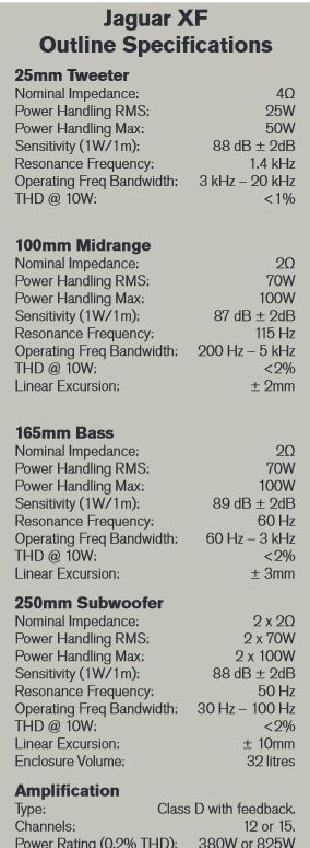

Working on a fix for the tweeters now with a crossover system.. I will be detailing the install, parts and setting used.. I will be using a crossover in line with the Meridian tweeters. Found the OHM's and Cutoff frequency from the Meridian site and will apply their settings (even though I feel they should be different than 3K and above to the tweeters) but to be consistent with the original tune I will leave it this way. Waiting for the gear to arrive then will post back. Stay tuned
Cool... Where did you find that info? I didn't find it. Can you post the link?

I couldnt find one for the F-type (of course) but meridian seems to be using all of the same components based on diameter and outputs. The different wattage around brand and models comes from adding additional speakers for the extra space in the other cars. If you look at the XJ and XF they obviously needed to add rear seat and deck speakers. Using this guide I will tune according to Meridian spec and not my ear so we can have a standardized test and who knows maybe then it will actually sound like we all expect it to
Attached Thumbnails 770 Meridian Sound System - Speaker Question-meridian.jpg
Isn't this spec for separate speakers? Don't we have co-axial ones?
