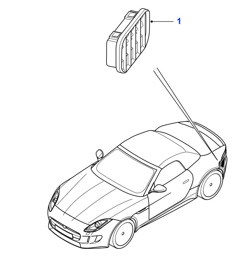

Under the rear bumper on the right side is a vent. If you remove the vent on the right side you can reach the emergency handle.The bumper is going to be the hard part, there is one bolt in the trunk (top centre). Reach out with your right arm.
Vent
Vent
You have to remove the right side, not the left one as in the picture.

didn't find it on the search I did, but I'll take a look at the vent access
