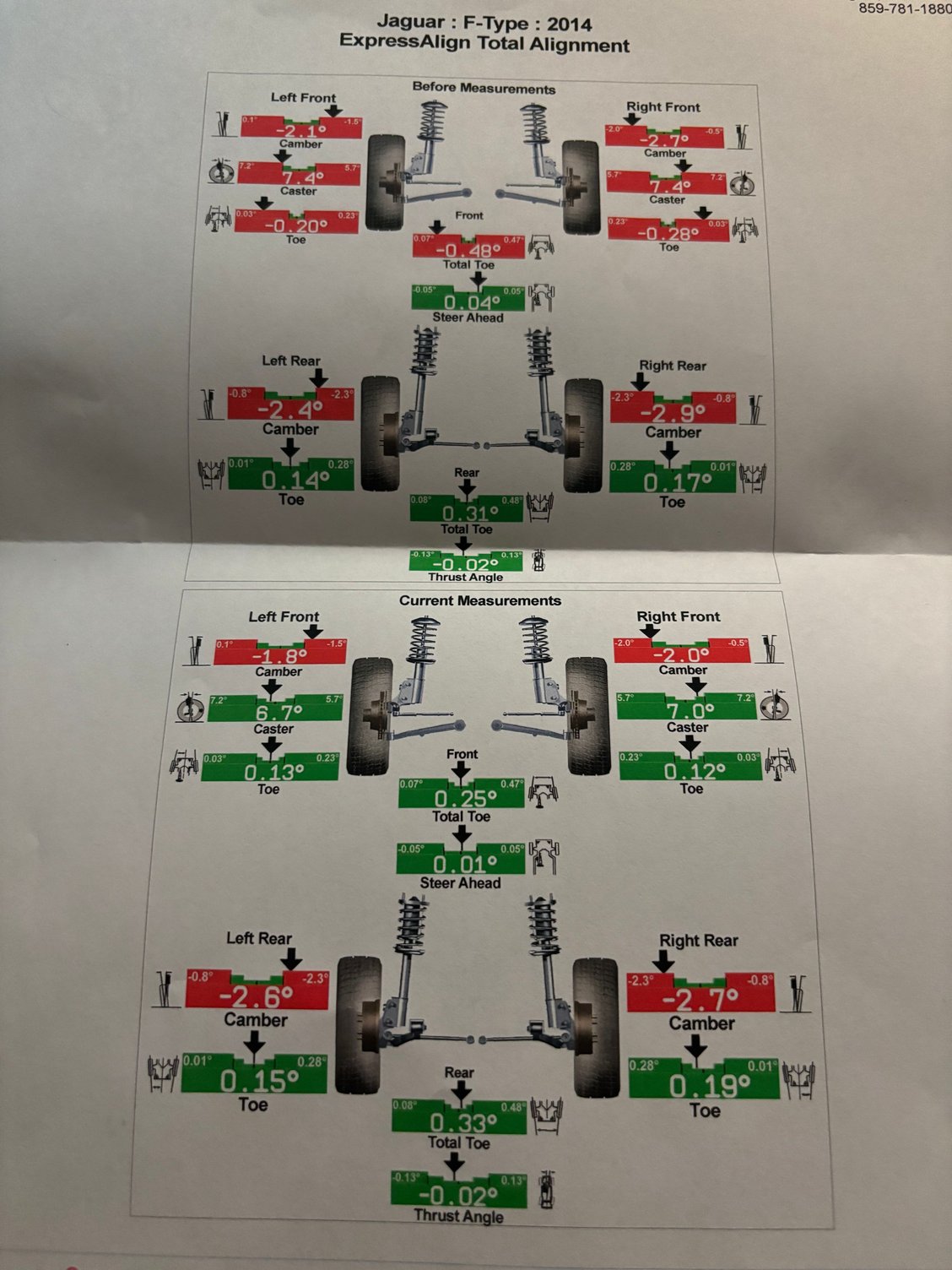

Just got an alignment on my 2014 Jaguar F Type. I just picked it up and after driving about 1 mile I get a Adaptive Dynamics Fault and my car can no longer go into sport mode. If I restart the car I can put it into sport mode for about 30 seconds and it pops the fault back up. Could they have left the car on to long and drained my battery? Or is it more likely they went out of Jaguar specifications for the alignment and it's throwing faults? ( It was done by a reputable independent ) I have a code reader and no codes are displayed.

Here is my alignment info. If anything it was way off Jaguar specifications before and there was no error.

Found the culprit. They snapped the front right side height sensor somehow. Sourced off Ebay for $55 will be returning tomorrow for them to pay for it.
