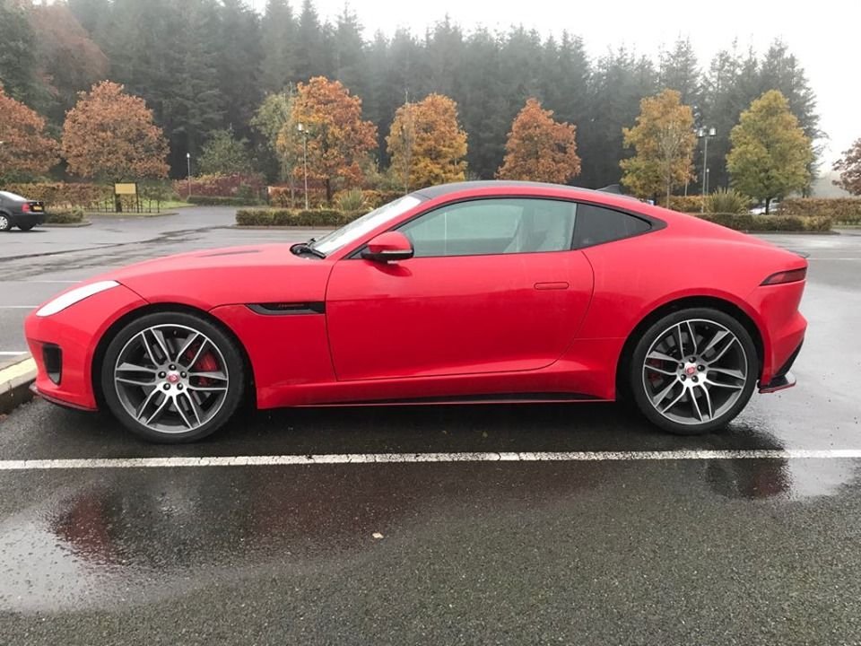

So it can be done, Eibach springs on the 2.0 and I love the look, the 3.0 option fits no problem, just a lovely gap left front and rear, 15 mm spacers on and 305 rear and 265 front, no rubbing or issues, got alignment done also, the ride, well cant feel any difference really, easy to fit around 3 hrs work,the lighter engine didn't seem to effect the drop, still sits lovely,rotten wet day so will get better pics done, last pic is the car on factory set up big difference

Nice. Glad these worked out for you.

+1. Thanks to the OP for pioneering this.

Thanks Jaggyx for lots of info prior to my modification, very happy with the result, wouldn't want it any lower.
