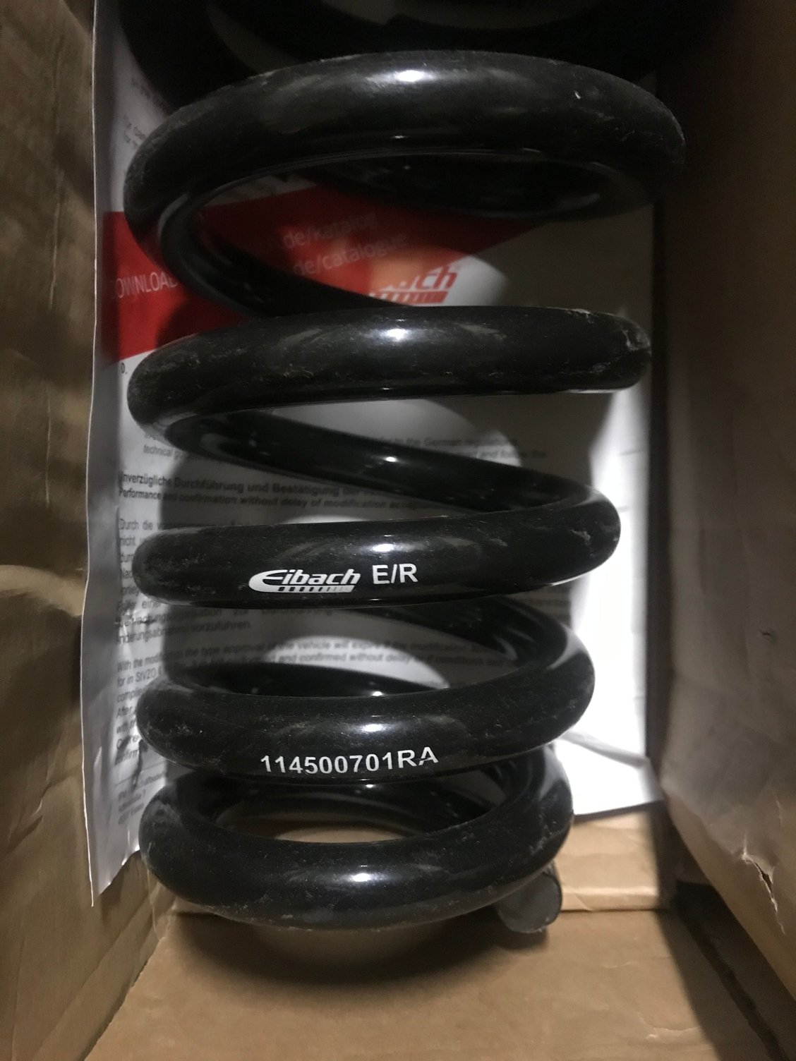

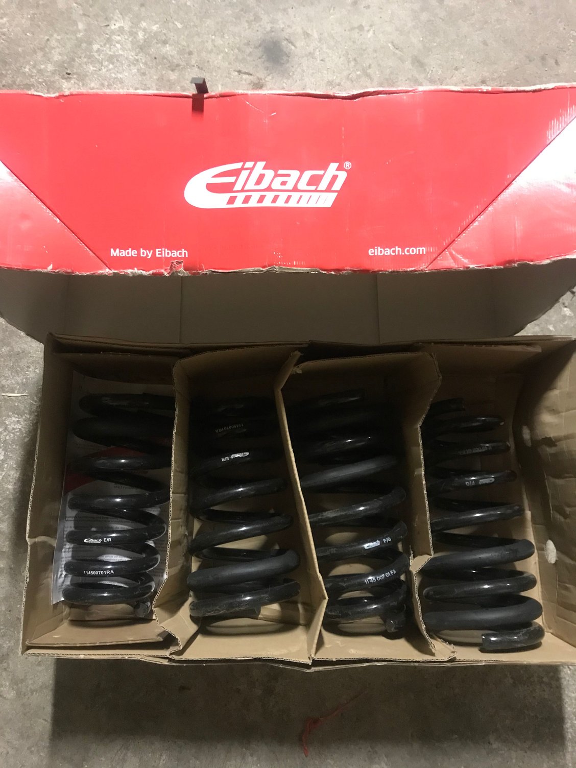

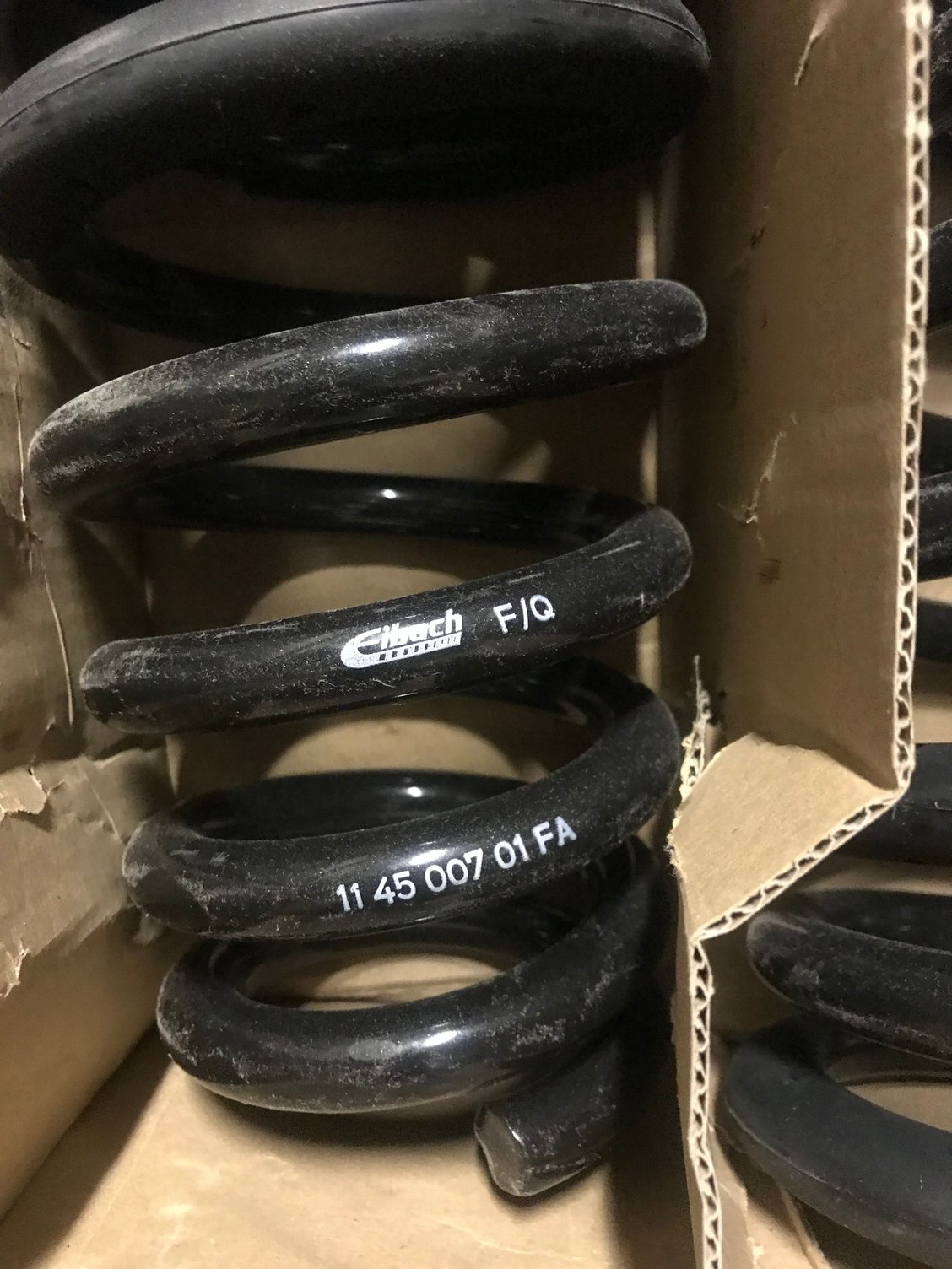

Eibach springs arrived today, fitting tomorrow, none available for the 4 pot so going with ones for the 3litre V6, will they fit hell knows , rear might be ok , may have to trim the front spring to get a bit lower due to engine weight.
