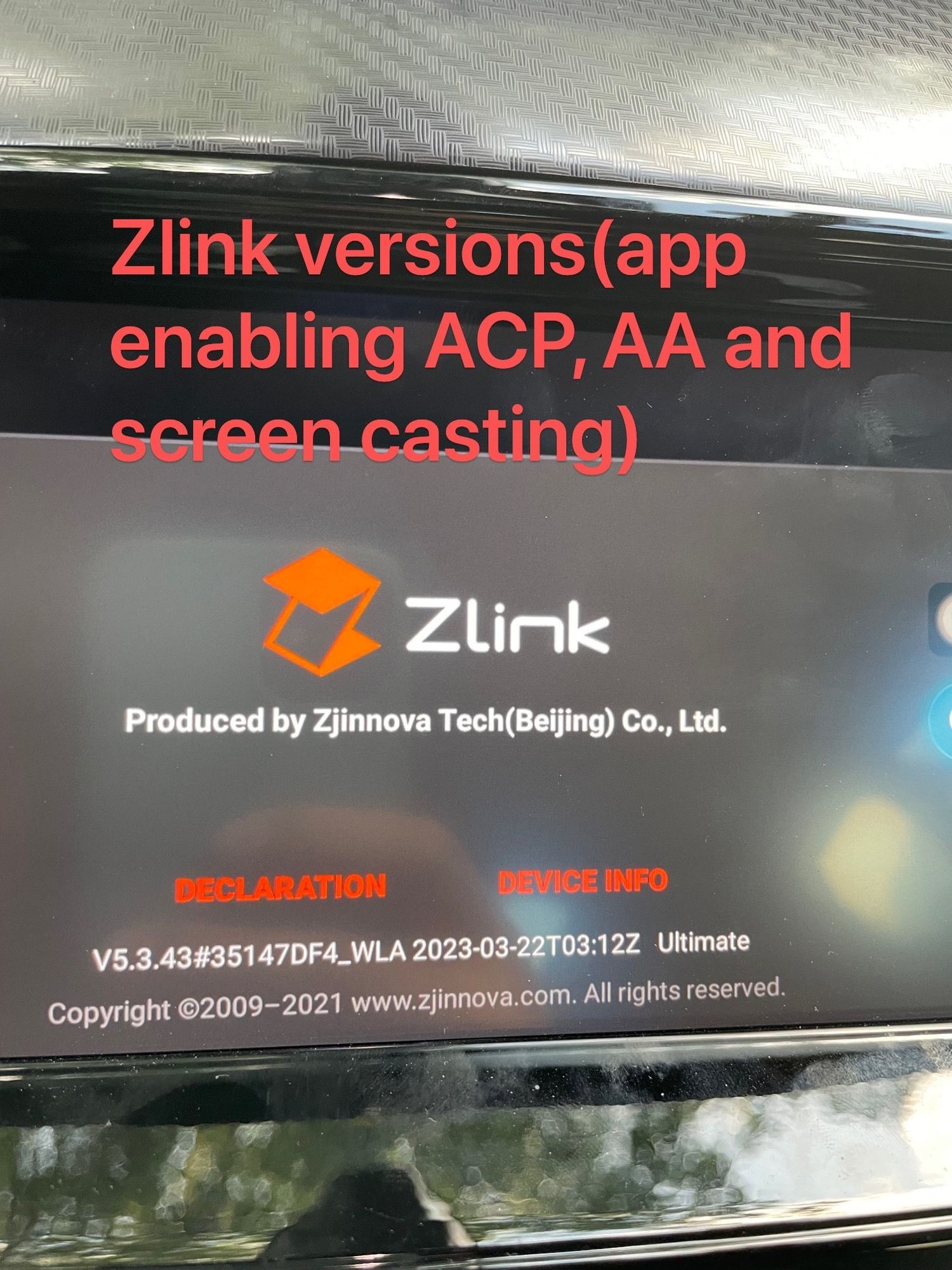

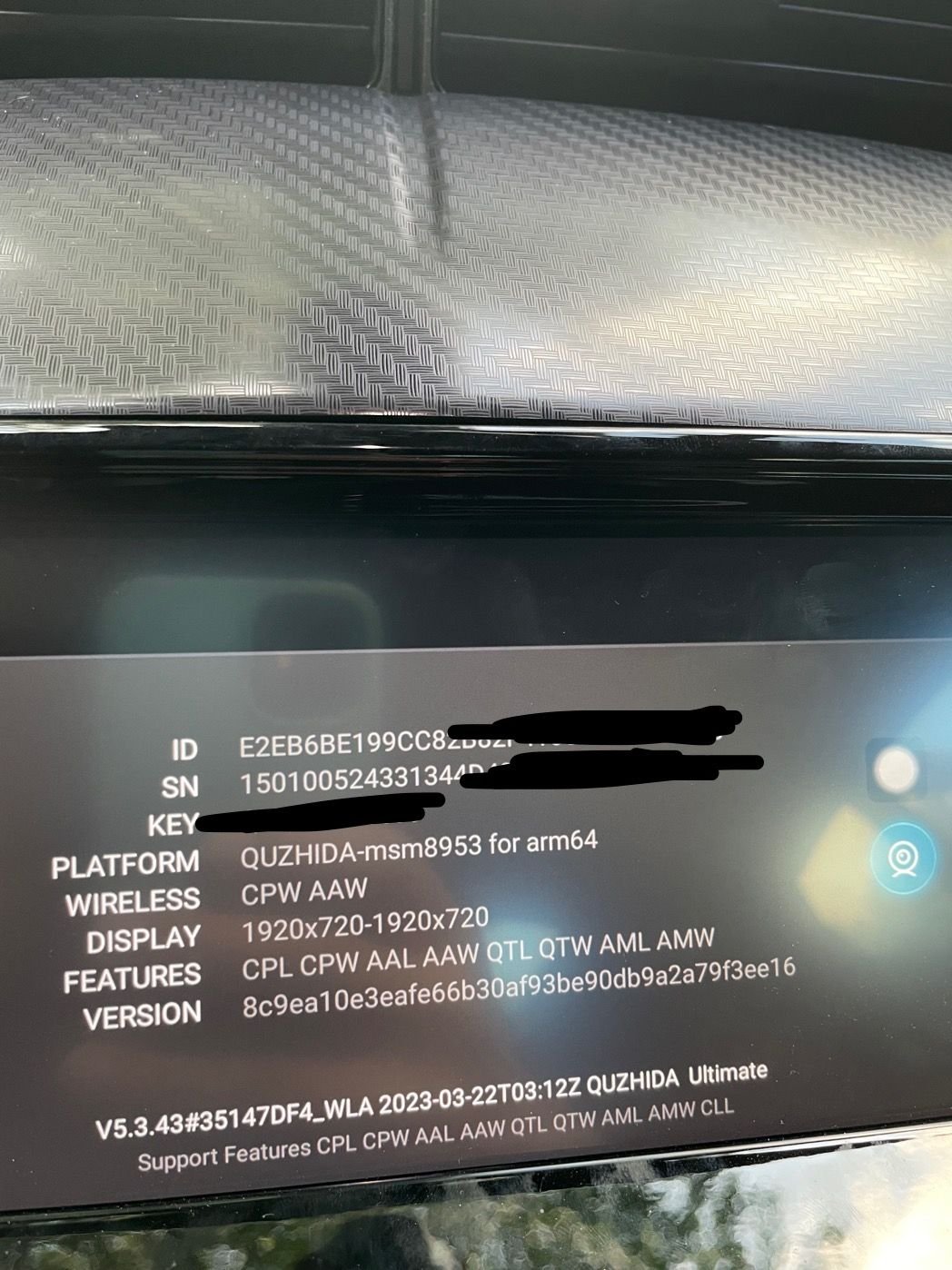

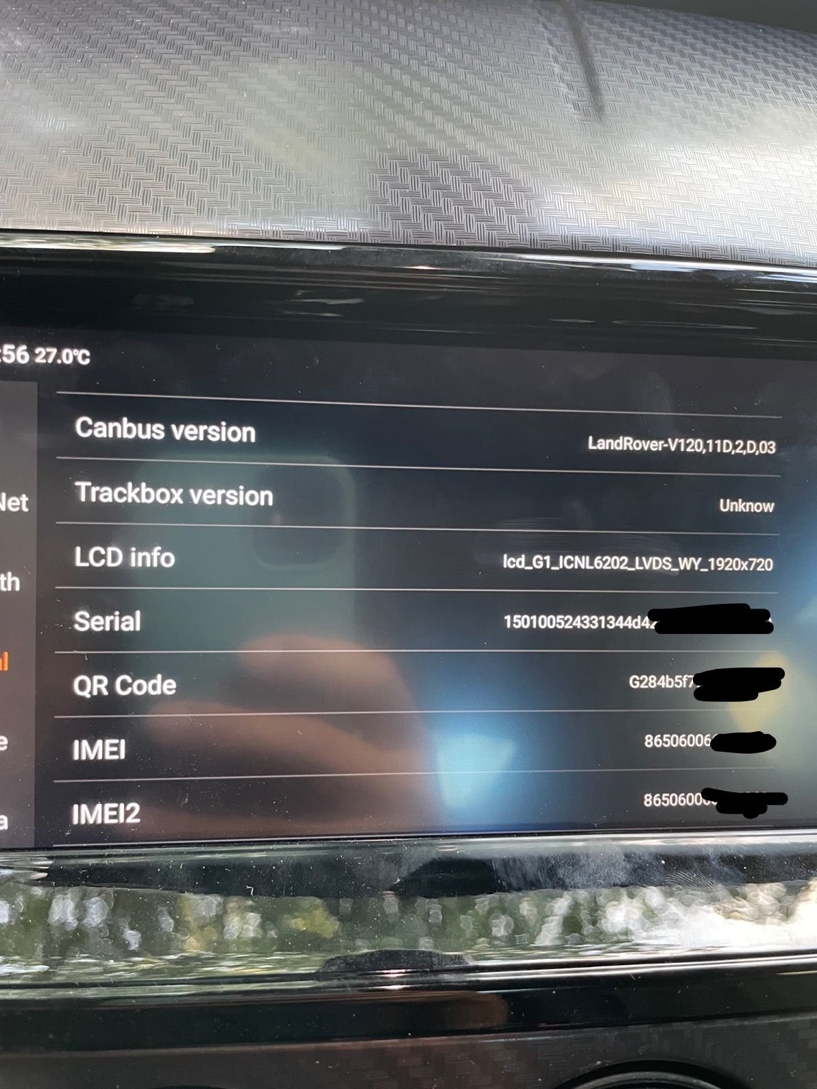

This is an Android 11 based headunit for 2013-2019 F type with small screen, manufactured by merryway. Soft and hardware version attached below, I believe this is the latest unit on the market.

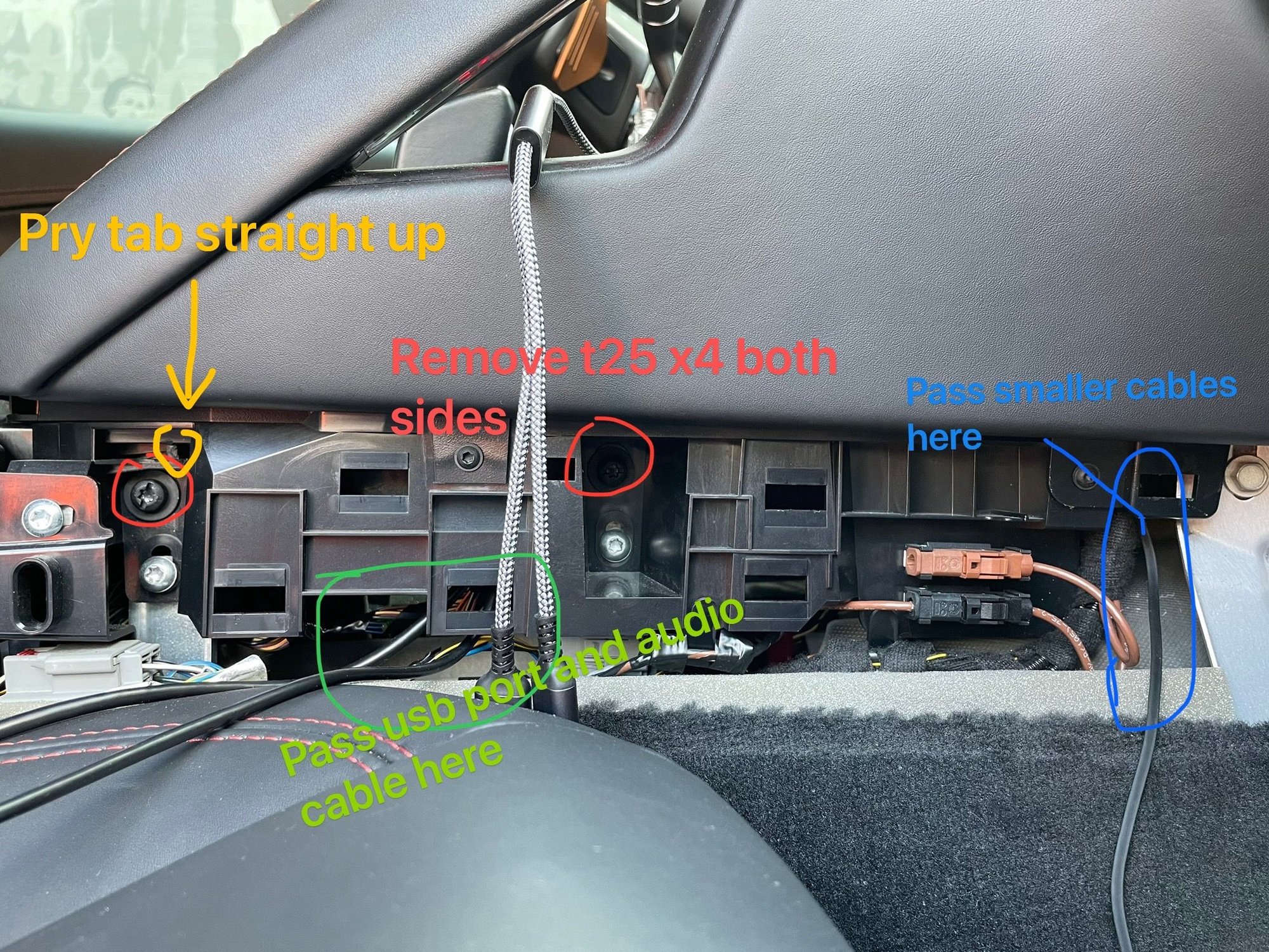

the usb port and audio passthrough is too large to pass through the opening on knee pad, so instead I pulled the gear shifter assembly and feed them underneath it and out on the side of the knee pad, to the back of the bluetooth unit.
How to pull the gear shifter assembly you may ask?
remove 4 t25s circled, BEFORE YOU DO ANY LIFTING, using a flathead screw driver, push the tab circled upward towards the roof of the car to dislodge it, DO IT ON BOTH SIDES BEFORE YOU EVEN THINK OF pulling the unit in any way.
These tabs will bend and plastic deform if you tried to lift it from the front side making things needlessly hard.
Once the gear shifter assembly is free, feed your USB port and audio cable underneath and out from the side of the knee pad. Clearance is very tight, you may have to juggle the wire a few times before you are able to seat the gear shifter back in. It's also a good time to remove and clean up your sticky buttons.
You're all set at this point, once you've confirming everything works, put all the trims back and enjoy your new head unit!
