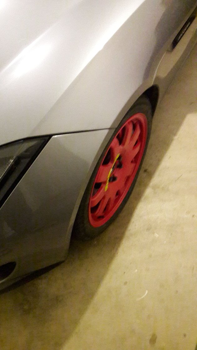

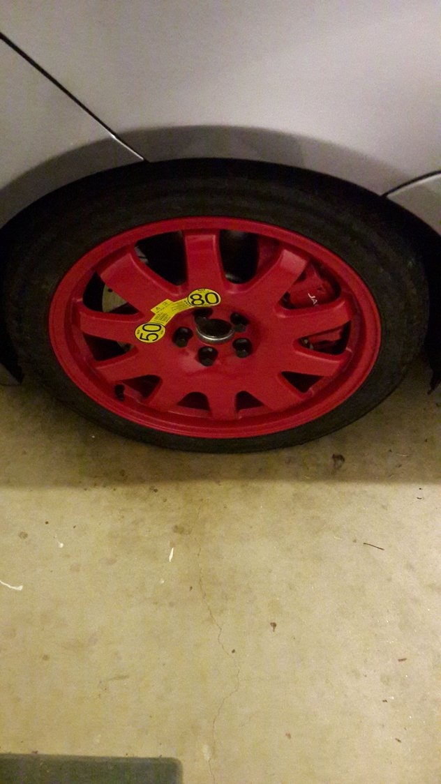

Here's a couple of pics of the spacer saver on the car.
Not great as it's in my garage at night with no room to back away and crappy phone camera.

Glad it (finally) turned out safely. Changing a tire on a busy highway is STRESSFUL even without waiting for hours.
Gotta say, I like the red wheel better than black wheels. You need 3 more!

Something that never occurred to me - I have a bright red space saver in the XE. That might fit on the F-type?
Maybe, maybe not.
The F-Type space saver is a 19" version specifically to fit over the 380 mm front brake calipers, but I don't know what size the XE version is.
Easy enough to have a squiz at it to determine the size, and if it's 19" it will probably work on the F-Type but if it's only 18" I'm pretty sure it won't.

Good point. Might fit on the back (325mm for me), unlikely on the front. As I have 18” wheels on the XE, I doubt the spare is 19”.
Originally Posted by OzXFR
Maybe, maybe not.
I suspect Jag offers just one size spare regardless of the wheel size delivered on the car. The tire sizes are established to maintain the same outside tire diameter regardless of the wheel diameter. It’s possible they use the same spare across all they’re cars. (SUVs not included).
I pondered the same thing. Confirmed it’s an 18” space saver in the XE.
OK... won’t work on the super performance brake package.

DJS's Avatar
DJS
Posts: 6,989
Likes: 2,663
From: Metrowest Boston
Even if it fit on the rear of my high-performance brakes, the tire is a different diameter, which I doubt the LSD would like. Seemed like a nice idea, until reality intruded.
