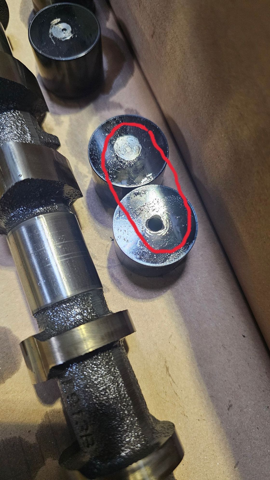

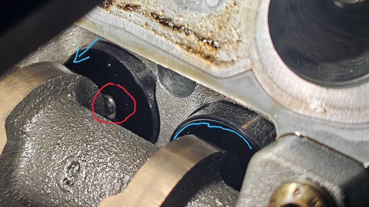

I had been hearing a loud engine tick and finally got it diagnosed and will be repaired under extended warranty next week, i have a 2017 R with 50500 miles on it.
Several of my tappets show signs of wear, see attached pics. I haven't really been given a good explanation of what could have caused this, but i have definite valve damage as well due to one of the values piercing the top of one of the tappets - this tappet moves freely and i assume is the most significant contributor to the tick i am hearing!!

I haven't been told that valves need to be replace aside from the one that has contacted the piston and pierced the tappet...
