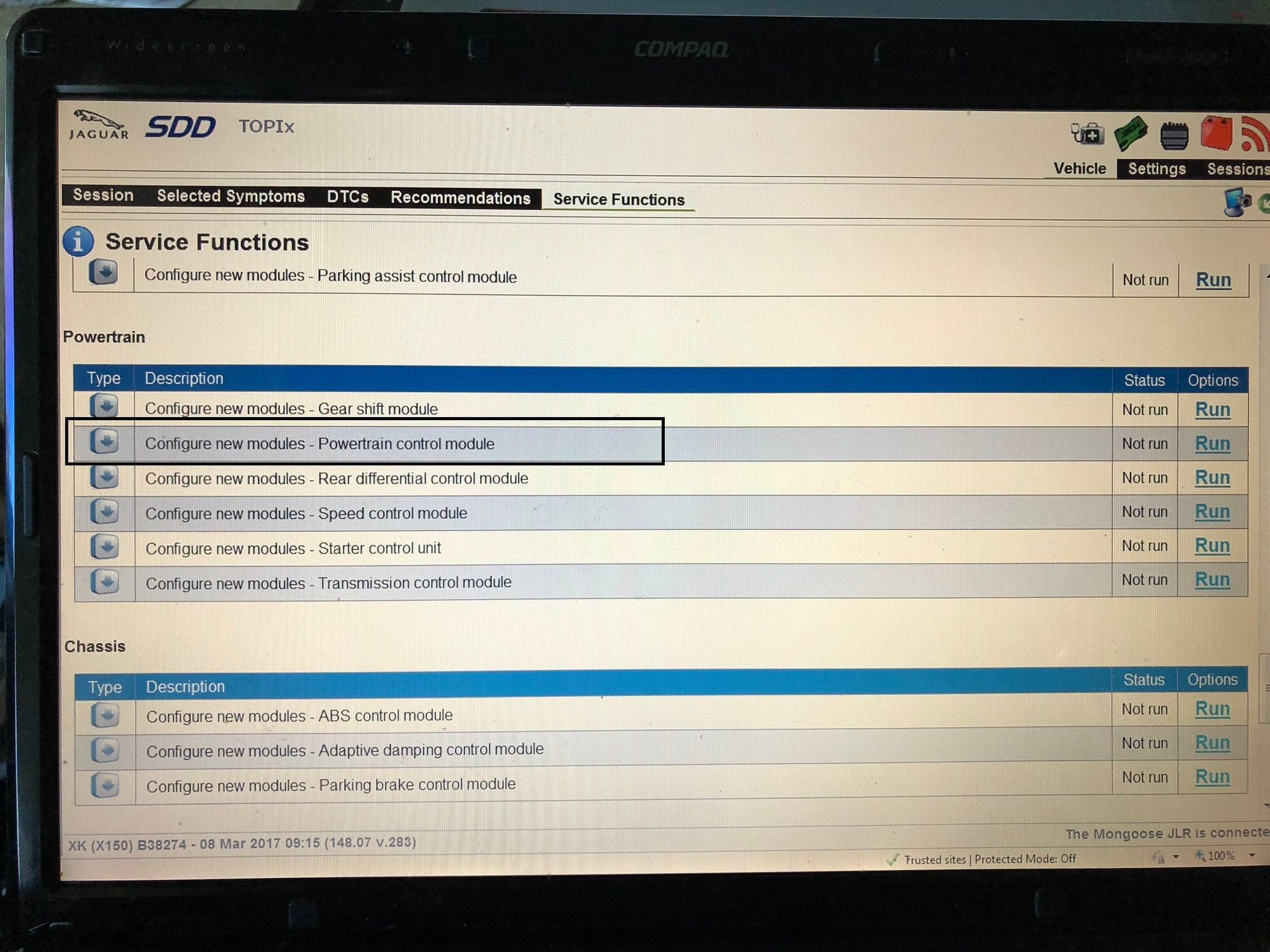

u102768 can you explain any on reloading the stock tune using SDD? I have a tune from VAP and have gone back and forth several times from stock to tuned but always using VAP's tuning tool. I did not know it was possible to get it all back to stock using SDD? That would solve the OP problems too!
I can tell in SDD that the car has been tuned as it is recorded how many times the PCM has been flashed.
Old Jul 29, 2022 | 04:06 AM
u102768's Avatar
Joined: Jan 2010
Posts: 2,941
Likes: 1,511
From: New Zealand
I have never used one but from what I have read on the forum I get the impression that if you have a VAP tune you have to use their tool to switch back otherwise you will lose the use of the tune.
In the case of the OP using the 'Configure new modules - Powertrain Control Module' option in SDD should put the PCM back to factory standard:

U102768 thanks for the instructions. Yes I don't know what would happen if I over wrote my VAP tune using SDD? I guess I could then reload the VAP tune as the car would be once again stock.

If you overwrote the tune with SDD your handheld device would refuse to reflash the VAP tune. If there is a possibility for updating firmware during service (with SDD), reflash to stock first. If it were possible to reflash over stock when the device remembered that the non-stock tune was last applied, an unscrupulous shop could buy one tune and flash it to multiple vehicles.
The dealer should be able to restore the original file, so I don't understand why they won't. There is a possibility it could brick the ECU, but they should note that as a risk rather than refuse to do the work.
