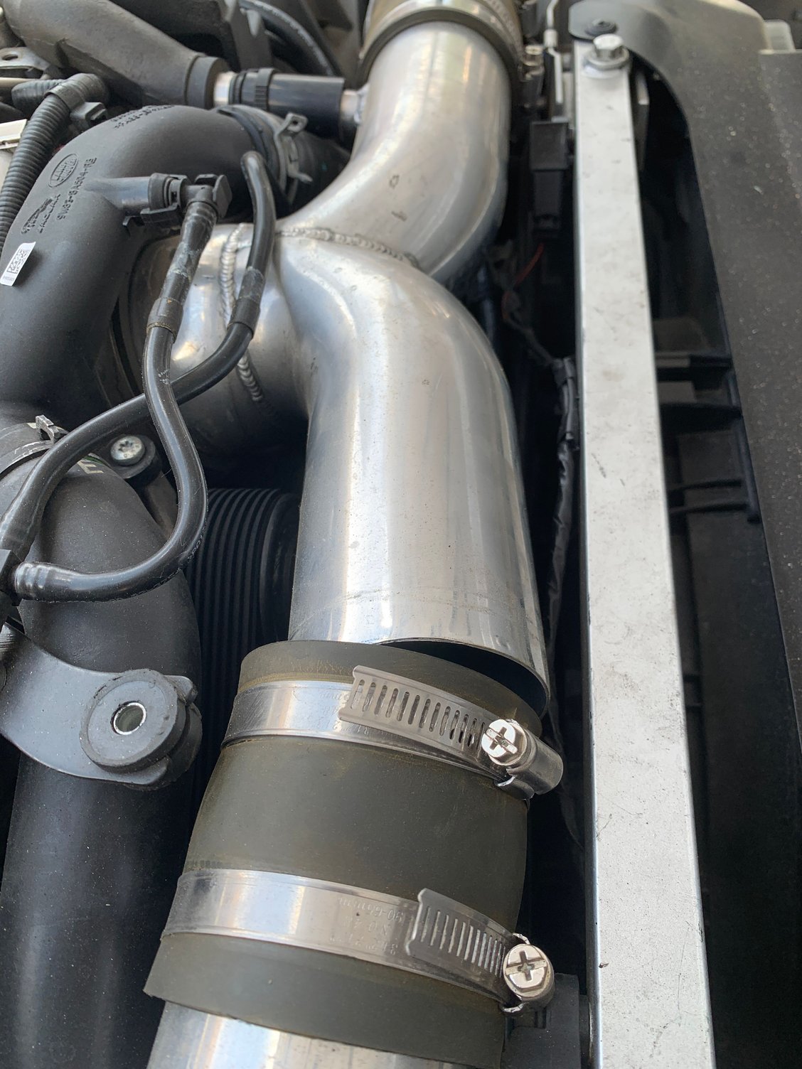

I actually don’t blame them. The install on your intakes is pretty poor. The left arm (when looking from the drivers seat)is parallel to the brace infront but the right arm there is about 15 degrees on angle. No wonder that joint failed. Because of the angle it enters the sleeve , the ring clamp will never get a good seal and will eventually work itself off again.maybe a new sleeve with another extra inch of length may suffice. It looks like there is quite a big gap between the two ends of the intake pipes.
Agreed, the angle of the RHS pipe is all wrong and the only easy solution is to get a longer piece of silicone hose to replace the too short piece on the RHS.

when I got back to the house I opened the hood and took a look to see if I could see what they heck they were talking about regarding the intake pipes. Well… I saw it…. And I am pretty sure I can fix it, which also means they could have as well.
You realize with that connection unsecured you are sucking unfiltered air directly into the engine intake/throttle body. I think you are also bypassing one of the MAF sensors.
This is 100% on mark. Now that the engine has been sitting overnight and it isn’t 100+ outside I can get a better look/feel. I can at least get the rubber sleeve over both sides. However you are right that it will eventually slide off again. Other than getting a longer section of tubing to overcome and well… it will look like trash but work until I can get to a shop that can pull the hood off to get a better angle and take that tubes off the super charger and see if it is bent, made incorrectly or just needed to be turned a little to be more even.

So I managed ti go out and correct the issue rather simply. While it looks like the one section of intake leading to the supercharger is out of alignment it was actually an optical illusion. The pipe coming up from the airbox wasn’t in the right position and just kind of fell back into place where it was supposed to be once I loosened the clamp and slid the rubber junction back slightly. Everything realigned and clamped back in properly. Voila! MAF error gone, brake boost error gone, hesitation gone, random cutout at low RPM gone…
