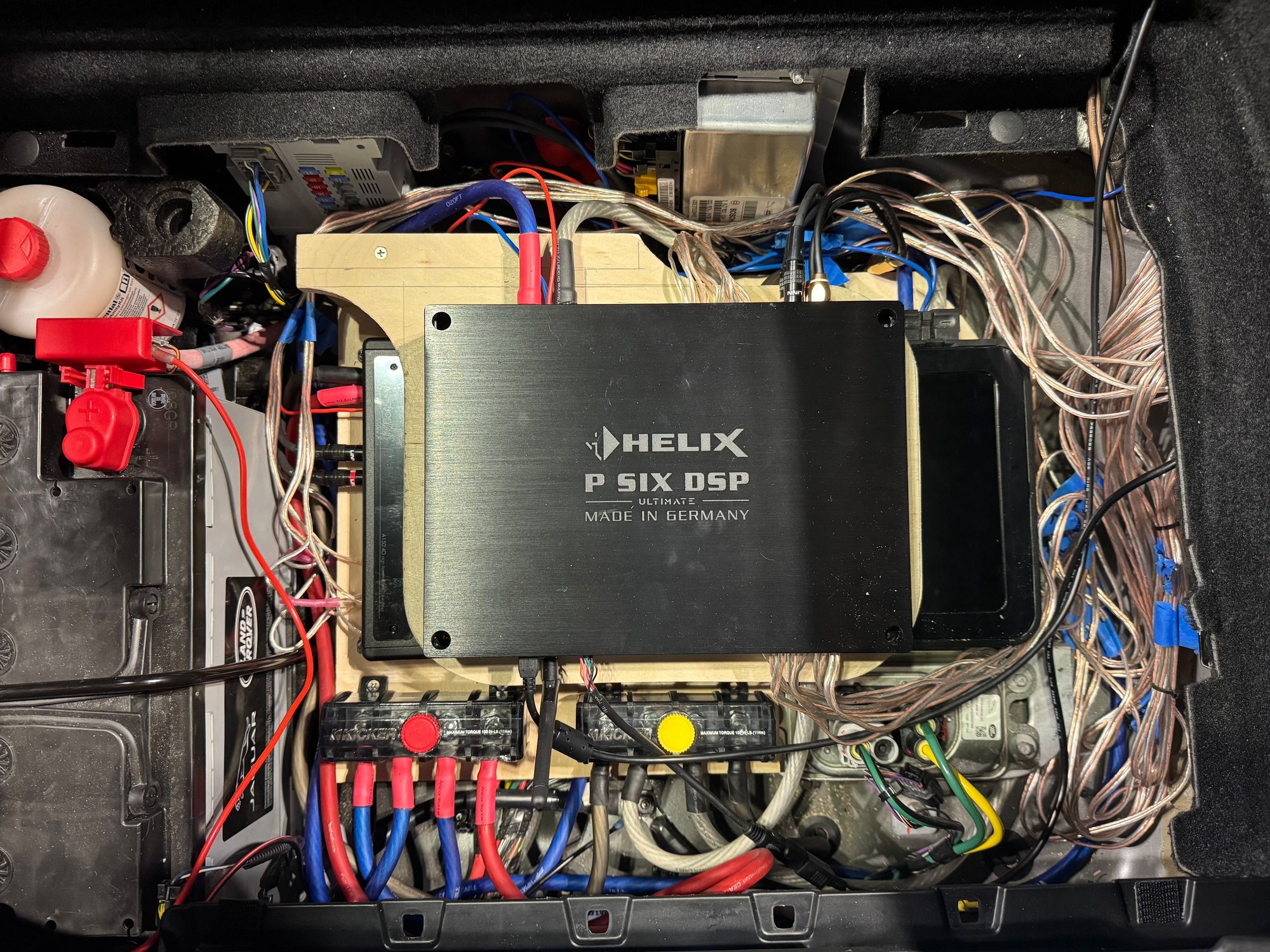

This is on my ‘16. I think JLR moved stuff around over the years. See my ground block? Yellow thumb screw holds on the plastic cover. Just below the yellow guy in the picture, between the two silver colored amp grounds, you can see the car’s grounding lug. The car’s ground cable is black and my ground block’s lead is smoked grey.

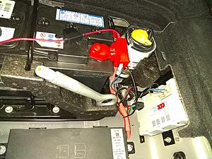

My Jaguar tech advised me to connect the positive on the Ctek to the bar on the battery. I split the black/red wire and then connected the black to an upright bolt that was the ground for the battery. That is located on the floor of the trunk. There are many threads here on the CTek as well as how others have connected it.
