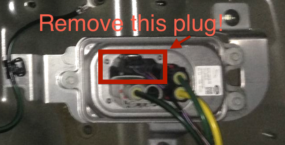

Hi all. I have a 2016 F-Type arriving shortly and it will not be a daily runner. I want to fit a maintenance charger to the battery while I am not using it.
I gather there are two batteries in the car and I am told there is provision for jump starting the car under the bonnet. My question is can these points be used to trickle charge BOTH batteries.

Start/Stop is easily defeated:
While you’re back there, hook up the direct connect leads to a NOCO Genius 1. If you drive a fair bit every week then a maintainer isn’t really necessary but if you plan to let it sit for 4 or more weeks it definitely is.

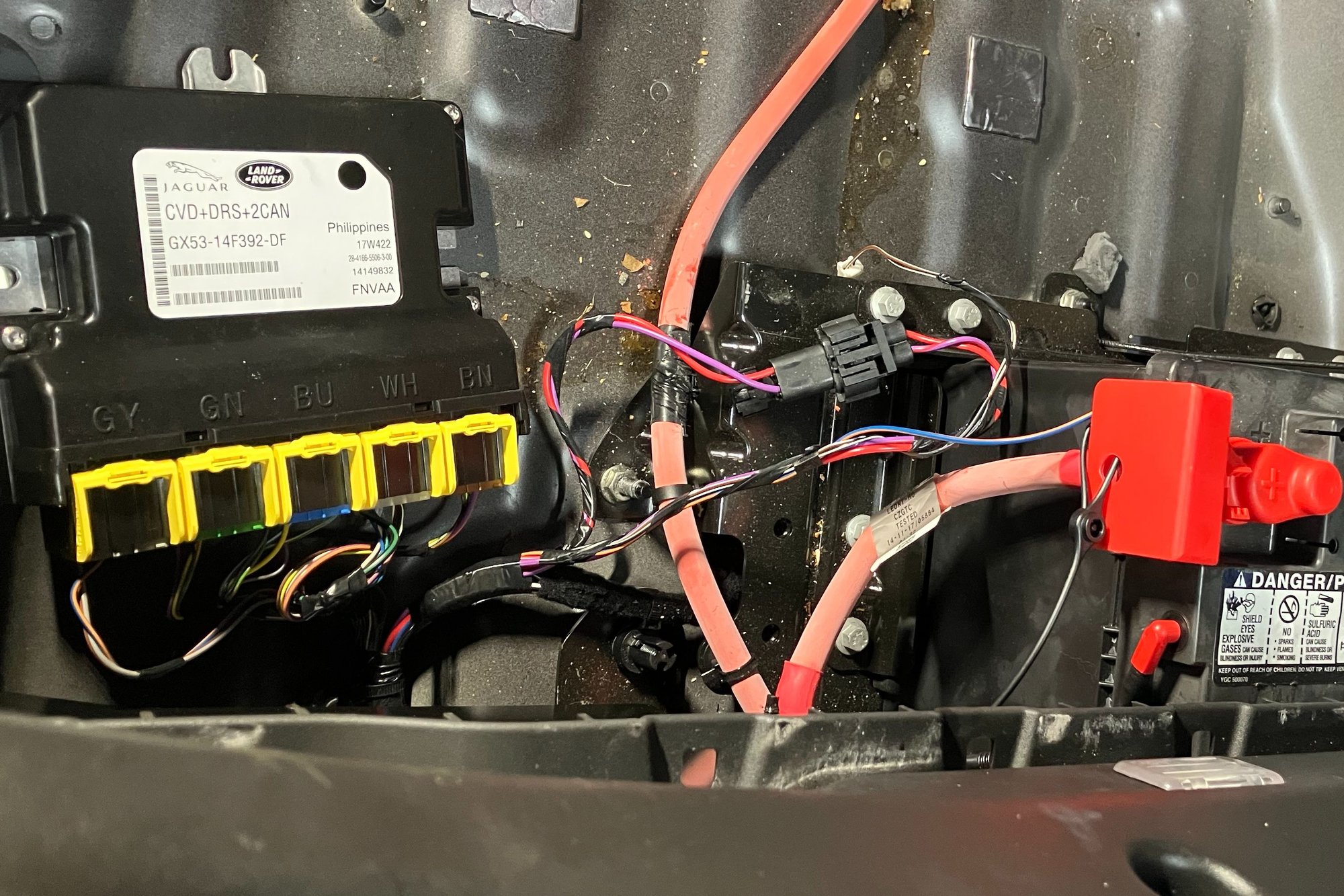

Default 2018 convertible maintenance
I recently bought a 2018 convertible and want to set up a battery maintainer connected in the trunk. Using the jump leads under the hood means leaving the hood open and I don't want to do that. Looking through other posts about battery maintainers has been helpful but my battery setup seems different. There doesn't appear to be anywhere to attach the positive lead. Anybody with a 2018 have a solution? Here's what my battery setup looks like:
Not true - OzXFR uses the underhood terminals and stores his lead cunningly in the wheel arch. He's shown how he's done it on other threads on here, maybe he can point you in the right direction.
Yep, no need to even unlock the car let alone open the hood.
A bit of a hassle to track down the threads/posts where I show how I did it but put simply I hard-wired the maintainer wires/connectors to the charging posts in the engine bay.
Thanks. I found OzXFR's post here:
https://www.jaguarforums.com/forum/f...3/#post1710314
I'll look into that solution.
That post shows how I hooked it up but it doesn't explain how I figured out that I could tuck the pigtail end of the lead up under the fender/hood when not in use.
In the first/top pic you can see the pigtail end dangling just below the wheel arch ready to be plugged into the maintainer lead.
You can also see under the plug the plastic lining piece which sits under the hood.
I worked out that I could tuck the pigtail end in under that plastic, between it and the hood, then Don Martin style just "fwip" it out using my pinky to connect up to the maintainer. To make it easier you can gently pull the plastic liner away a cm or so if you want.
As long as you tuck the plug fully under the liner it stays put and does not fall out while driving even on bumpy roads.
That way I can connect up to the maintainer as I said with the car fully locked and no need to open the hood at all.
