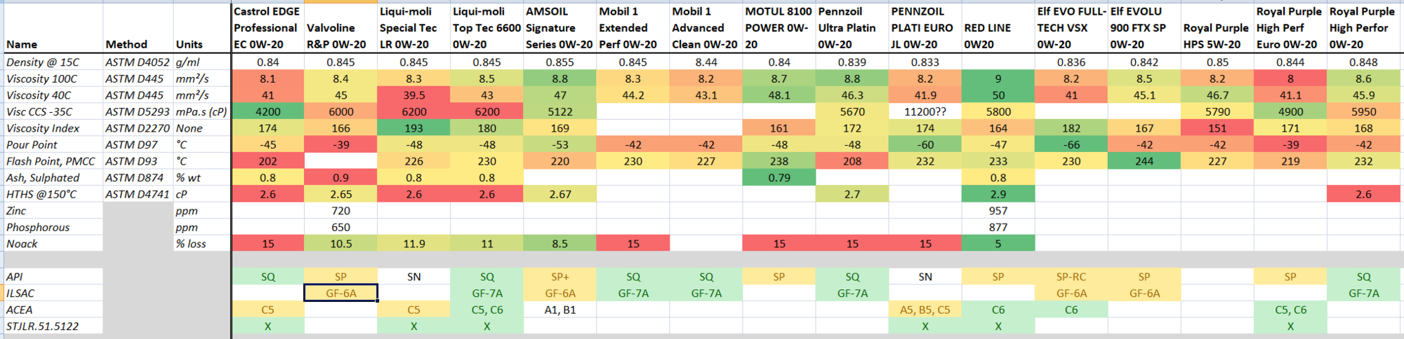

So fwiw, I made a spreadsheet with a bunch of oil specs that I could find. One thing I learned is that an oil viscosity grade has a range of acceptable viscosity. (caveat: the JLR certification row isn't entirely accurate - I was marking an oil as meeting it if it met any of the JLR certs, not the specific one for the F-Type. I've also found that a lot of information is just missing from a company's data sheets.)
For example, if you look at the API spec, 20W oil tops out at 9.3 @ 100C, while that's where 30W starts.
So if you look at my chart, Red Line 0w-20 is a 9 @ 100C (a thick 20 weight), while Liqui-moly 0w-30 is a 9.5 @ 100C (a very thin 30 weight). For tl;dr reference, the JLR Castrol stuff is an 8.1 @ 100C.
When I finally spent time looking into all this stuff about oil, I was a little amazed by how much deeper it can be than just the 0w-20 or 0w-30 etc. Now, there may be special additive package in the JLR oil, but I've read that you can't claim certain licensed certifications if your additives are out of spec with what the cert requires, so... Myself, I'm going to be running the Valvoline Restore & Protect for a few changes before maybe switching to Red Line.
Anyway - use your own judgment - but hopefully this information helps some of you.
0W-20
0W-20
0W-30
0W-30
The colour coding: To explain quickly, it's arbitrary. I coded some numbers where I understand what the ranges mean, from green (relative best IMO) to red (relative worst for this application IMO). Don't take the colours as gospel of anything since you're not in my brain, haha.

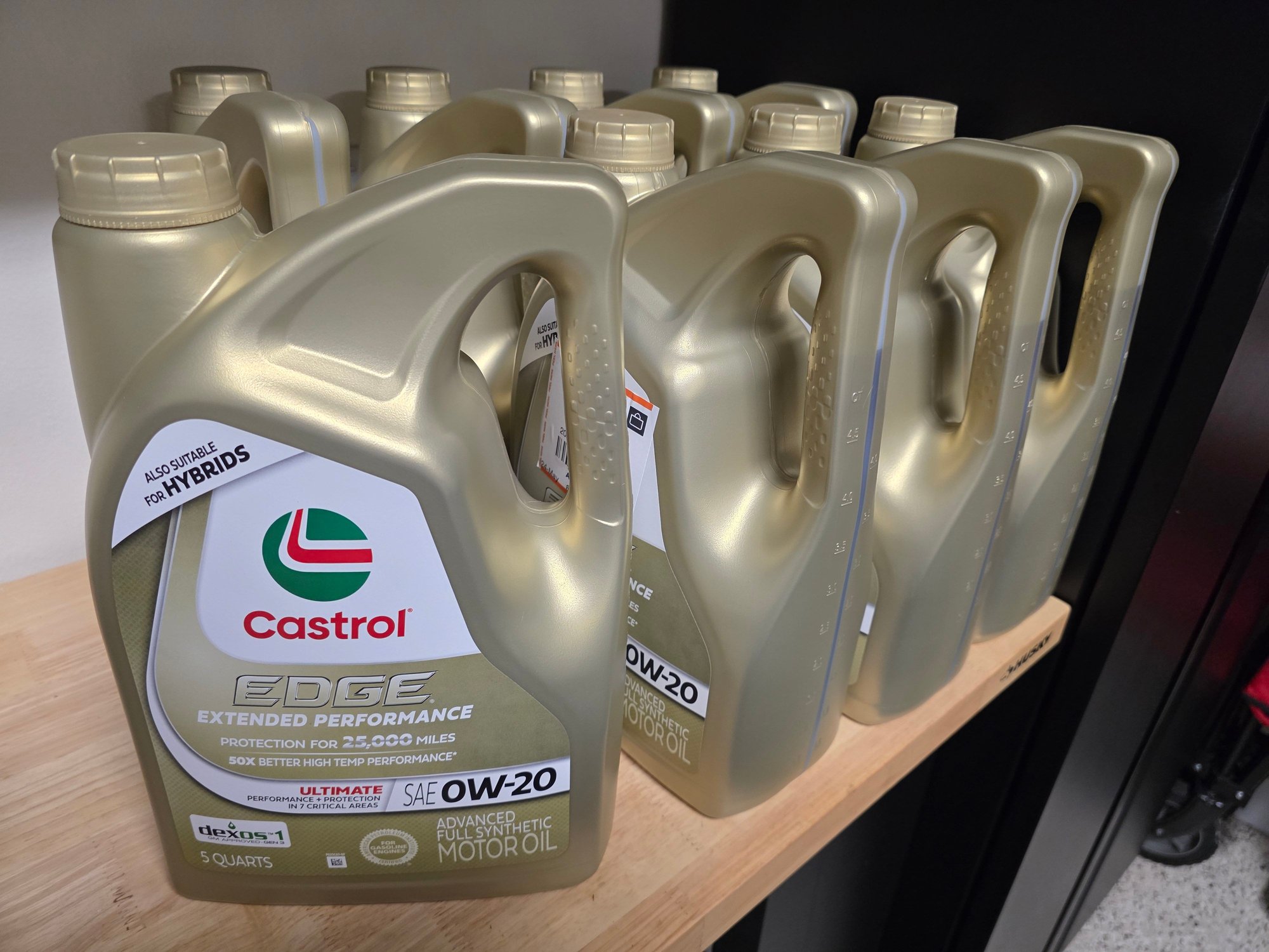

In my opinion, the best value at the moment for oil that fully meets the JLR spec is Castrol Edge Extended Performance in 0W-20. In the US, you can get this for $27.82 per gallon, after tax and delivered, from Walmart. I'm currently using this in both of my vehicles (Defender 110 and F-Type). That said, as others mentioned if you are changing the oil every 5K-8K miles or so any modern mainstream full synthetic is going to be fine. These super-premium oils only matter if you really push the interval out >10K miles.
