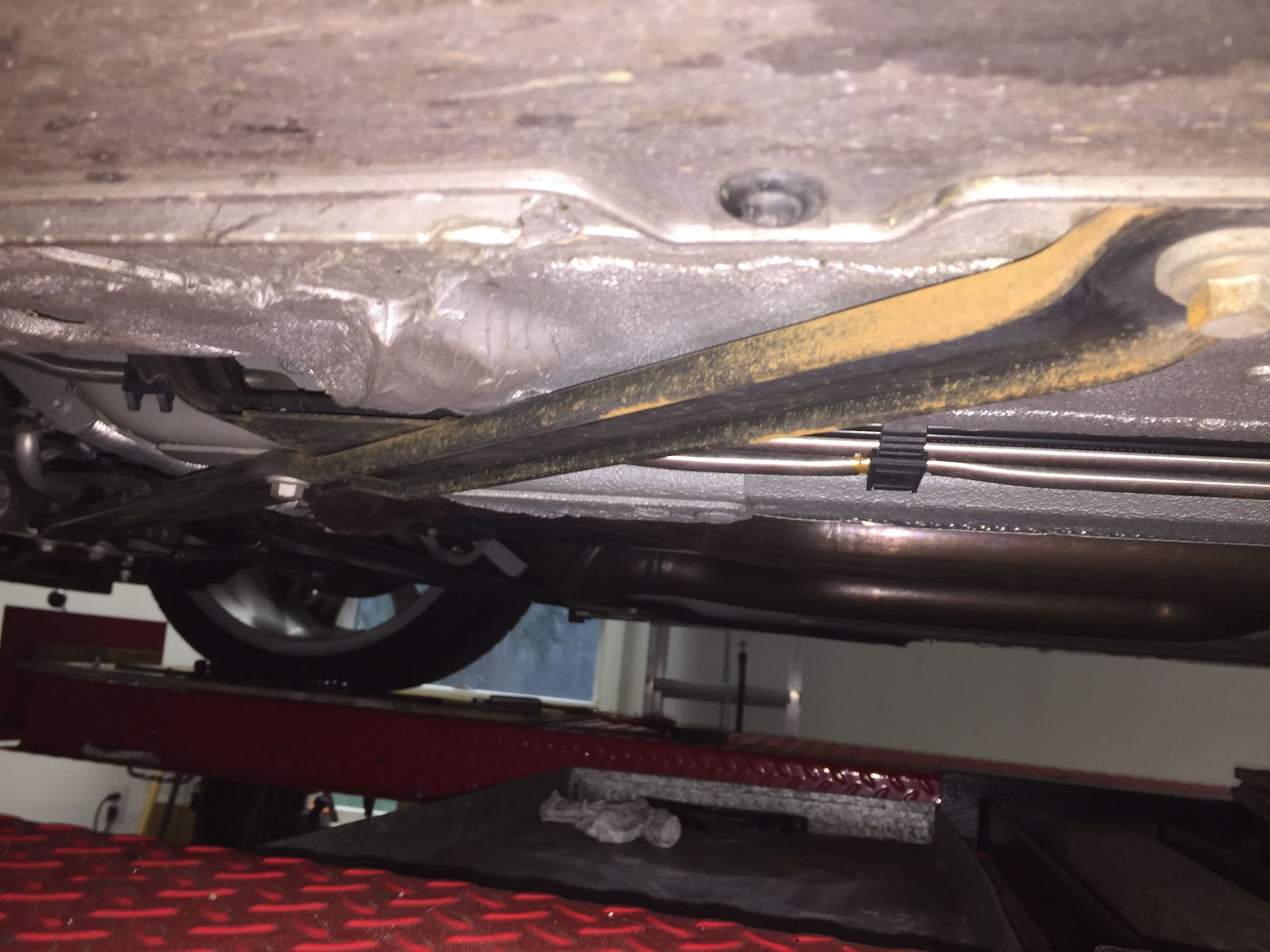

Cold idling/running always creates sooty condensation. the 'release holes/gaps are there to prevent buildup. (Modern exhaust systems are mandated to last 100K miles in the USA so they are often created from a low-grade stainless..) The first pic shows the holes (arrow).
Yeah have the dealer look at the rear crossmembers/stiffeners. I included a couple shot of ours before I refinished therm.
