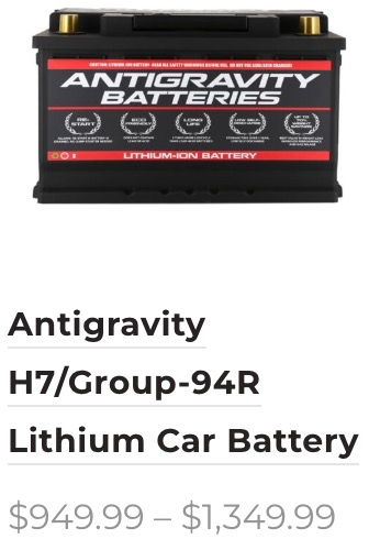

Default BMS disconnected photos
Large charging system fault, symbol, and words disappear when hitting menu, but others remain.
[img alt="Antigravity battery tracker ranges from 95 to 99%
"]https://cimg9.ibsrv.net/gimg/www.jaguarforums.com-vbulletin/920x2000/img_0561_9a64f0127ed854ee895ef6d21c93687979165f92. png[/img]
[img alt="To get rid of the annoying large warning light I push menu OK button
"]https://cimg4.ibsrv.net/gimg/www.jaguarforums.com-vbulletin/920x2000/img_1663_835f366488bfb6000e68d310a22319e787fffd6c. png[/img]

Default BMS disconnected with Antigravity Battery
The above is a repost of my experience with my very expensive Antigravity Battery coupled with their Battery Tracker app and my 2016 F type R BMS unplugged. I am very happy with the outcome [except for those 2 little red warning lights]. The Battery reports staying always in the 13.64 voltage / 95% range regardless of sitting or running. I never have to connect a trickle charger, nor come to the car and have to use the battery remote to reengage the battery because the Antigravity BMS prevented it from going below the 12.2 volts which that silly Jaguar BMS repeatedly cycled the charging system to let the alternator not function [theoretically to get maximum life from the standard glass pack / AGM battery] BTW the Antigravity tech support people told me this always charging 13.5 volts or more was desirable for the Antigravity H7/group-94R which I have...
Hoping that someday someone of our very smart owners will figure out how to hack the software of the F-type. It has lots of opportunity for improvement....
