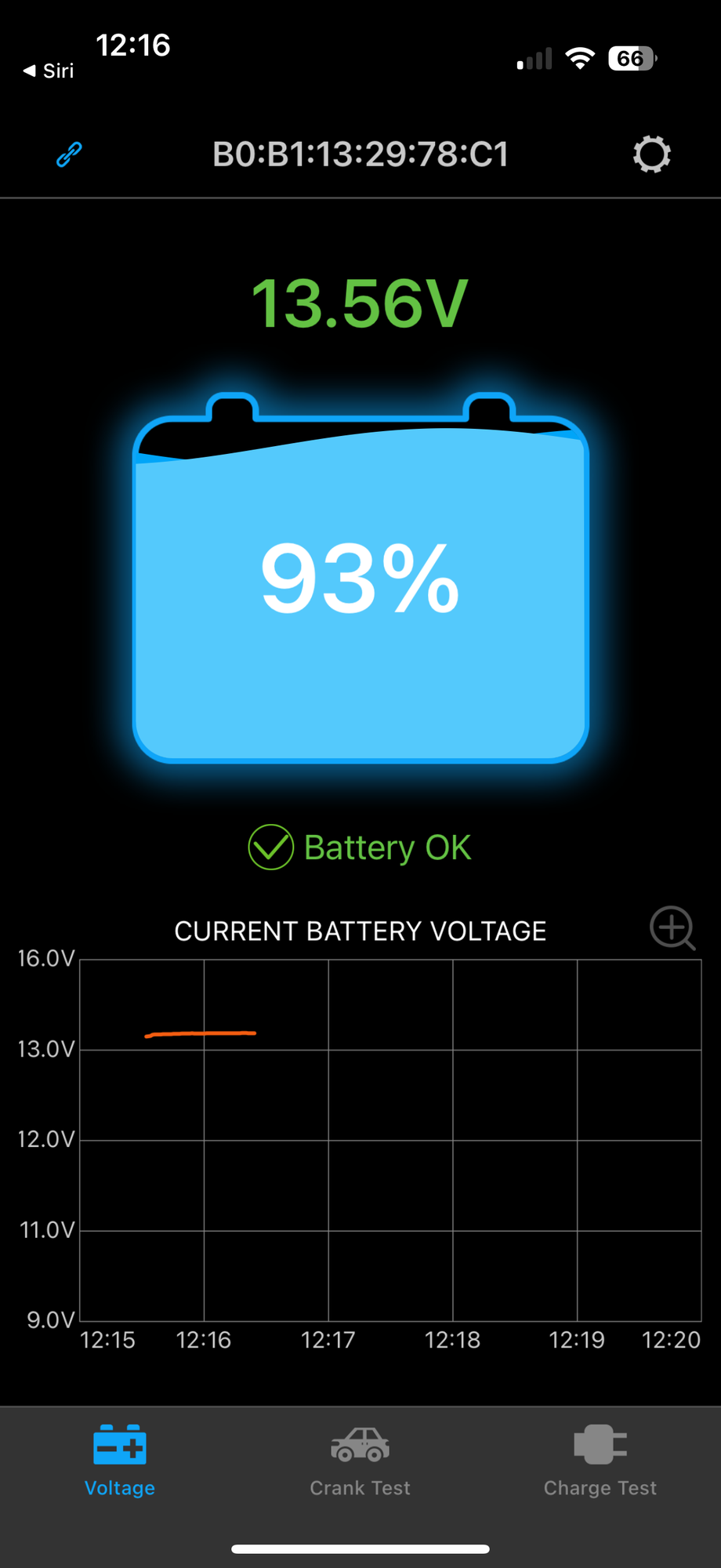

@chasers03 I didn't realize your battery has an app that graphs real-time voltage - that's perfect!
Can you run the app while you are driving around and take some screenshots? I am curious to see how the charging voltage changes while you are accelerating and decelerating. Also can you check with your driver's door open while parked and at idle?
Thanks in advance

As you requested, I find no change to the charging whether high RPM or low RPM and the door opening makes no difference.

Thanks, good to know. This is different behavior than mine.
@chasers03 Can you test with the BMS plugged back in?
