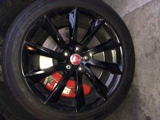

I have a Black edition 2017 F-Type, I wanted to paint match the calipers to the center cap as it is the only red I have on the car. I bought a can of high temp spray at Oriely's and it matched well with the center caps. Its only been 4 months
did you remove your calipers to paint them?
does the cover plate on the fronts come off without removing the calipers or will I have to paint with it on?
looking for more then one persons opinion? maybe unhinged?

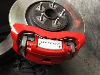

You don't need to remove the calipers to paint them, you can paint them "on car" with either a rattle can or a brush with little trouble or problems.
I have lost count of the number of times I have painted calipers using a rattle can of caliper paint, always with the calipers in place, and never once had a problem.
The only prep I do is to thoroughly clean the calipers with degreaser, turps, brakes cleaner, meths etc (depends on how dirty/grotty they are and what I have to hand) and tape off the brake rotors (with masking tape) either side of the caliper. Then once the paint is dry I peel off the tape and clean up any over-spray with turps. Any left on the swept surface of the brake rotor gets rubbed off completely after just a couple of brake applications.
The "cover plate" is an anti-rattle spring and you can either leave it place and paint over it or remove it and replace it afterwards (with or without painting it).
I'm a lazy sod so I tend to leave it on and just paint all over and around it, works for me!
It's a piece of cake to flip off with a screwdriver, no need to remove the caliper, but it can be a little difficult to refit. The 355 mm version (like yours) is not too hard but the 380 mm version can be a right royal PITA unless you have the technique down pat.

Does the cover just pop off with a screw driver. I Believe I have the larger brakes I measured. I would like to do it the easiest way as long as I can make it look good.
Whats the trick for getting them on or off?
Thanks
I was commenting on the pics in your recent post #13 as they are definitely 355 mm brakes so I stupidly assumed it was your car!
IIRC you have a V8 and if so you have the 380 mm front brakes for sure.
Yes, the ant-rattle clip pops off very easily with a medium to large flat blade screwdriver, just stick it under the middle of the spring part and lever gently. Be warned, it will spring off (it is a spring duh!) with quite a bit of force and probably go flying across the other side of your garage/shed/driveway/whatever.
But as I said the easiest way is not to bother taking it off, just paint the whole kit and caboodle in place.
If you really want to take the clip off then this is my method for refitting it (others have used different methods including using one or more zip ties):
1. Enlist the aid of a helper with strong fingers!
2. Place the two ends/feet where they go (take note of the position BEFORE you spring the clip off!), you will need to apply a fair bit of force to them (bend them a little) to get them both in place.
3. Get your helper to hold those feet in place by pressing them in towards the car, and make sure they keep pressing with all their might until you have finished the next step.
4. Now grab a large flat blade screwdriver, place the tip under the middle of the spring part, lever the cover/plate "up and in" until the spring bit goes in past the edge of the caliper, and push/tap it gently in so that is is sitting back hard against the caliper. It needs to go up/in about 1 cm before it locks into the correct spot.
5. The first time you try this there is a good chance you will dislodge one or both of the little metal clasps on the ends of the feet, you need to grab it/them and put it/them firmly back in place otherwise the clip won't do it's job. Just slide it/them back on and squeeze tight with pliers.
6. If at first you don't succeed try try again!
