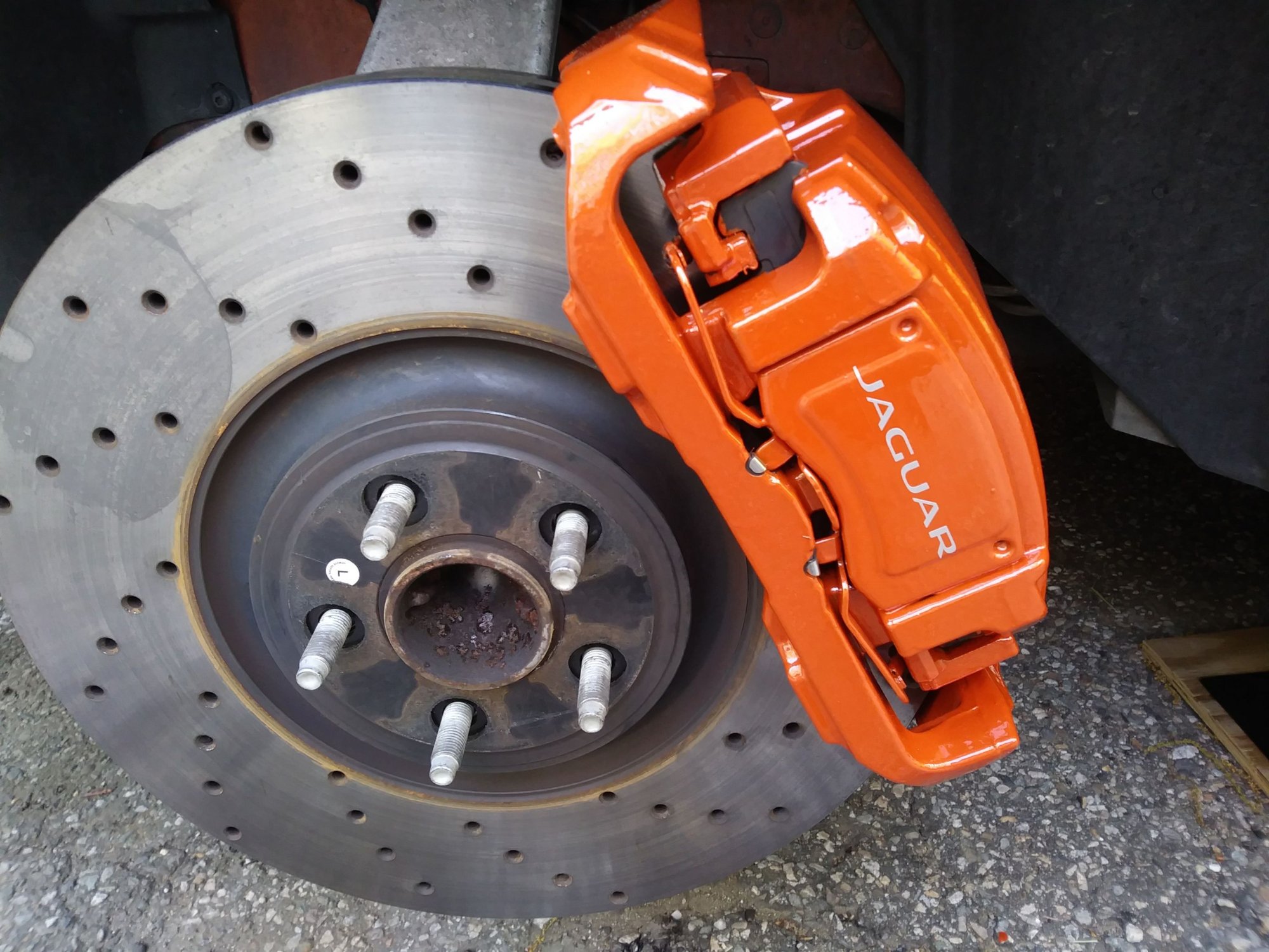

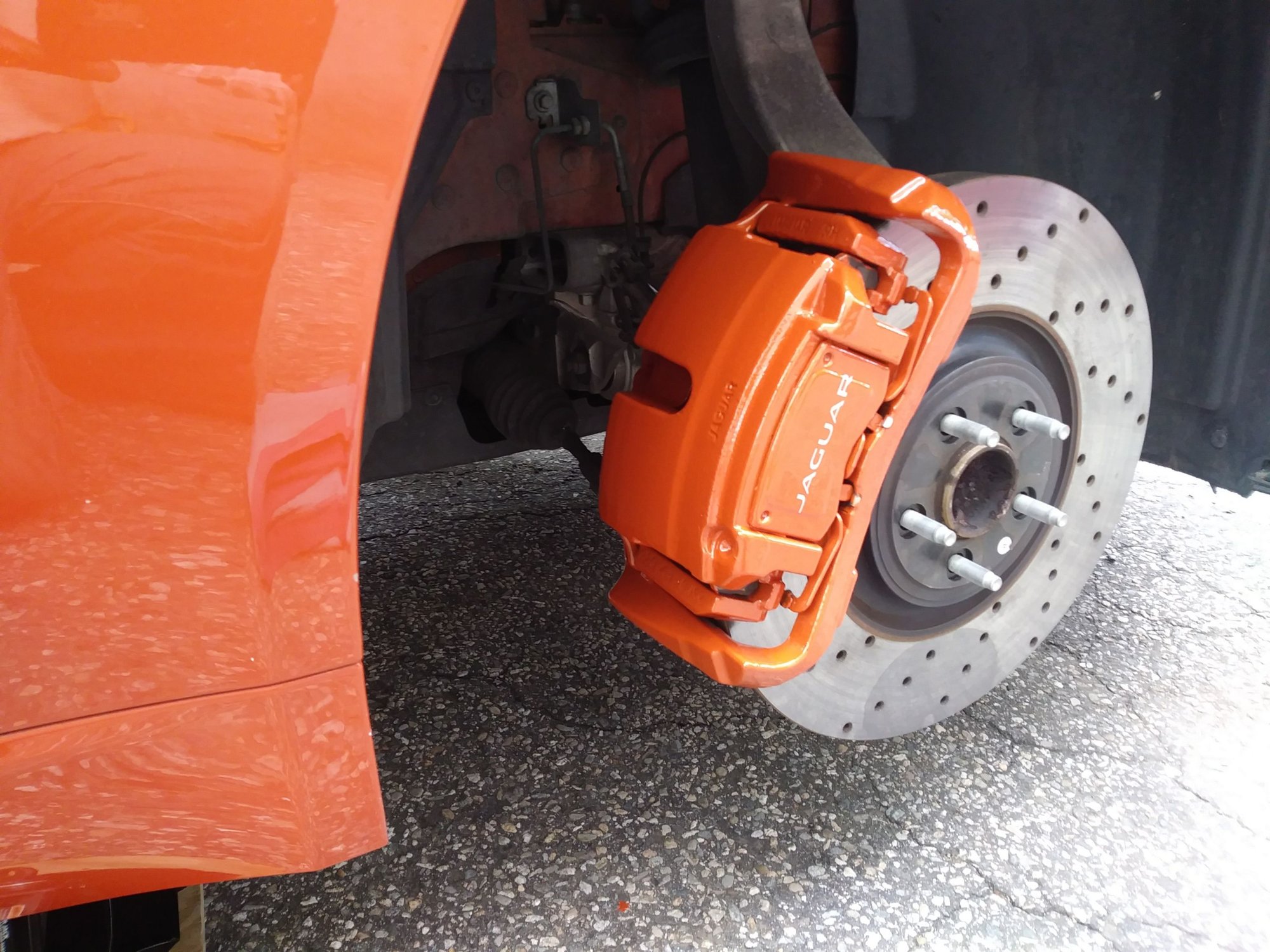

I have a base F-type so my calipers came metal, I removed the caliper to paint it, but did not remove thoe whole piece from the the knuckle, only the 4 bolts needed to remove the pads. I could have done it to get the full part painted, but didn't want to waste the time and effort to pain an extra 2 inches of surface I think the finish came off pretty good. The clip does come off, its a pain to get back on, but if you have a spare set of hands its easy, took me 5 min.
I would not paint them on the car, to do it right you need to take them off and do a fair about of clean and prep. I used oven greaser and a wire brush attachment for my drill to remove all the dirt and dust.
I used s $7.99 can of high temp from Auto zone, there are better paint options, but this suited my needs.

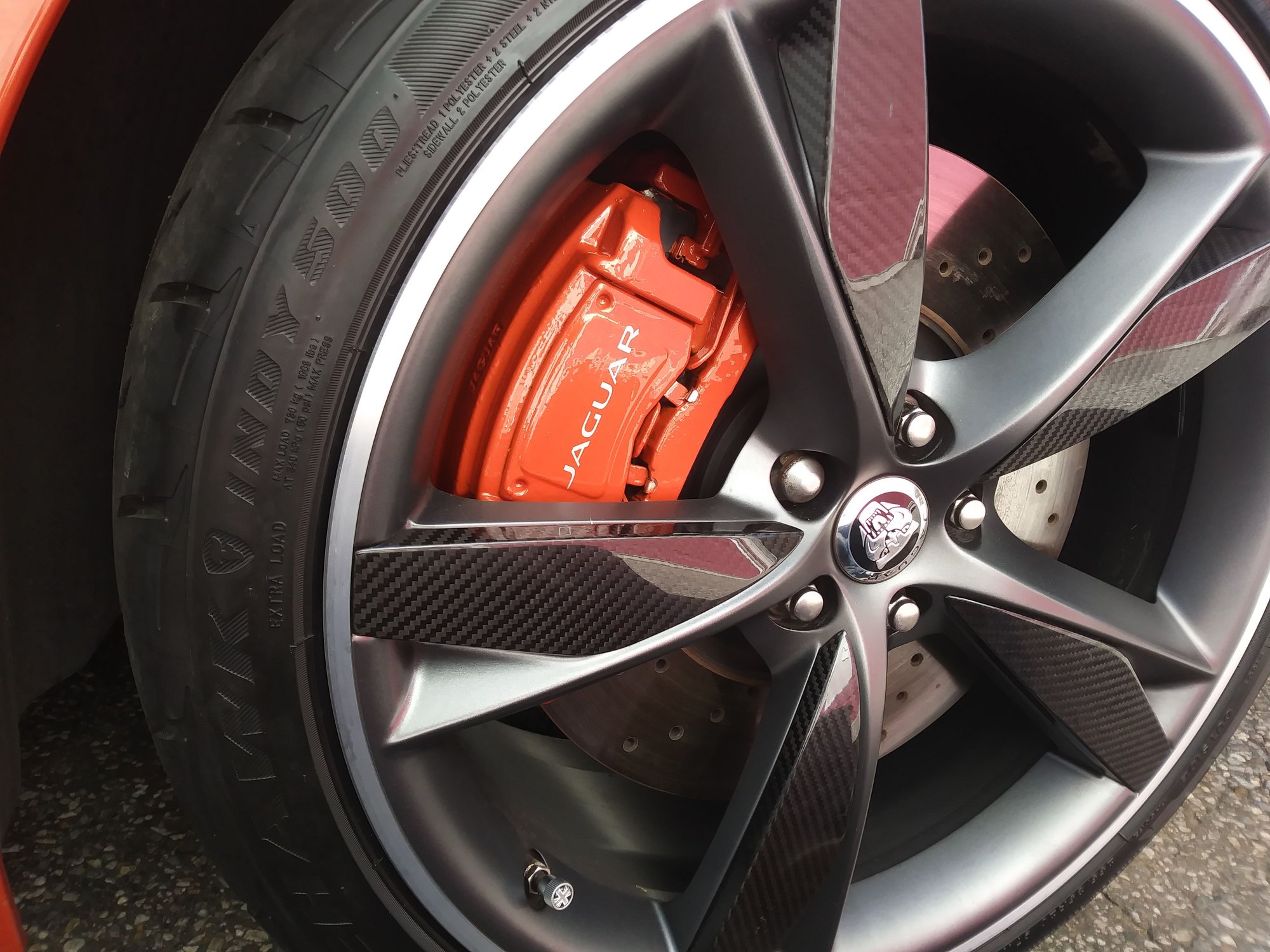

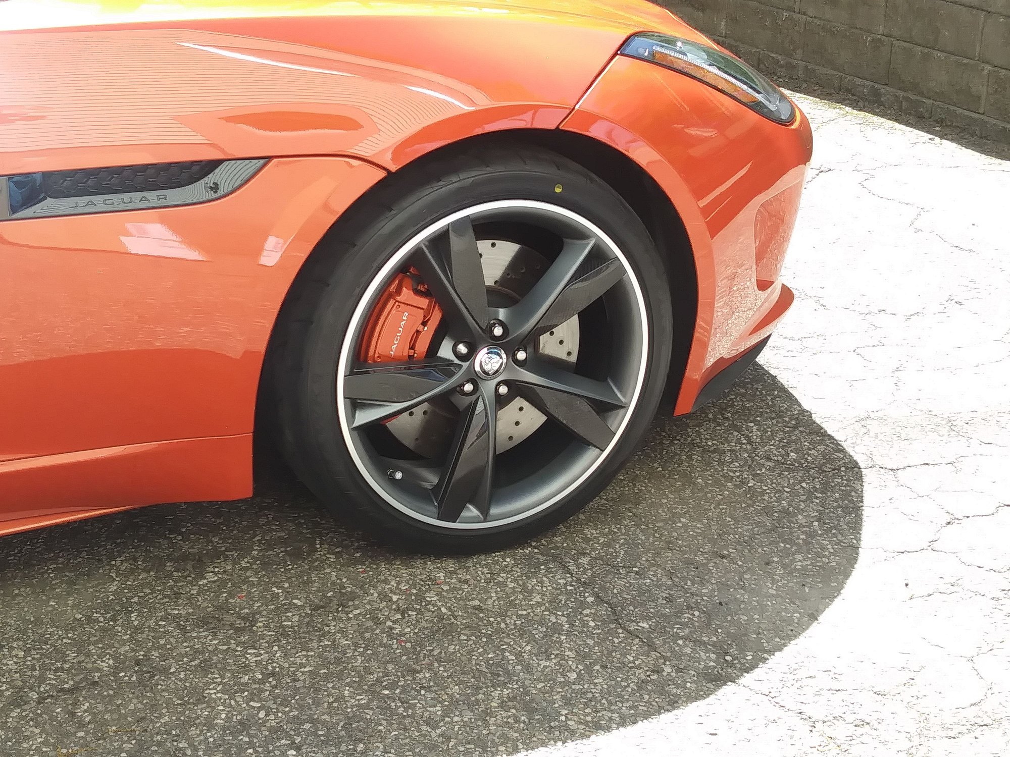

Old May 23, 2020 | 06:32 PM
2004XJ8's Avatar
Joined: Apr 2008
Posts: 286
Likes: 106
From: Boston Ma
Old May 23, 2020 | 07:27 PM
DanL's Avatar
Joined: Apr 2016
Posts: 67
Likes: 43
From: Ellicott City, MD
Looks good! I did mine yesterday after having the wheels powder coated gloss black. Where did you find the vinyl decal? I can't find an appropriately sized set anywhere, let alone a set with the new style lettering.

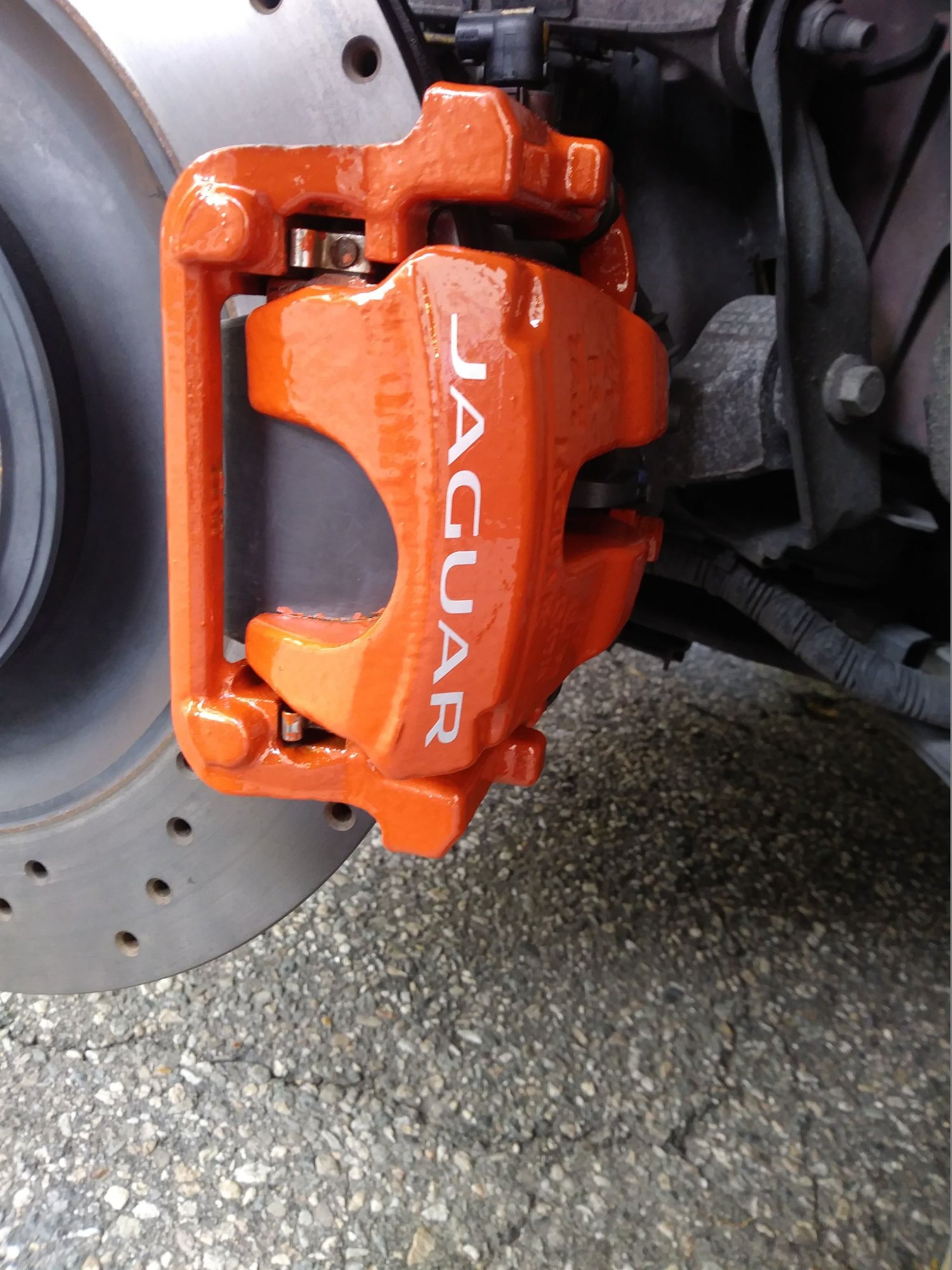

A guy on ebay. The place is called umtamed and is in florida.
The rears did not come from the factory with stickers but the set of 8, I received had 4 sizes and these fit the rears on that surface perfect.
The fronts were a little larger then the original letters which is silk screened on. I looked high and low for
something a little closer to the original size.
I do think they work and will actually show up better then the original size which is small.
I may see if the guy can make a slightly smaller version for future use if needed.
One thing I like is they are transfer and single letters not one big sticker.

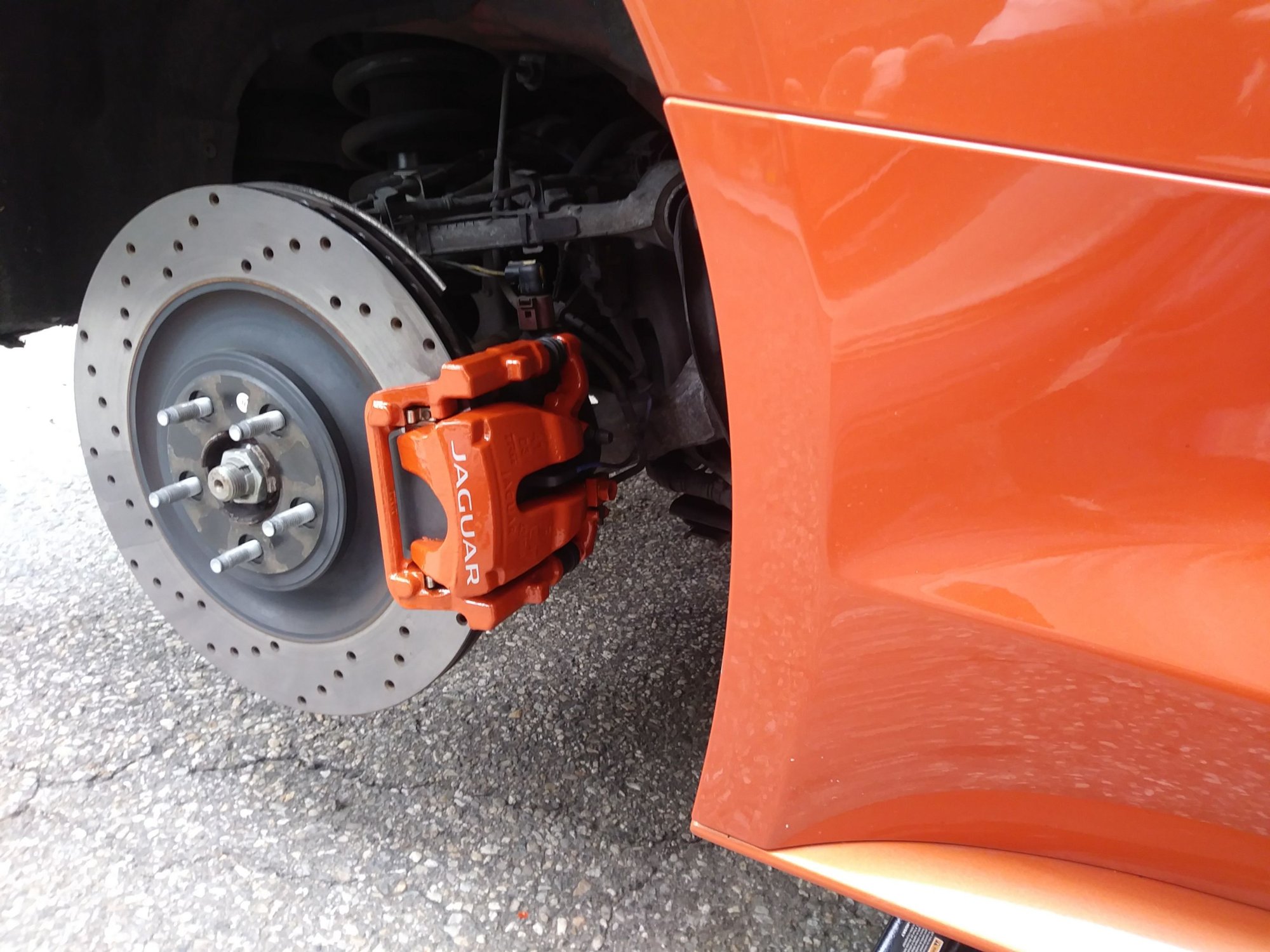

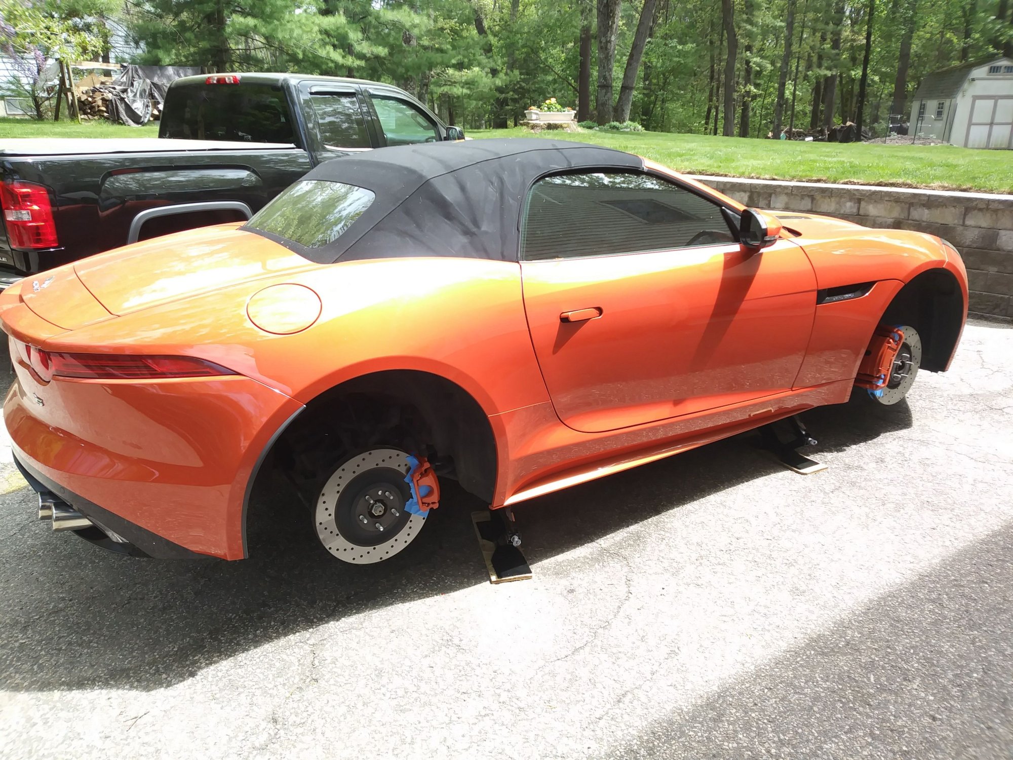

I struggled with how best to do this considering the low clearance these cars have and their lack of real definition of where the jacking points are.
The manual says there is 2 triangular indents on each side. Hard as hell to find the back spots The front triangle spots I found.. Plus the link to
another post showing where people lift their cars from shows lots of different location.
It was not my preferred method. I evenly jacked each corner up until each wheel was off the ground an inch. The jacks were barely extended 1/2 way.
BTW as a disclaimer I would never do repairs (wrenching) using just a scissor jack or multiple jacks period.
I did put blocks under the rails.
The jacks I used also had a very wide base and were rated at 1 1/2 tons each 3000 lbs x 4= 12000 lbs
The car weighs 3600 lbs if you believe what Jaguar says, so the jacks can support the weight distribution.
The car was on level hard ground and was not being worked on unless you consider spraying cleaner and
brushing,wiping then painting working on the car.
Your point was well taken and meaningful. As things do happen and will happen when working on cars
people get killed!

The back jacking points are easier to find than the fronts, you don't even need to locate the little triangle indentations in the sills.
About 6 or 8" in front of each rear tyre is a largish triangle shaped chassis piece/plate with three very obvious bolts sticking down from it.
The jack goes smack in the middle of those bolts.
