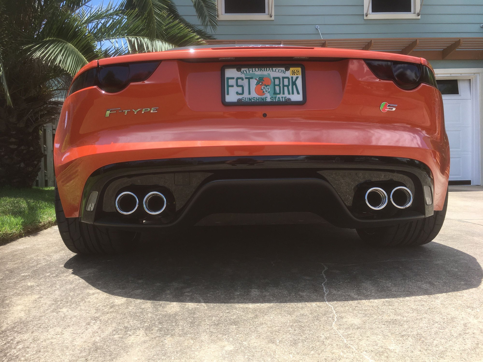

How did you do the black tail lights and how does it look when the lights are on?
Is your car a 2014 or 2015? I like the color you choose for your wheels? How do you like the nitto tires and do you feel any handling difference in the brand change and width good or bad?

It is a 2014 and mine also came out of Florida. Ft Lauderdale actually. I live in Pensacola and went there to pick it up in Oct. 2016. It was one of twelve cars the owner had. Anyway, I have less than 50 miles on the Nitto's. My only impression so far seems to be a stiffer sidewall. I can feel a firmer ride, good or bad. To black out the tail lights, there is a product by VHT paints called Nightshades. On top of that I also used VHT's clear enamel. The tail lights assemblies are incredibly labor intensive to remove so I went the route of taping off around them and all the way up past the convertible top. There was enough room between the lights and the mounts to work in the painter's tape. The actual painting was quite easy, three coats of each. Surprisingly, plenty of light shine through.

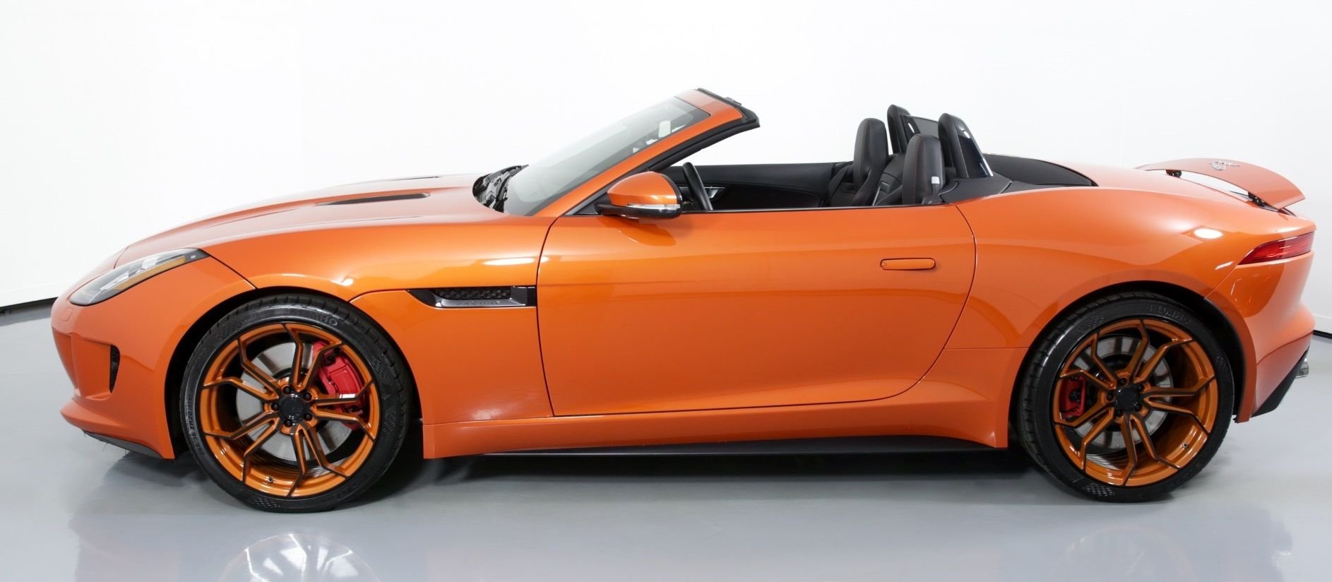

Btw what wheels do you have on your car. I am asking because based on the picture it looks like you have some orange in your wheels.
I would like to see a bigger picture of your wheels.
Old May 28, 2020 | 10:07 AM
  #52
JacksonvilleJag's Avatar
Joined: Dec 2019
Posts: 839
Likes: 280
From: Jacksonville, FL
I'll take it from you. PM sent for the details.
I have color matched Avant Garde M632 wheels. They came on the car when I bought it in December. I also have the factory Tornado in gloss black rims that came in boxes.
