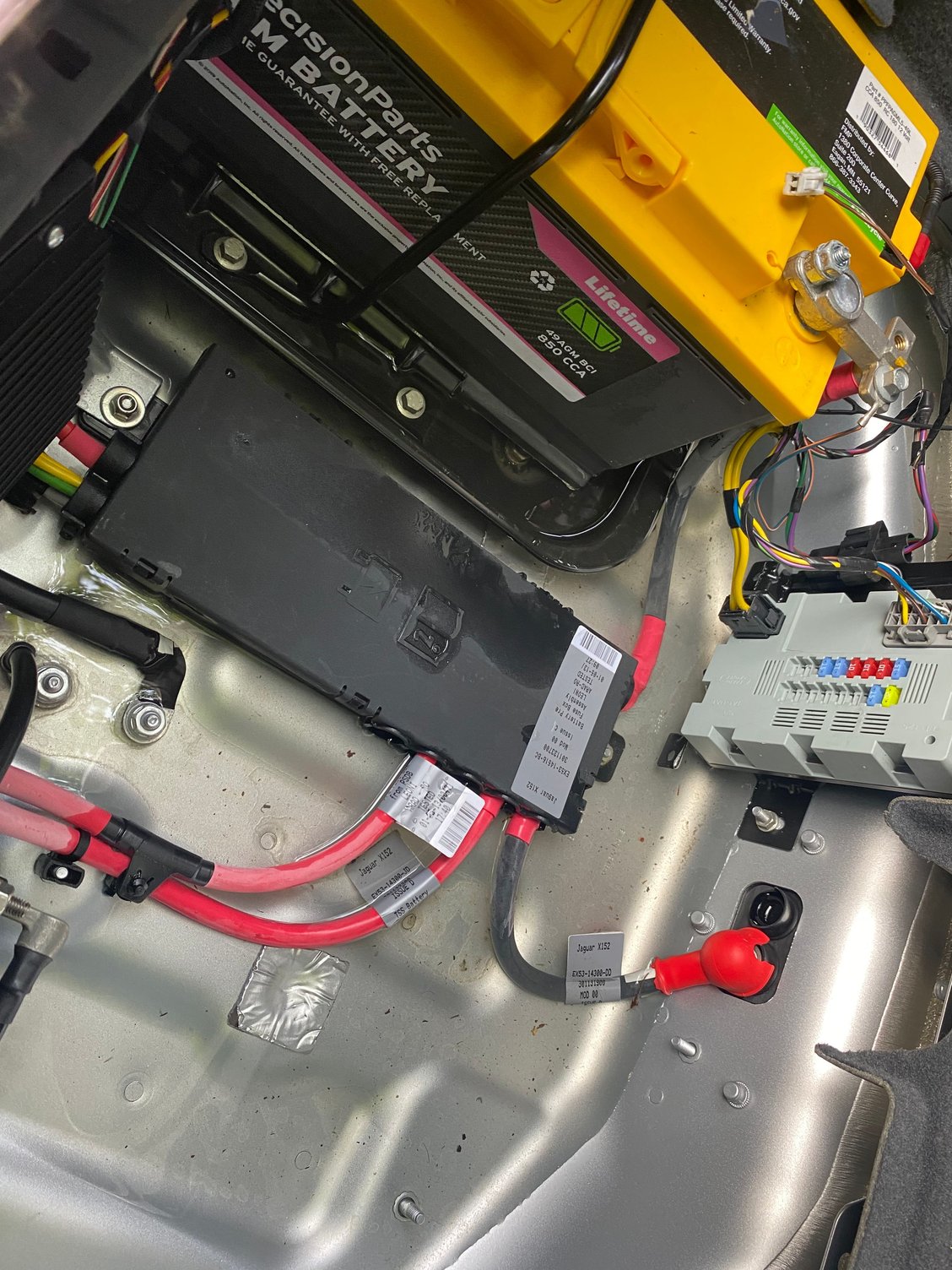

I have had the same problems (plus a couple) for the last year also!
2014 convertible V8 S 32k miles.
mine began (embarrassing enough… no judgement please) after plugging a small heat gun into a aftermarket ac/dc power inverter that was plugged into accessory outlet.
at the time, I didn’t have a private garage for 2 months… all other times she has been garaged.
immediately after this plug in…. I saw “charging systems fault”. After that, 2 weeks went by intermittently seeing “adaptive dynamics fault” parking break fault”, “special mode unavailable” , before alternator went out. Bought used from eBay for $78. Got used gateway module also, new battery from advance auto…
left it at jaguar for a month with both used alternator and used gateway module in the trunk. Jaguar addressed neither of those requests and put in new fuel pump only. $4300 later I was able to drive away but with same warnings… only difference was that it started…. 15 miles later the battery died again and stranded. So then I took to pep boys and the alternator put in and voila no more charging issue (no consistent charging issue , only intermittent. I noticed after seeing this intermittently… the ground cable had corrosion, so I bought a used off eBay and that fixed that.
-pending at this point. There is just the gateway module to be reflagged, however every time I try to reflash it, with mongoose… something happened and did not.
after driving around procrastinating with bumpy suspension and no dynamic mode…. No stability control…. I had to replace control arms , ball joints due to no air suspension…. And the night it decided to go caput…. The top was stuck and wouldn’t move.
so now I believe the fuel pump is out. AGAINNNNN
(Or just a relay) so I ordered all new relays from Amazon. (To be done)
I had noticed that the charging of the auxillary battery (also replaced by advance auto” in the dual battery box) it was always charging too high and would fluctuate too high with engine rpm).
-voltage regulator is issue!
so now. after I abruptly had no more instrument cluster lights…. No start f(just starter constantly trying to turn it over) …. No response from obd reader…. Parking break wouldn’t release…

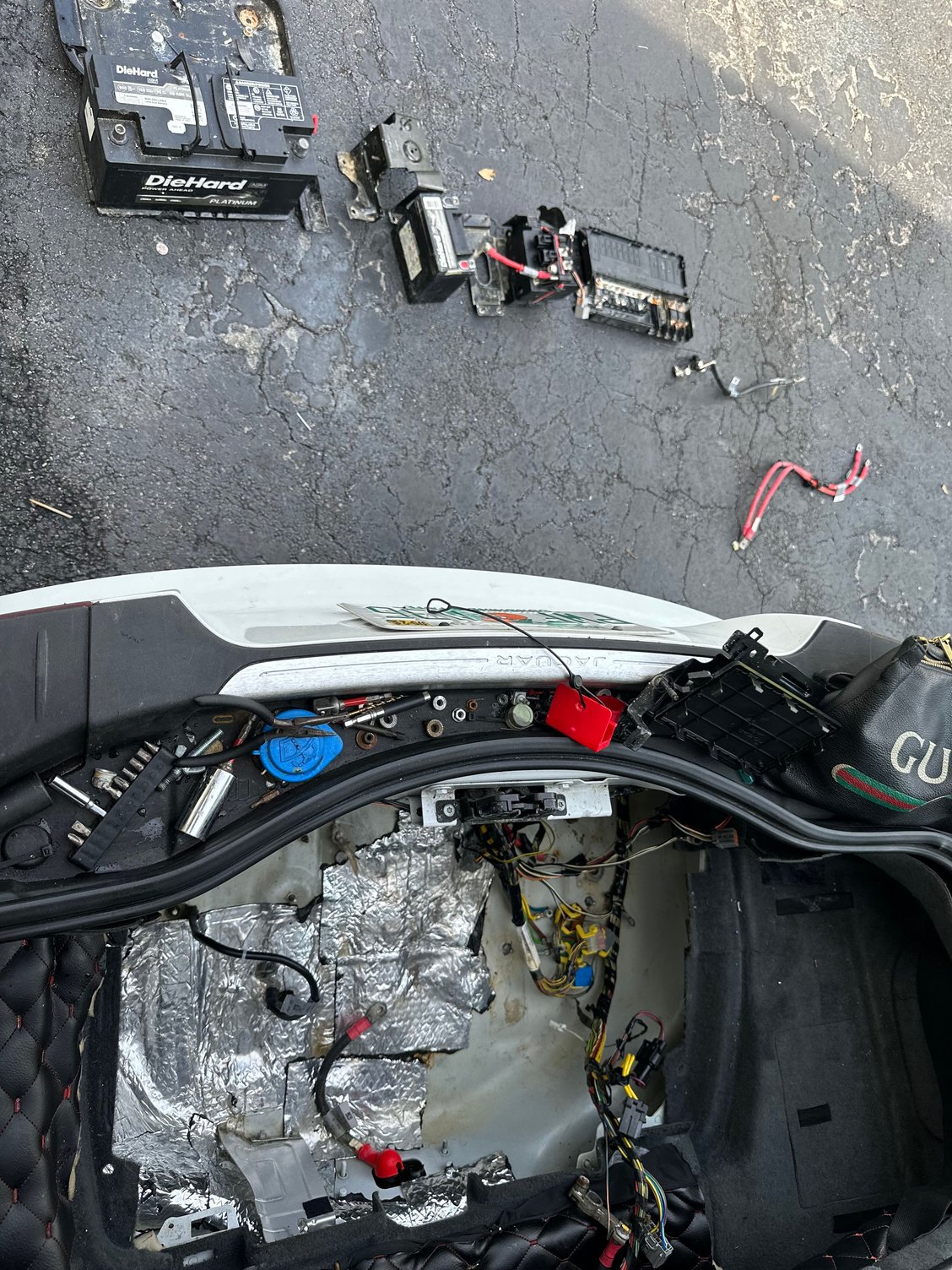

it sat halfway under the roof during a big storm one day and I opened up the trunk to what you posted…. 3 inches of water in trunk!
the battery (main only ) was unhooked and my friend shut the trunk and the manual latch shut with no way to open( that is nightmare fkr the second time)

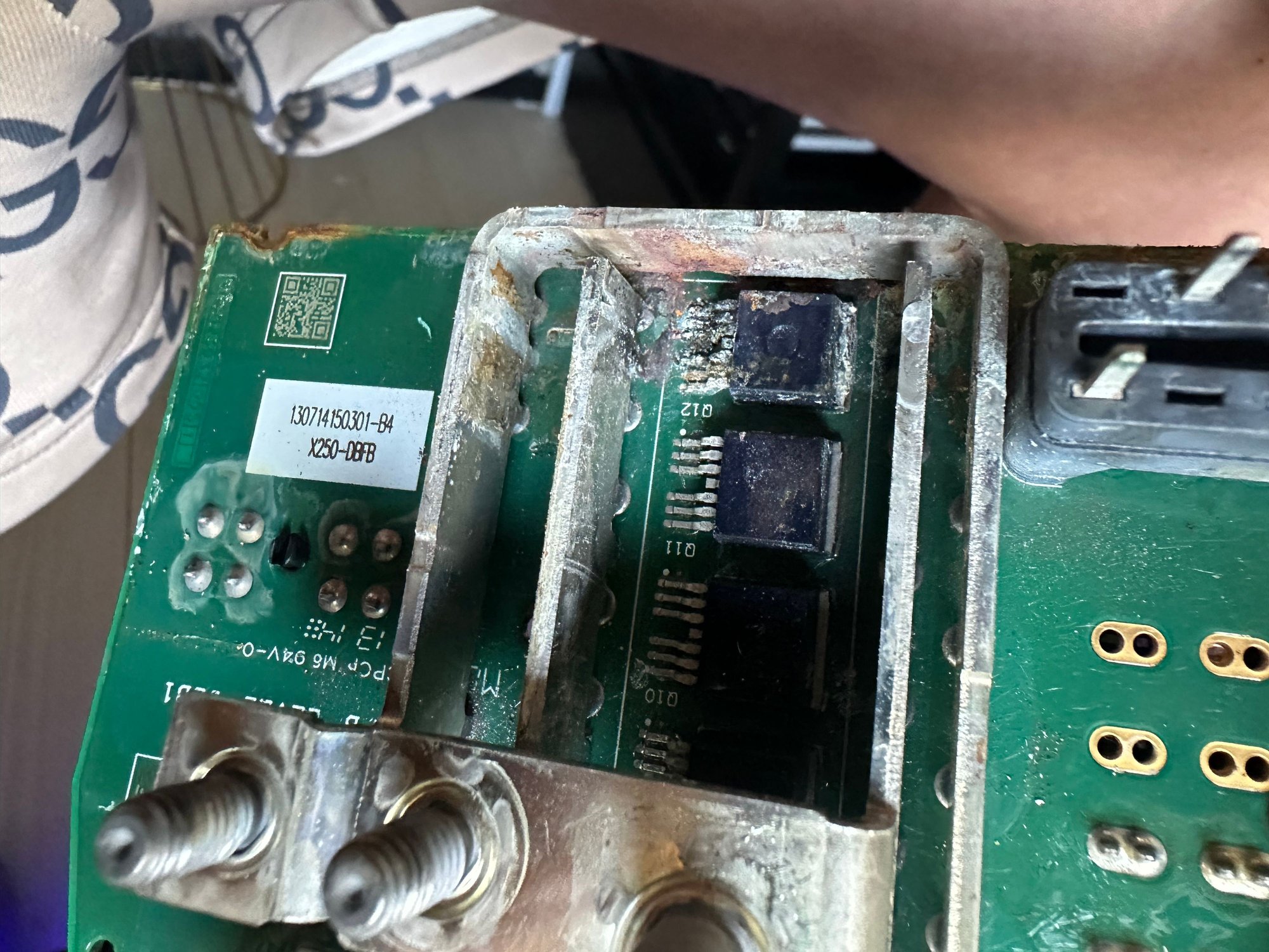

I took out all modules from trunk, new mega fuse box, fuses, cables, etc. Almost all those arrived.. next I will finally reflash the gateway and hopefullly all my current problems go away with no more.
the leak…. Idk where it is though.
Current parts list to be installed /replaced
Inside dual battery box…. Fawkkkkk!!!!
Removing modules to replace. And to clean corrosion from trunk contacts to battery (heavy corrosion notes possible over charging)
(Inside dual battery box, cont)
