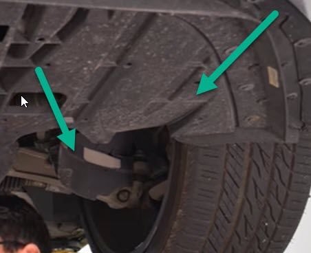

Fair point, maybe they never recalibrated it for CCBs and/or SRF. Do those fins sit on the LCAs? The SVR already has something like this installed, but I think there was a dealer item that went beyond that which was discontinued.

Not a great photo, but this is on the LCA on my SVR. Meant to push the air towards the wheel center.

Yes, the 996GT2 parts go on the LCA's...but probably won't work on an F-type as the F's parts are much bigger/stronger (LR spec of hitting a curb at 45mph per Harry Metcalfe and his type 7 wheels/suspension...mentioned in one or two of his youtube videos).
But they might...it is just an expensive might. What may work is to "rivet" something to the bottom of the jaguar's OEM plastic piece like Porsche did to the stock gt3 piece (that is about an 2-3cm of more depth...so it will scrape.....I'd likely start low like at 1". And if you find out more on the SVR optional part..please post!!!
To be honest, the parts on my F-type look different....car is not near me at the moment but from the Savageese youtube on the R here is a screen capture:
The duct and the channel built into the tray to help it with more air.... That is the front left on an R but my type S seems pretty much the same as this. The SVR probably has way better stuff stock is what it looks like but the actual surfrace areas look different...the "pseudo" NACA duct in the undertray that I pointed to may be very different on the SVR...so like all other things it is a system....who knows.
