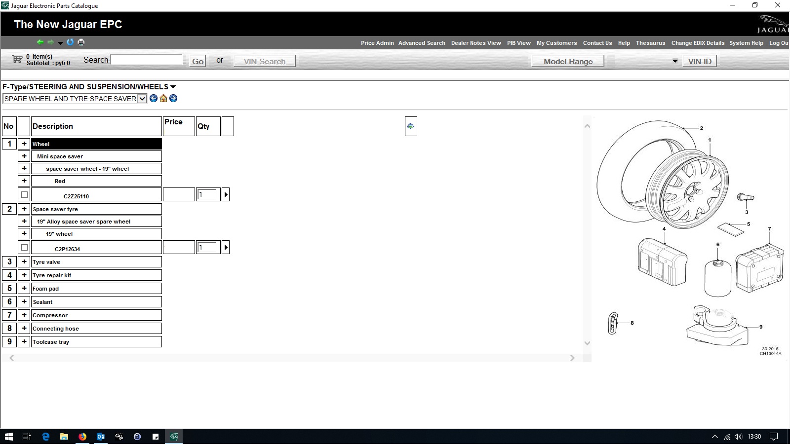

Old May 30, 2018 | 09:05 AM
Likes: 17,009
The 19 inch spare (space saver alloy rim + fitted tyre) from Jaguar is over 500 UKP ($665) in England and it's likely to be more in the US.
(double click on the image to enlarge it)
Although the same space saver is used on several Jaguar models, it is rarely specified by an original F-Type buyer simply because, in the event of a wheel change, the full size wheel cannot be carried in the luggage space.
