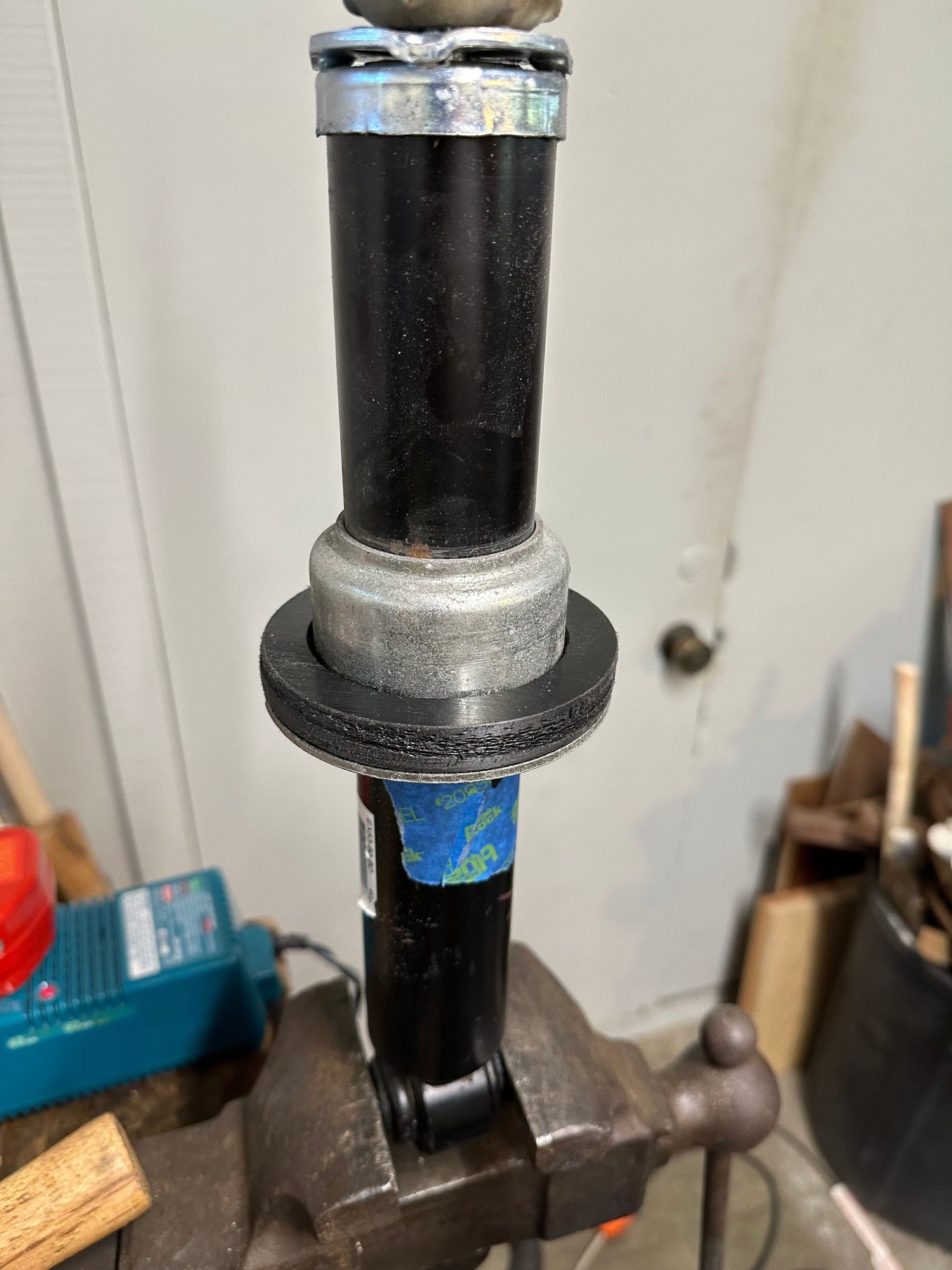

I made some pretty rough sketches and don't think I saved them, but here are some pictures.
First, the spacers. I would have liked them to be better finished, but not for any practical reason. Unfortunately, I don't have machine shop access any more.
Here is one, sitting on the lower spring perch. It needs to be an easy sliding fit on the inside, and the outside needs to only be as big as the perch itself.

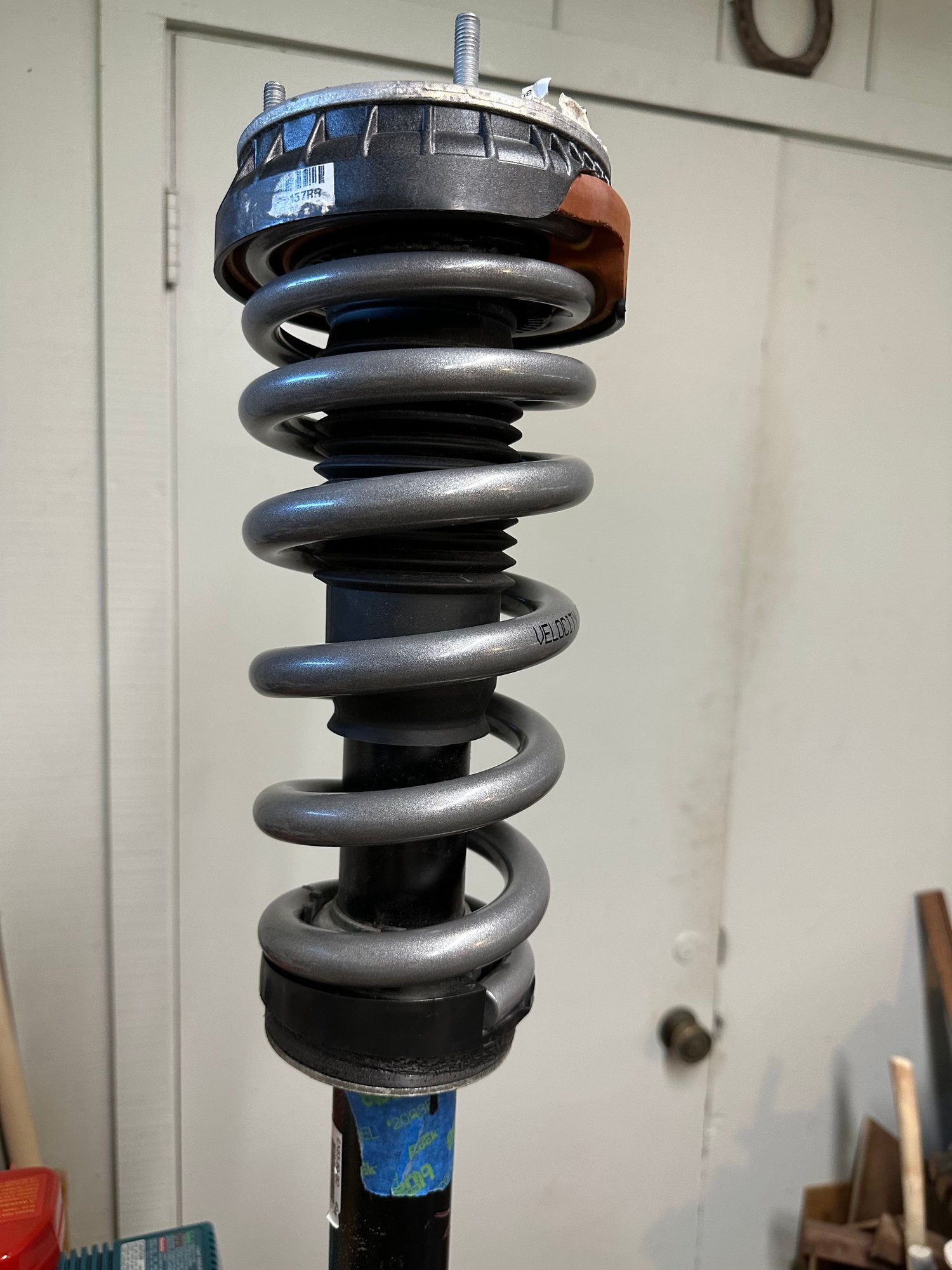

Finally, the complete assembly.
I'll follow up with dimensions. The only one I'm sure of is the thickness. I selected that so that there is no play in the spring when assembled off the car. I have an angled driveway and was concerned about clunking, and with speed bumps also had worries over clearance. Some day I'll get them installed.
The 1/2" thickness won't translate exactly to the change in ride height because it's adjusting preload, and also there is a leverage ratio in the suspension. That is, I don't know what 1" of shock travel correlates to in actual wheel travel, but I'm sure it's greater than 1".

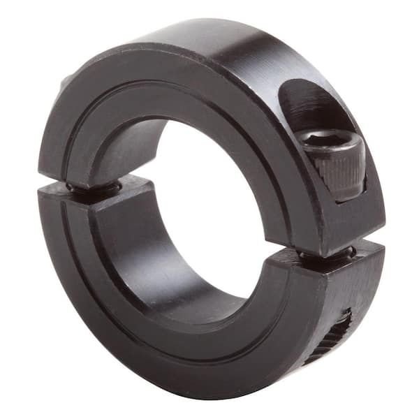

I wonder if something like this exists and is sufficiently robust to do the job:
Not this item exactly, but something more robust of similar design.
Goal would be easier installation.
I was thinking that you might get the hole saws and some plywood of different thicknesses to do just that: make some split rings to determine what thickness you'd want for the final installation. I would never drive with something like that, but maybe move back and forth a few times to settle things before measuring the effect. Once you've got that, you would only be doing the full installation once.
