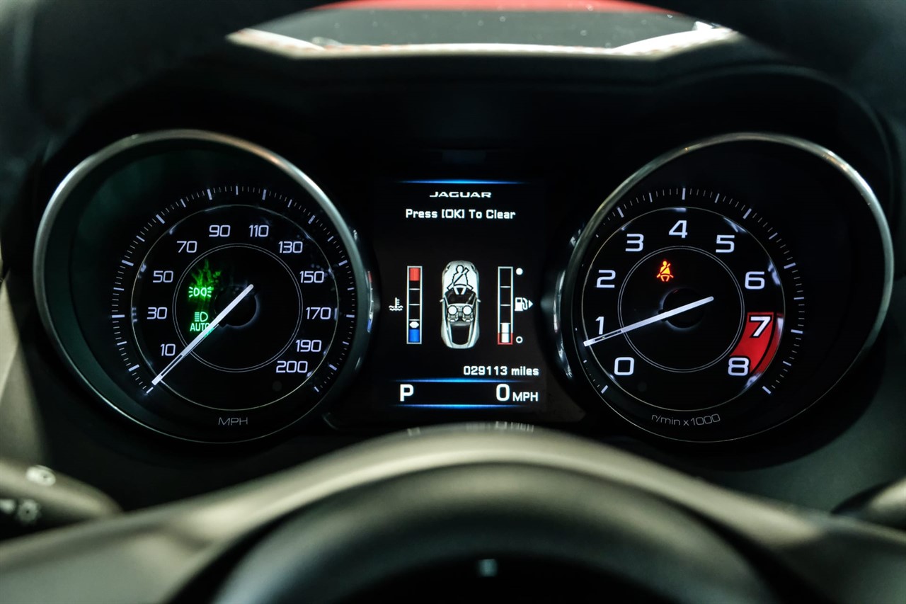

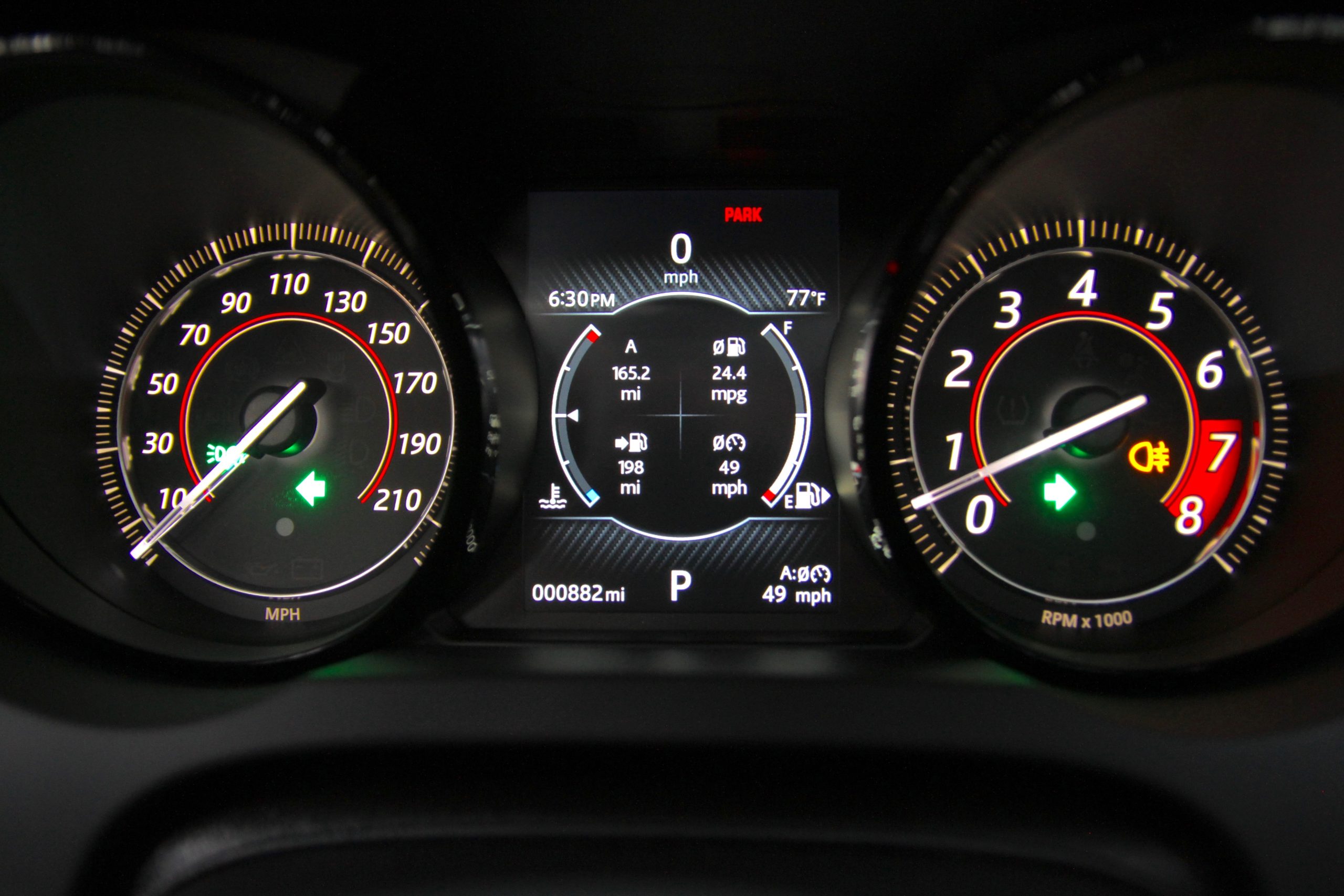

As someone who has had several XKRs and still have an XKR all I can say is get an F-Type. Its the best car I ever had. To really experience the F-Type in its rawest form you must get a convertible its a whole different experience. If you were to get an F-Type the best model in my opinion is the V6S convertible and its more than enough power for me especially since I have an XKR. I have driven an V8S model F-Type before to me its too much power for me to really use and it sounds like a muscle car I like it but only suggest getting it if you want maximum power. Other than that the V6S exhaust to me is the best sounding exhaust out of modern cars I ever heard it is so exotic and intoxicating. Also make sure the model you get has switchable exhaust, bsm and backup camera is a must. I traveled about 1400 miles to get mines and it was a blast and awesome roadtrip. Lots of stares and lots of attention from drivers of other brand cars. Just make sure the tires are in great shape and bring an air pump to make sure the exact air pressure in each tire my F-Type didnt come with a spare. Far as comparisons between the F-Type and XKR they are different cars the XKR is a GT and F-Type is a sports car. F-Type is more fun but the XKR is more practical especially since there is rear seats and larger trunk. But I prefer driving the F-Type the most so much so that my XKR will be on sale soon. I must warn you please be prepared to get lots of attention and some hate from other drivers for the most part the F-Type turns lots of heads and lots of people asking what it is. You will definitely stand out in an F-Type compared to other brands from other makes. Far as model year I would suggest 14-15 because those models have the best sounding exhaust MY 16-20 a lot of them has been muted due to updated software and doesnt sound as raw as the earlier MY cars. Also 18-20 has a DRL issue on the headlights so its best to either get 14-15 if you want the original exhaust. Also the 14-15MY has the best instrument cluster there is a bluish tint to the numbers compared to 16-20MY the numbers are white. Inspect car thoroughly make sure all functions work as others has suggested. If you want LED headlights you can also upgrade those for 14-17 models with newer sequential DRL to give your car a more modern look.
