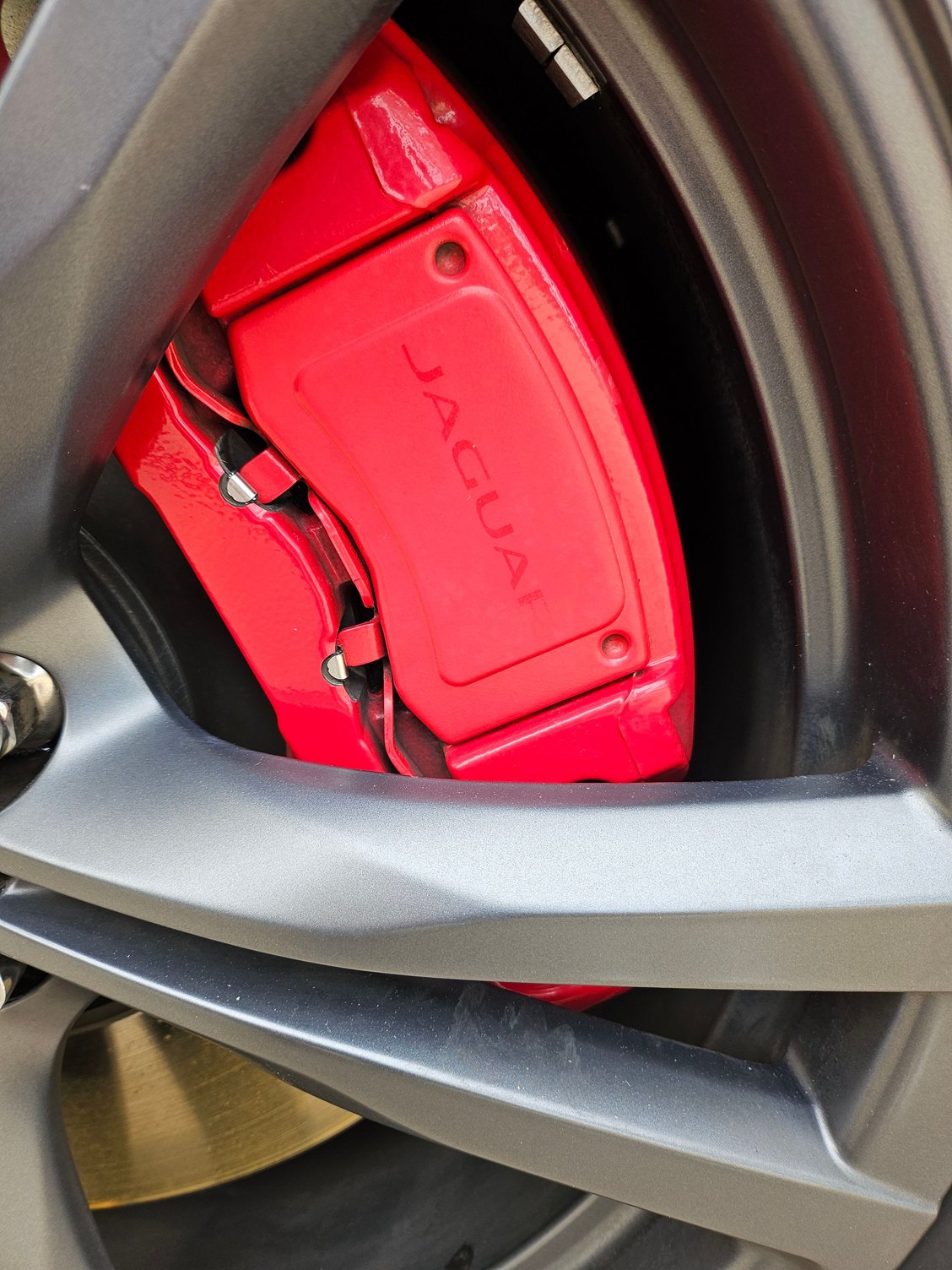

Here is the before:

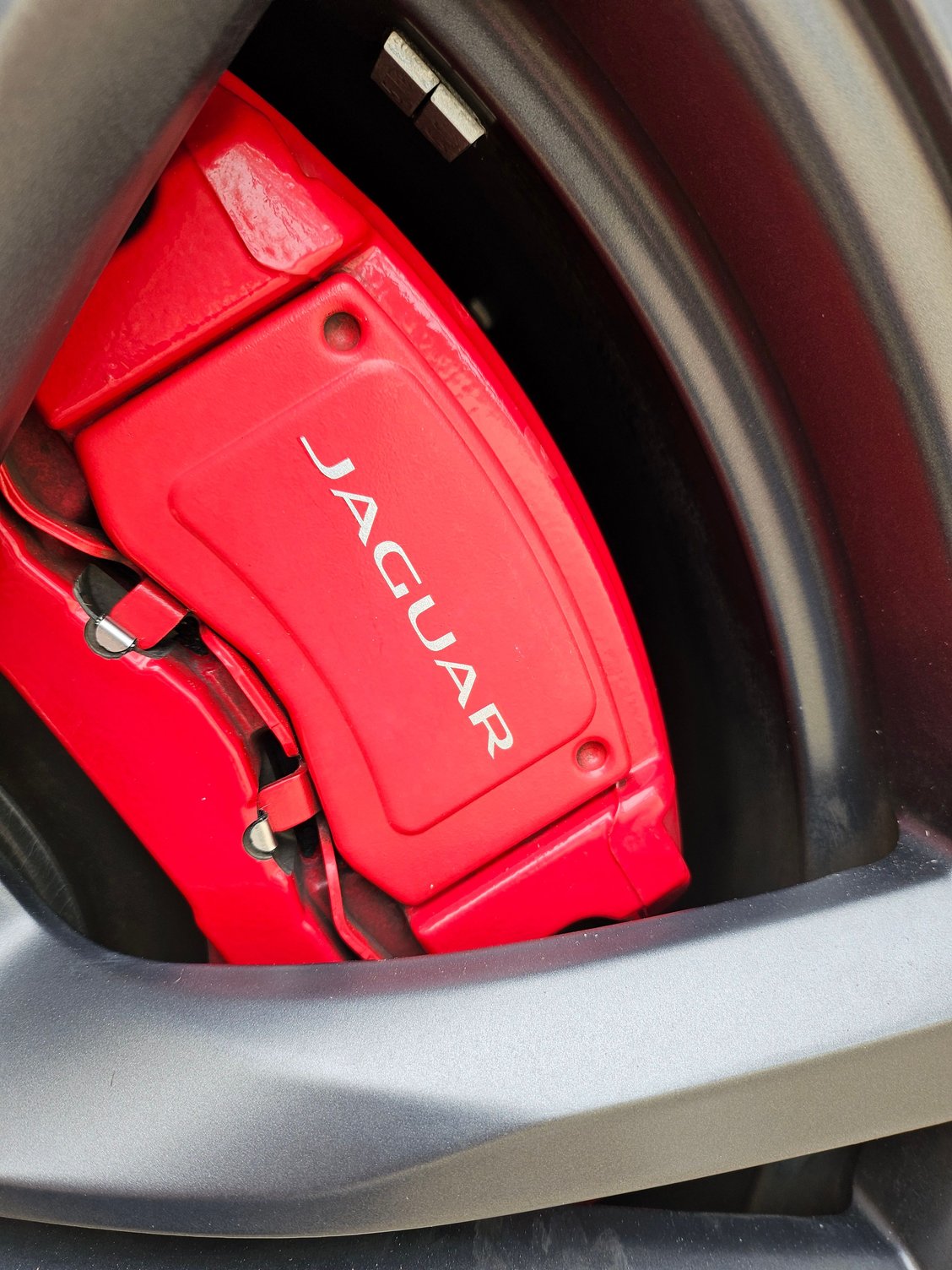

Here is the after:

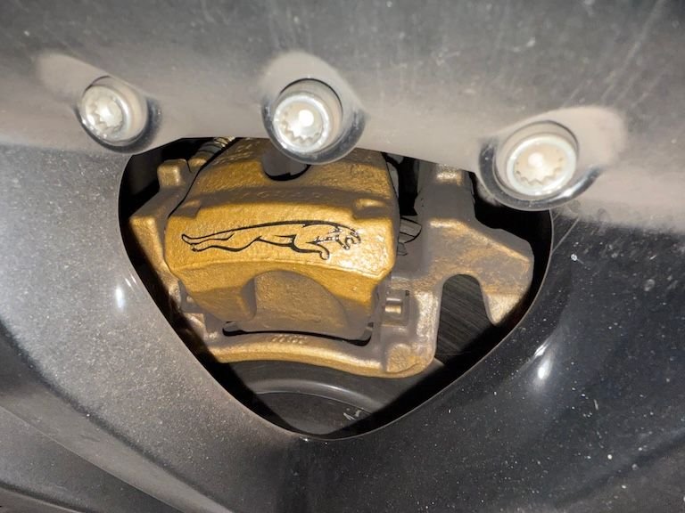

@eeeeek Thanks for the great info. So much easier than applying to freshly painted calipers (one chance to get it right) and then spraying clear coat several times.
I ended up painting my calipers gold and using 2 black decals from eBay that had the leaper on top of the lettering.
Problem was there wasn't enough room on that front plate for both the leaper and the letters so I had to cut it in half - the leaper just fit on the rear calipers and the lettering on the front as you have. Time for new brake pads and fluid so I will be doing a caliper refresh soon.

The leaper barely fits but adds some needed character to the rear caliper:
