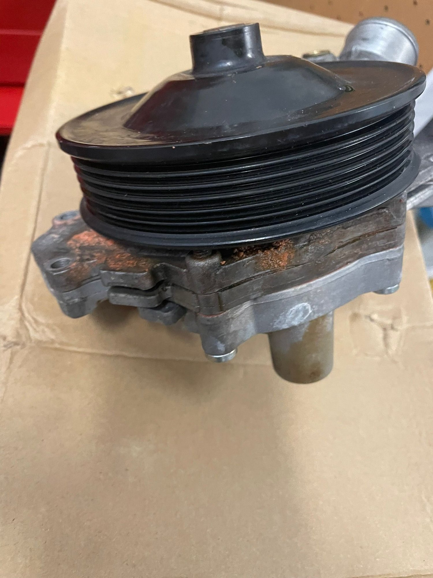

Quote: No opinion on that, but I’ll mention that when my dealer replaced the original seamed plastic pipes with seamless plastic (way back in 2020), they found the water pump was weeping a bit so they replaced that too.
This was our OEM water pump. Nothing ever dripped on the ground, but every month or so we needed to add coolant.
We got the EuroAMP kit that included the water pump.. No issues 2 years later...hasn't lost a drop!
FWIW The kit we got had the wrong thermostat hsg, so our indie installer sold us a new JLR plastic one.
